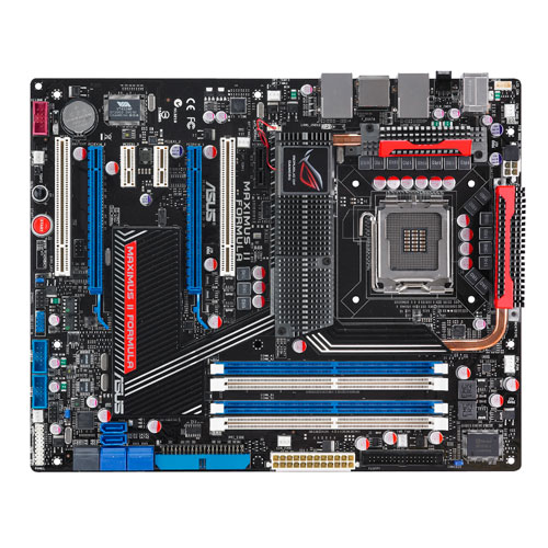

I was going to get the ramplex but i dont think it will fit between 2x ddr2 sticks in the blue slots on my asus maximus II formula mobo, theres a small gap between the pairs of slots.
Can you confirm or deny?
Dienstag, 21. September 2010, 13:46
One ramplex will not work here. If you want to cool the RAM you will need two blocks.
