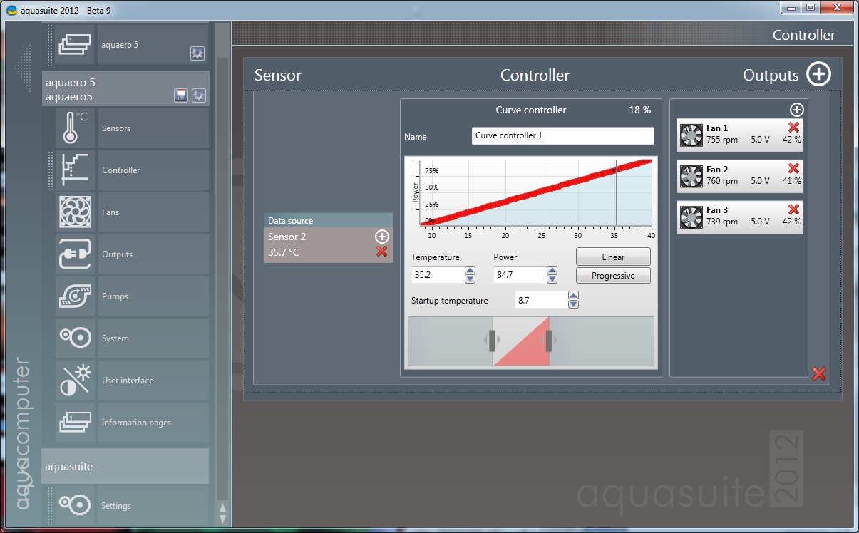

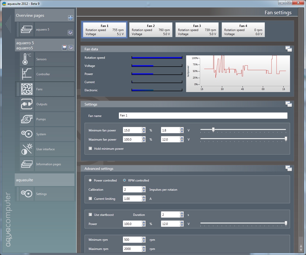

Hello,
Now that the aquasuite is reading the data I can't seem to control the fans.
I tried to control from temp sensor input using linear and curved method, but the fans don't adjust in speed. I also tried Power Controlled and RPM Controlled for the fan settings.
The fan section does adjust and change the fan speeds, when I change things manually, but either I'm missing something or something is not working correctly.
I've attached to images:
-fans.jpg - How the fans are configured.
-fancontroller.jpg - How the controller is set.
Any help would be appreciated.
Thanks,
Attila

Dienstag, 15. November 2011, 15:31
Should work...
Your temperature range looks a bit uncommon for such a setup. I would set the curve between 25° and 40°C. Maybe your current range is too large so you see no real difference in fan speeds.
