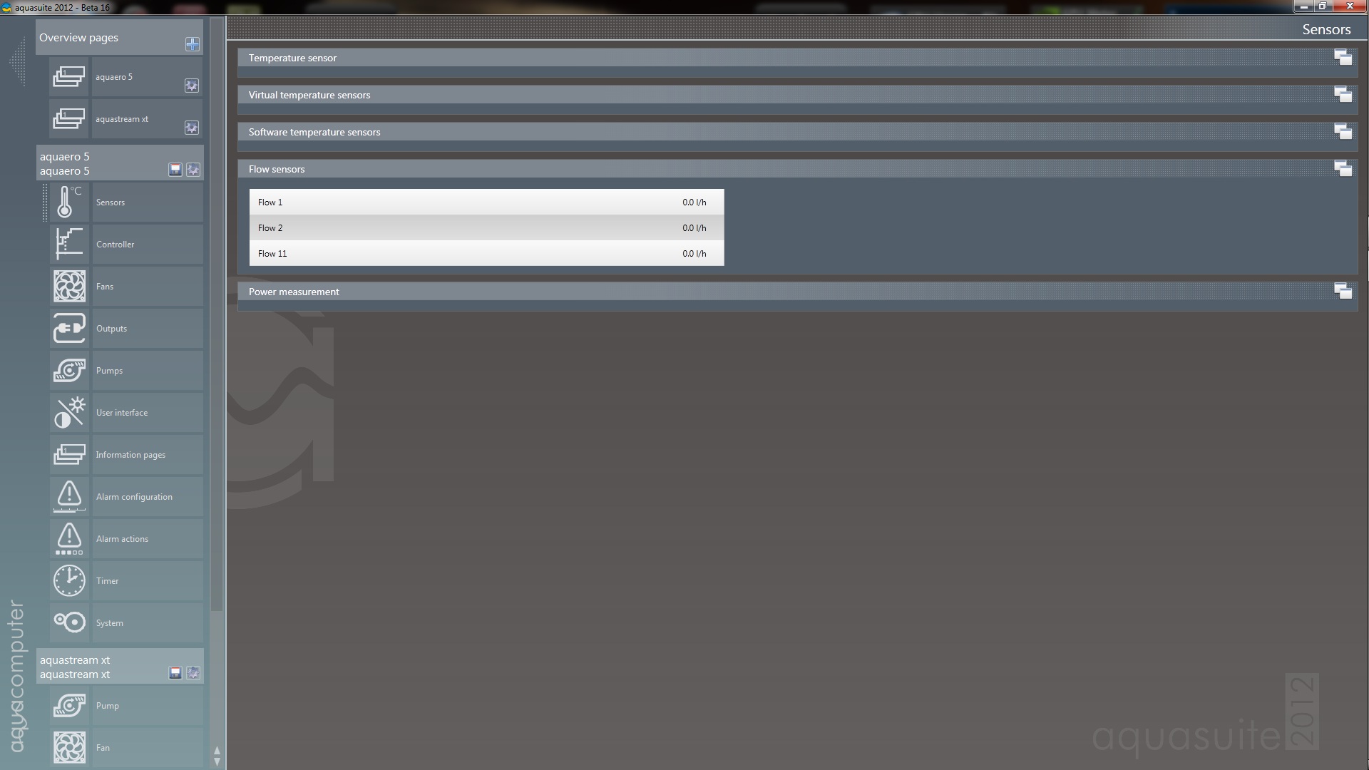

i did what u said but on all 3 flow sensors that are in the information page dont show nothing could my flow sensor be messed up or something else that i need to do,it has never showed nothing since i got it ,just until i hooked the 3pin sensor alarm to the 3 pin flow on the aquaero 5 xt.lol does it matter the way my flow sensor is hooked or the way the flow of the water i thought on this flow sensor i have it didn't. my flow sensor is water in from the left out the right side where u can read everythin on it .

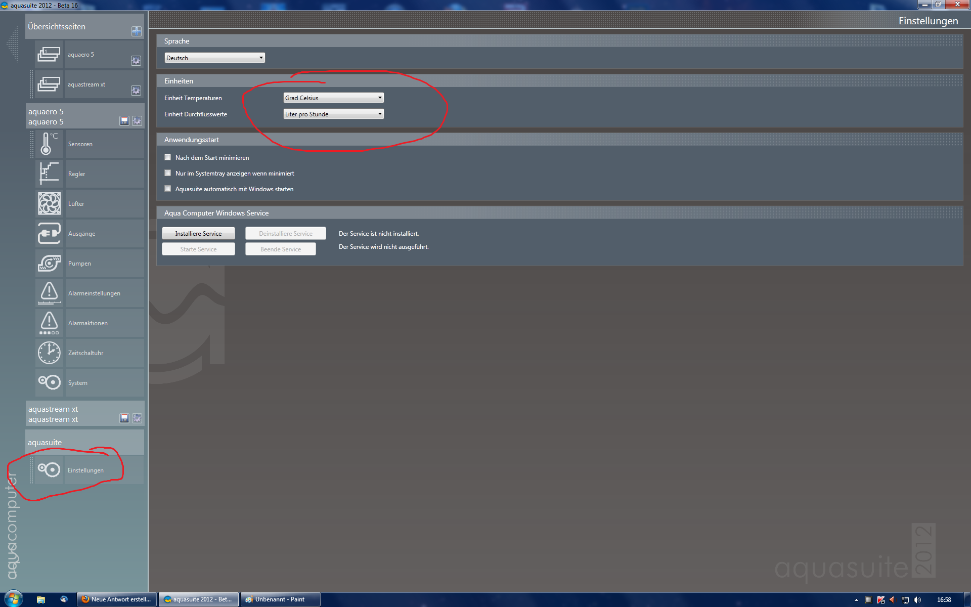

Samstag, 27. Oktober 2012, 17:05
3 flow sensors is a good sign (1-2 AE5, 3 MPS), try to change from gal/min to gal/h

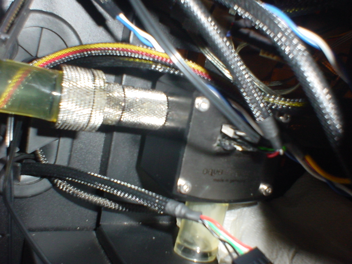

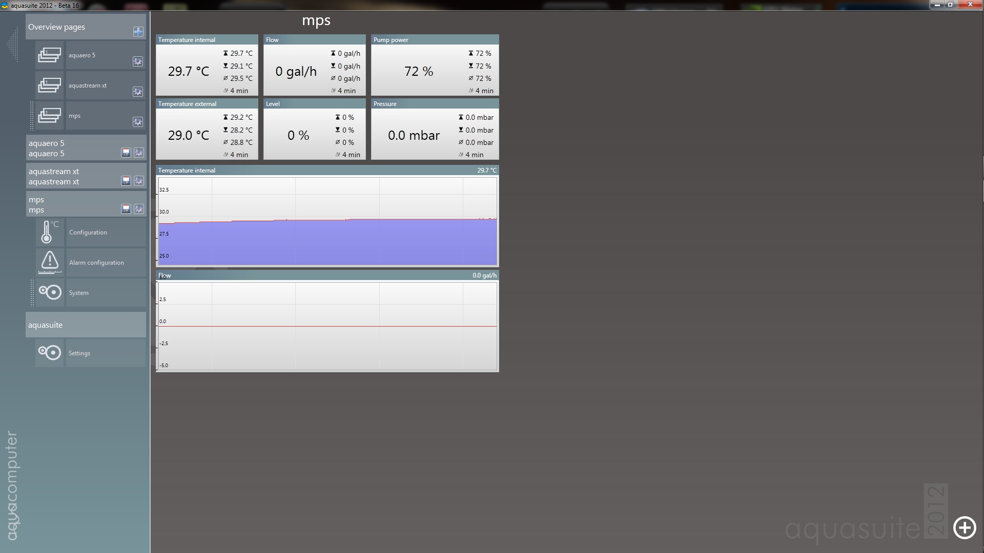

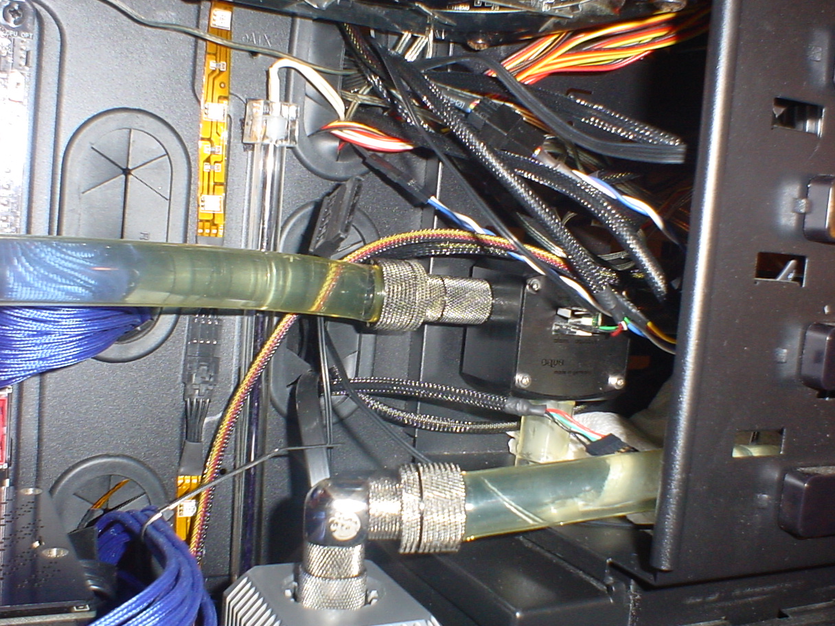

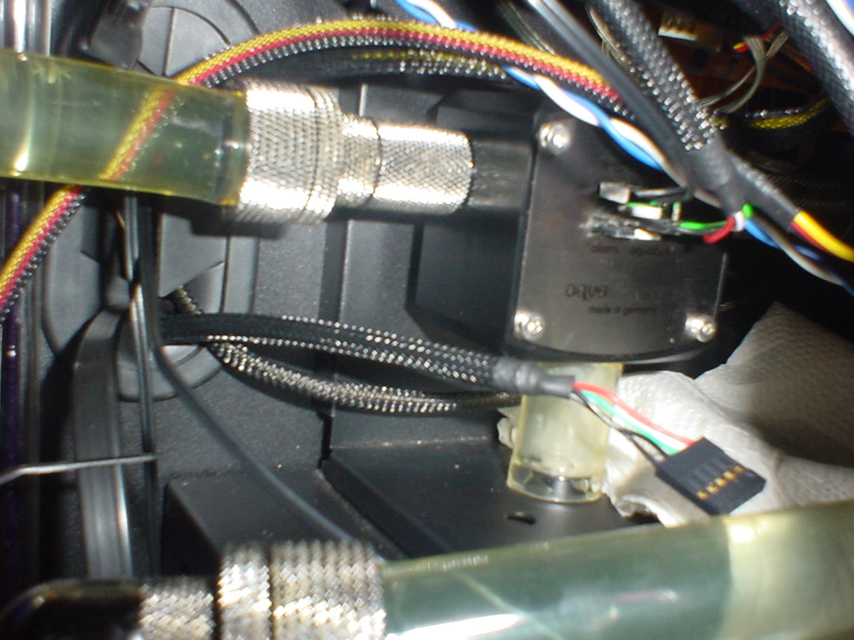

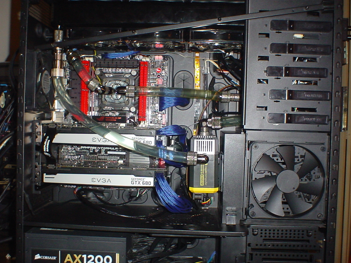

this is without the usb hooked up i dont know if this will help i still dont get a flow.i just took apart everything and put it back together just to see if the flow sensor was working .it is well it spins do i have this going the right way.ohh and will this hurt the pump being this way.is there something i am not hooking up the right way. now i have it hooked up to usb and i get nothing,i even hooked it up all by itself and nothing.now on the picture 18 there how come my aquastrean xt pump dont show anything on there looks like its a broken feed ..lol i tried to get a pic of it hope u can make out.need all the help i can get.

The High flow USB works fine in any orientation and in/out connections.

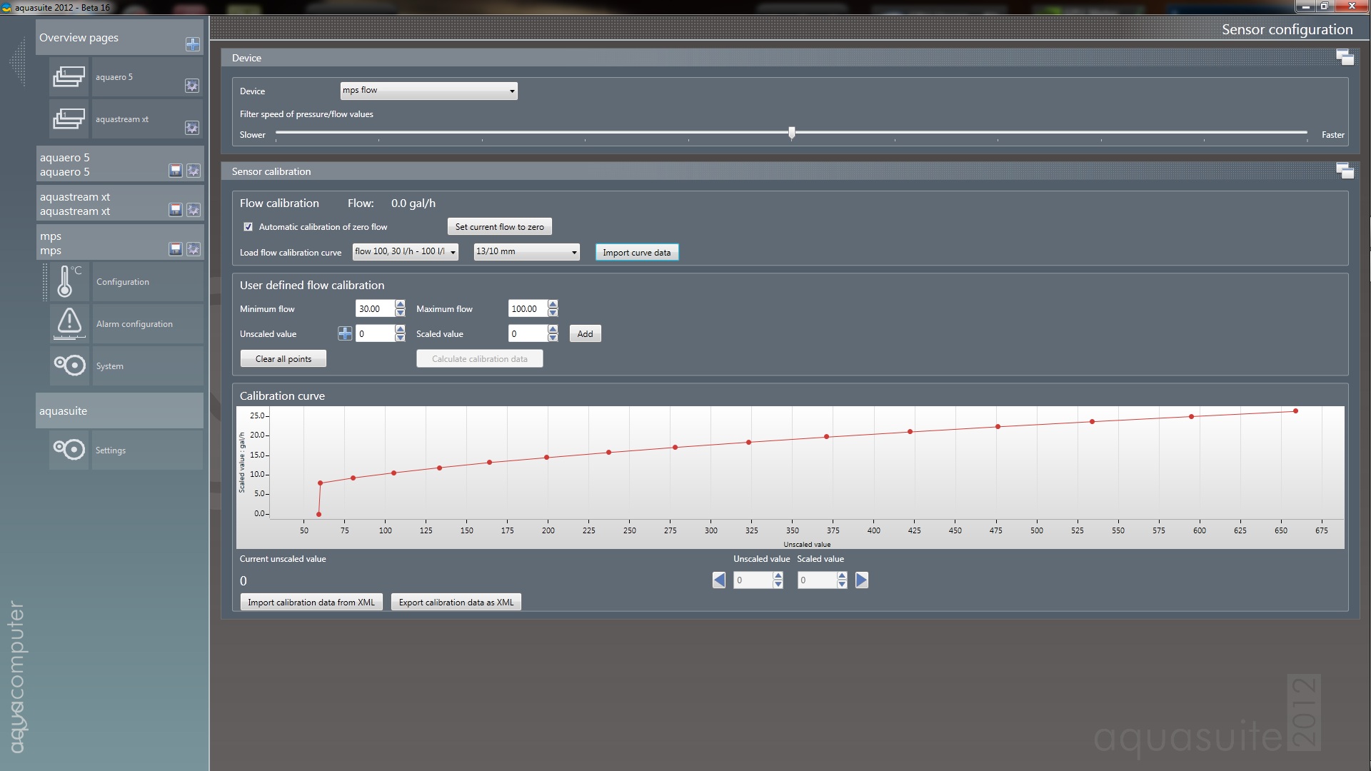

On the page "mps/Configuration/device" you have the wrong flow sensor selected. Click on the scroll bar next to Device and scroll to the bottom and select "Flow Sensor High Flow USB"
You will not hurt the pump unless you run it in a dry condition, and the flow sensor is almost bullit proof.
Most likely place for damage is a broken wire in one of the cables.
As far as I can tell from the pictures, I think you are almost there.

thanks alot i have now 205.2 l/h me ripping apart my computer to check to see if the flow sensor was working and it was just a setting..lol would u happen to know why my pump wont show up on the srceen like the 50 or 60 hz u know .thanka alot again. this is my first watercooled build like this i did do the corsair h 80 thing.
