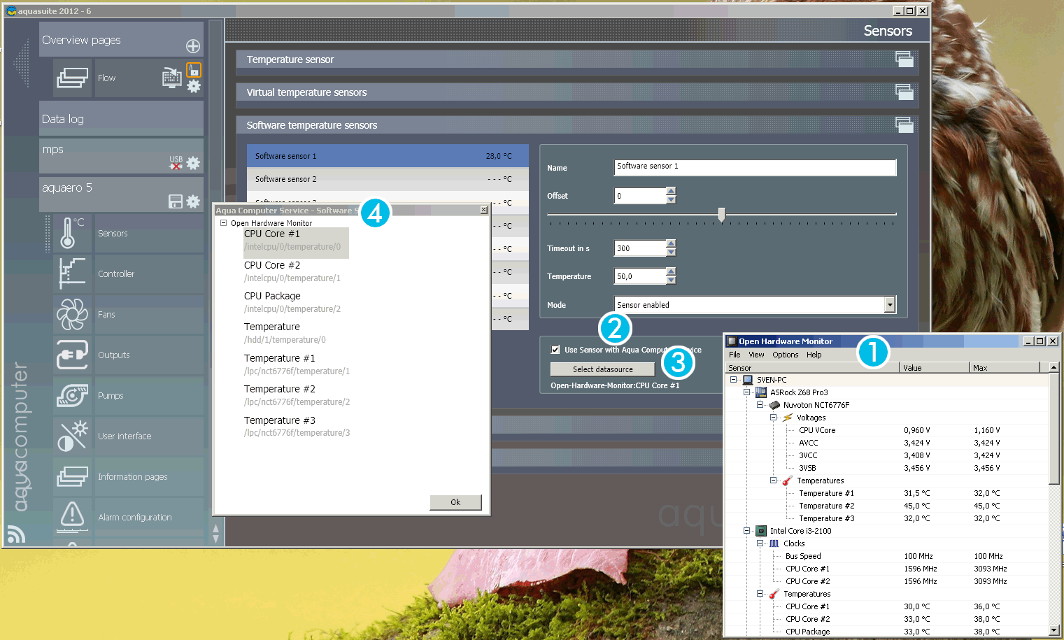

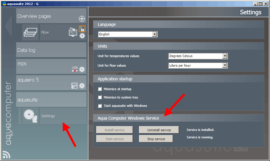

Freitag, 21. Dezember 2012, 13:13
Make sure that you have installed the Windows service and that it is running.
1.) Get Open Hardware Monitor Beta 0.5.1 and start it.
2.) Enable the software sensor in the aquasuite 2012 so you can use it.
3.) Click the button to select a data source.
4.) A new window will appear where you can select the temperature sensors from Open Hardware Monitor.
