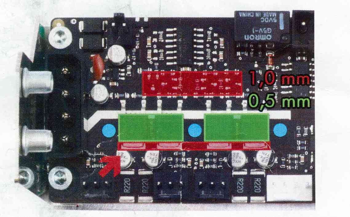

Hi All
Does someone knows the thickness of the thermal pads on "Aquareo 5 Waterblock"
Should I use thermal paste instead of the thermal pad ???
I am re installing mine :S
Tank You all in advance

Unless someone responds that knows, I would just contact Aquacomputer support for the thermal pad thickness. I've found them very responsive in the past. I personally would not use TIM, especially not any that is electrically conductive.
thickskull
Dienstag, 12. Februar 2013, 04:34
I have some of the thermal pad leftover from just installing my waterblock and it looks alittle less than 1mm, I only have a plastic ruler to go by so my % error could be on the hi side.

Does this help?

Thank's a hole lot
The jpeg was what I was looking for
I saw it some time ago.
Thank you all
