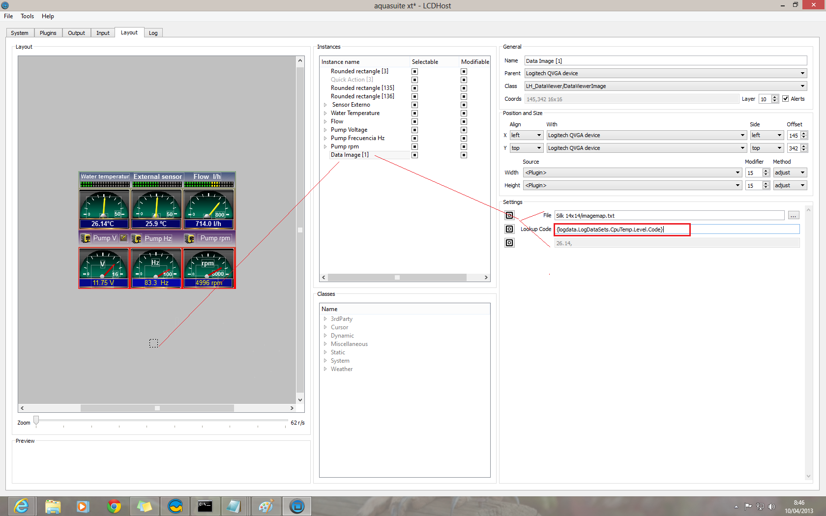

this is what I get. after restart. lcdhost
this is the test
»novax1« hat folgendes Bild angehängt:

You dont need to put the list temp data into the imagemap file.. the default file should work but you may need to add a missing shortcode in the imagemap. Just checked there is nothing missing in your imagemap but you need to delete the list data section incuding [Format] and below.
Dieser Beitrag wurde bereits 1 mal editiert, zuletzt von »Phatboy69« (10. April 2013, 08:26)

Just use this imagemap file as is. dont change it and everything should just work!

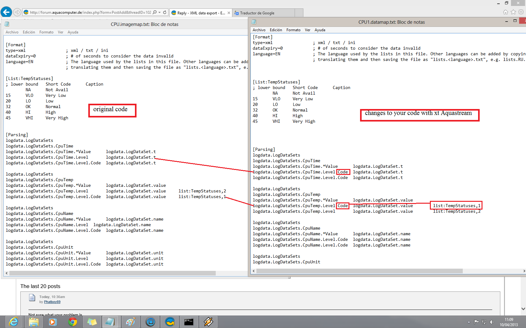

This [List:TempStatuses] section and the 2 entries list:TempStatuses,2 & list:TempStatuses,1 need to be put into the datamap file your already using to collect Aquasuite sensor data.
These sections are new to enable the lookup of status codes.
Here is my datamap file with the changes I made to enable the lookup table. (list)

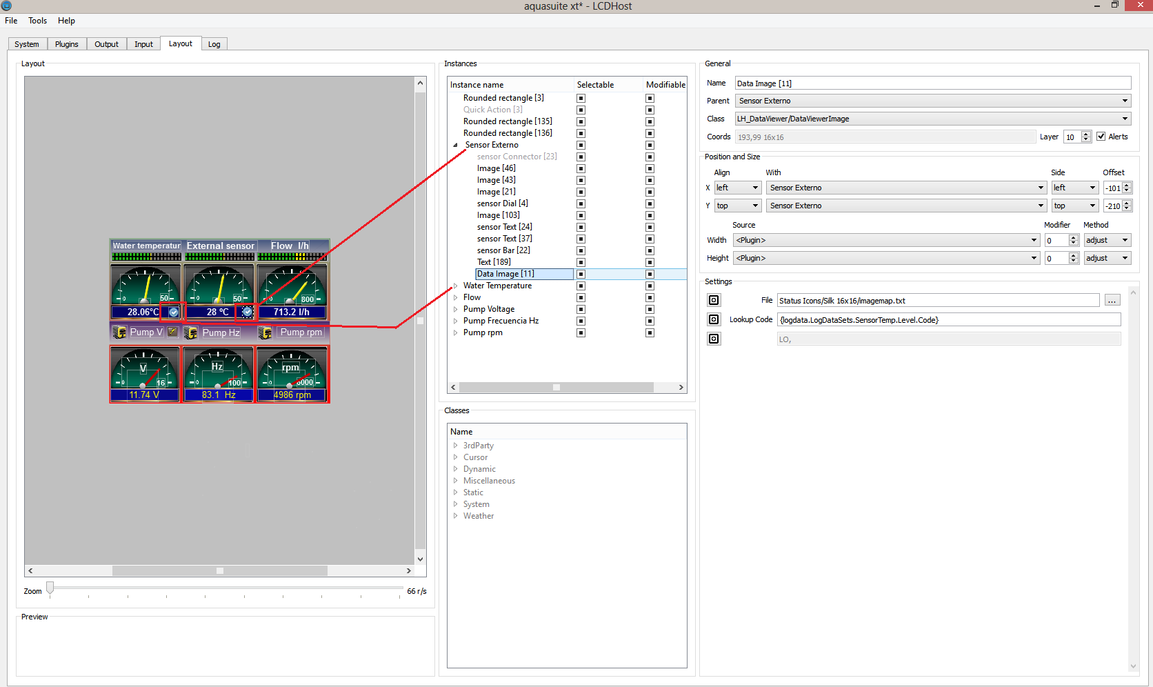

no. I'll be doing it wrong but still can show

Not sure what your problem is....
Its picking up the right value for logdata.LogDataSets.CpuTemp.Level.Code logdata.LogDataSet.value list:TempStatuses,1
The value is working in the lookup table. Maybe check you have tab delimted the columns in the [List:TempStatuses] section and in your imagemap file also make sure the columns are tab delimited. (ie delete the space between each value on each row and the press tab between each value to create the delimit)
Also make sure you have the right paths set and that the imagemap file is in the same directory as the images. other than this you'll have to trouble shoot it on your own sorry!

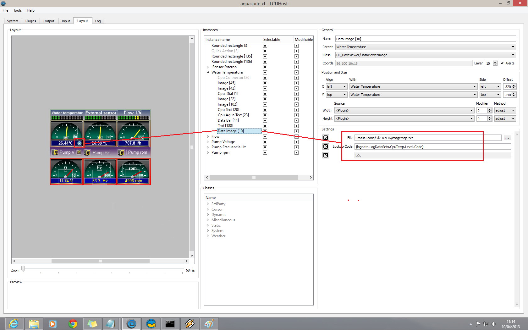

Solved. Cpu temp I changed the code to Aquastream xt. as I show.
but I can not configure the other.
External Sensor and Fan Rpm
thank you very much
»novax1« hat folgende Bilder angehängt:
Dieser Beitrag wurde bereits 1 mal editiert, zuletzt von »novax1« (10. April 2013, 12:43)

You need to add the same list:TempStatuses,1 and list:TempStatuses,2 to the lines in the datamap file for your external sensor and fan rpm and also the [List:TempStatuses] section at the top of each datamap file.
Dieser Beitrag wurde bereits 1 mal editiert, zuletzt von »Phatboy69« (10. April 2013, 13:18)

[Format]
type=xml		; xml / txt / ini
dataExpiry=0		; # of seconds to consider the data invalid
language=EN		; The language used by the lists in this file. Other languages can be added by copying the lists to a new text file,
			; translating them and then saving the file as "lists.<language>.txt", e.g. lists.RU.txt
[List:TempStatuses]
; lower bound	Short Code	Caption
	NA	Not Avail
3500	VLO	Very Low
4000	LO	Low
4200	OK	Normal
4500	HI	High
5000	VHI	Very High
[Parsing]
logdata.LogDataSets
logdata.LogDataSets.CpuPump1Time
logdata.LogDataSets.CpuPump1Time.*Value	logdata.LogDataSet.t
logdata.LogDataSets.CpuPump1Time.Level	logdata.LogDataSet.t
logdata.LogDataSets.CpuPump1Time.Level.Code	logdata.LogDataSet.t
logdata.LogDataSets
logdata.LogDataSets.CpuPump1RPM
logdata.LogDataSets.CpuPump1RPM.*Value	logdata.LogDataSet.value
logdata.LogDataSets.CpuPump1RPM.Level	logdata.LogDataSet.value	list:TempStatuses,2
logdata.LogDataSets.CpuPump1RPM.Level.Code	logdata.LogDataSet.value	list:TempStatuses,1
logdata.LogDataSets
logdata.LogDataSets.CpuPump1Name
logdata.LogDataSets.CpuPump1Name.*Value	logdata.LogDataSet.name
logdata.LogDataSets.CpuPump1Name.Level	logdata.LogDataSet.name
logdata.LogDataSets.CpuPump1Name.Level.Code	logdata.LogDataSet.name
logdata.LogDataSets
logdata.LogDataSets.CpuPump1Unit
logdata.LogDataSets.CpuPump1Unit.*Value	logdata.LogDataSet.unit
logdata.LogDataSets.CpuPump1Unit.Level	logdata.LogDataSet.unit
logdata.LogDataSets.CpuPump1Unit.Level.Code	logdata.LogDataSet.unit
logdata.LogDataSets
logdata.LogDataSets.CpuPump1valueType
logdata.LogDataSets.CpuPump1valueType.*Value	logdata.LogDataSet.valueType
logdata.LogDataSets.CpuPump1valueType.Level	logdata.LogDataSet.valueType
logdata.LogDataSets.CpuPump1ValueType.Level.Code	logdata.LogDataSet.valueType
logdata.LogDataSets
logdata.LogDataSets.CpuPump1Device
logdata.LogDataSets.CpuPump1Device.*Value	logdata.LogDataSet.device
logdata.LogDataSets.CpuPump1Device.Level	logdata.LogDataSet.device
logdata.LogDataSets.CpuPump1Device.Level.Code	logdata.LogDataSet.device
Fan Datamap
Quellcode
1
2
3
4
5
6
7
8
9
10
11
12
13
14
15
16
17
18
19
20
21
22
23
24
25
26
27
28
29
30
31
32
33
34
35
36
37
38
39
40
41
42
43
44
45
46
47
48
49
50
51
52
[Format]
[List:TempStatuses]
	NA	Not Avail
400	VLO	Very Low
800	LO	Low
1000	OK	Normal
1400	HI	High
1700	VHI	Very High
[Parsing]
logdata.LogDataSets
logdata.LogDataSets.CPUFan4Time
logdata.LogDataSets.CPUFan4Time.*Value	logdata.LogDataSet.t
logdata.LogDataSets.CPUFan4Time.Level	logdata.LogDataSet.t
logdata.LogDataSets.CPUFan4Time.Level.Code	logdata.LogDataSet.t
logdata.LogDataSets
logdata.LogDataSets.CPUFan4Speed
logdata.LogDataSets.CPUFan4Speed.*Value	logdata.LogDataSet.value
logdata.LogDataSets.CPUFan4Speed.Level	logdata.LogDataSet.value	list:TempStatuses,2
logdata.LogDataSets.CPUFan4Speed.Level.Code	logdata.LogDataSet.value	list:TempStatuses,1
logdata.LogDataSets
logdata.LogDataSets.CPUFan4Name
logdata.LogDataSets.CPUFan4Name.*Value	logdata.LogDataSet.name
logdata.LogDataSets.CPUFan4Name.Level	logdata.LogDataSet.name
logdata.LogDataSets.CPUFan4Name.Level.Code	logdata.LogDataSet.name
logdata.LogDataSets
logdata.LogDataSets.CPUFan4Unit
logdata.LogDataSets.CPUFan4Unit.*Value	logdata.LogDataSet.unit
logdata.LogDataSets.CPUFan4Unit.Level	logdata.LogDataSet.unit
logdata.LogDataSets.CPUFan4Unit.Level.Code	logdata.LogDataSet.unit
logdata.LogDataSets
logdata.LogDataSets.CPUFan4valueType
logdata.LogDataSets.CPUFan4valueType.*Value	logdata.LogDataSet.valueType
logdata.LogDataSets.CPUFan4valueType.Level	logdata.LogDataSet.valueType
logdata.LogDataSets.CPUFan4ValueType.Level.Code	logdata.LogDataSet.valueType
logdata.LogDataSets
logdata.LogDataSets.CPUFan4Device
logdata.LogDataSets.CPUFan4Device.*Value	logdata.LogDataSet.device
logdata.LogDataSets.CPUFan4Device.Level	logdata.LogDataSet.device
logdata.LogDataSets.CPUFan4Device.Level.Code	logdata.LogDataSet.device

; The image map file instructs the SpeedFan Status Image on what image
; file should be displayed for what circumstance. The images listed
; need to be in the same folder.
; The format is as follows:
; <Code>	<Image File>
; Note that each item is seperated by a tab.
; You can miss out any of the codes below and the Status Image will
; try to adapt sensibly. Usually this results in removing a threshold,
; apart from in the case ok leaving out the OK code, in which case no
; icon will be displayed whilst within the desired range.
NA	0_NA.png	; Icon for when data is unavailable
VLO	1_low.png	; Icon for when Value < Very Low
LO	2_good_low.png	; Icon for when Value < Low
OK	3_good.png	; Icon for when Low <= Value < High
HI	4_warning.png	; Icon for when Value >= High
VHI	5_danger.png	; Icon for when Value >= Very Low
