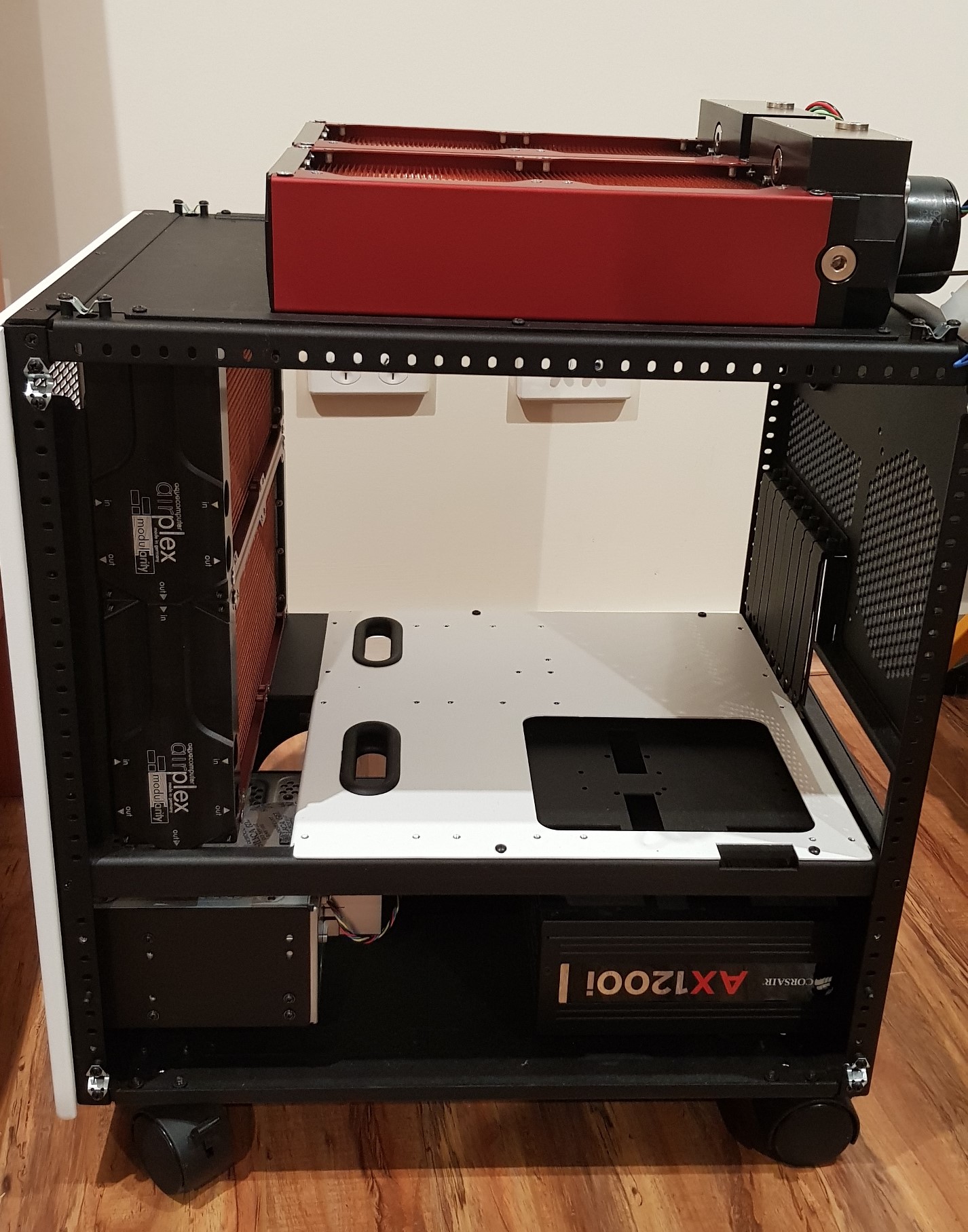

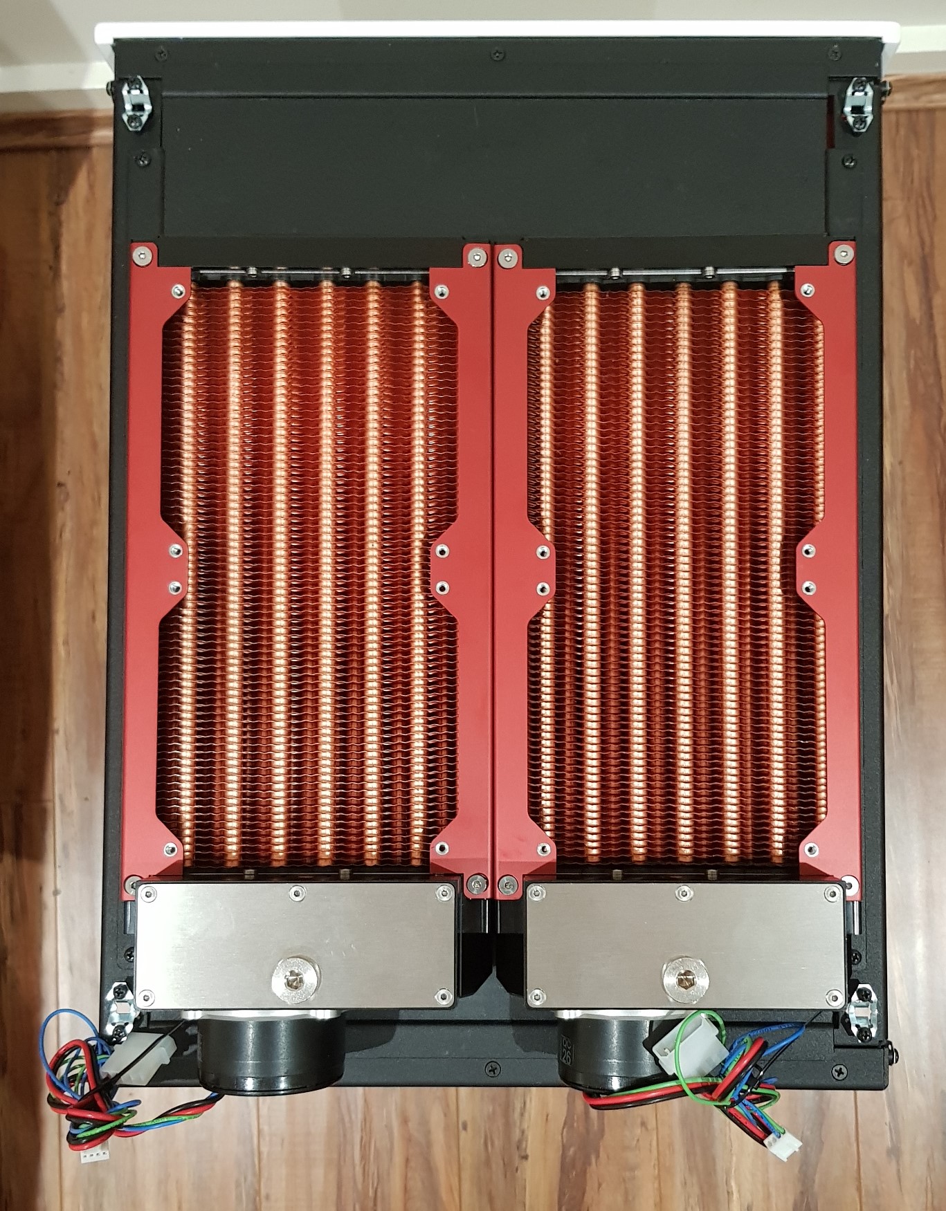

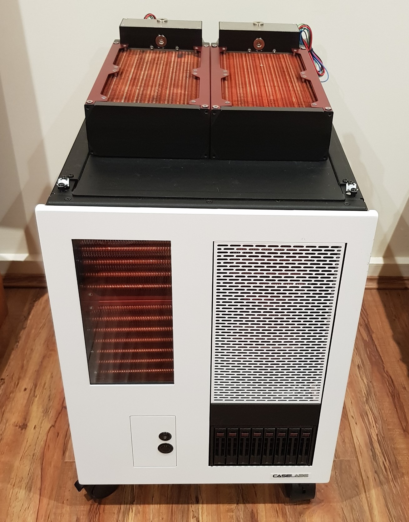

AIRPLEX Modularity....now maybe I should go a D5 NEXT pump replacements on my existing RADS.? ..... 8)
(Not for the RGB!, but for the integrated functions to reduce additional components)
»4WDBenio« hat folgende Dateien angehängt:

Samstag, 12. Oktober 2019, 15:35
I considered the exact same scenario, two D5 NEXT vs. two D5 PWM with an aquaero.
The two D5 Next would do most everything I wanted for a stand-alone external radiator, except ONLY the aquaero has virtual sensors, so I went with the D5 PWMs & aquaero. If you don't need virtual sensors, just tally what the D5 NEXT can do and compare.

Sonntag, 13. Oktober 2019, 03:00
Seeker, how are your rads connected to each other? Couldn't find the image that shows them connected via serial or what have you. It almost looks like each rad is individually used.
Also what black noctua fans are those and is that a filter in the front? I'm going on the assumption you're using pull.
Sorry for all the questions as curiosity got the best me of. :D
Dieser Beitrag wurde bereits 2 mal editiert, zuletzt von »GTXJackBauer« (13. Oktober 2019, 03:02)

That is the airplex modularity system using two side connectors for coolant connectivity and two Set of interconnection plates to bolt them together.
The fans are NF-A14 industrialPPC-2000 IP67 PWM, with black corners for bling.
The filter is a custom DEMCiflex I ordered. I punched holes to match the radiator fan mount pattern.
I did use pull, for aesthetics I wanted the filter on front and fans on back.
Being pull I had to seal the system so it could not short circuit around the fans, and I also wanted to add a small plenum to improve efficiency.
