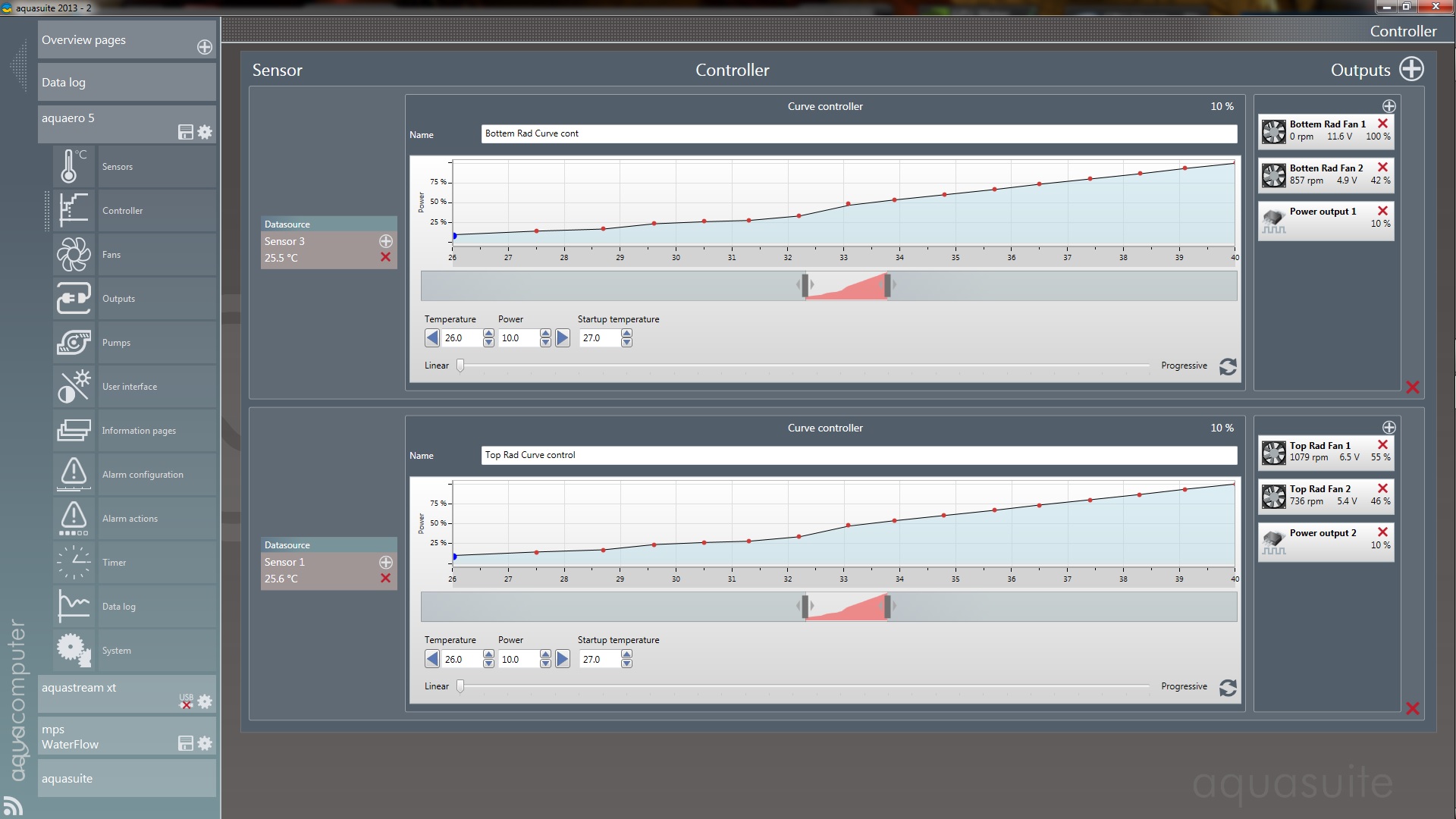

Sonntag, 4. August 2013, 08:56
i have 4 fans hooked to my aq5, they will start off good but then they will go full speed and then will shut completley off. aquasuite says they are 100% with no rmp.
»pegleg« hat folgendes Bild angehängt:
Scott-S6
Sonntag, 4. August 2013, 09:29
It looks like you're pushing the power too low. Go into the fans tab and find the lowest setting that keeps them running - set that as the minimum. Most fans won't go below 35% power.

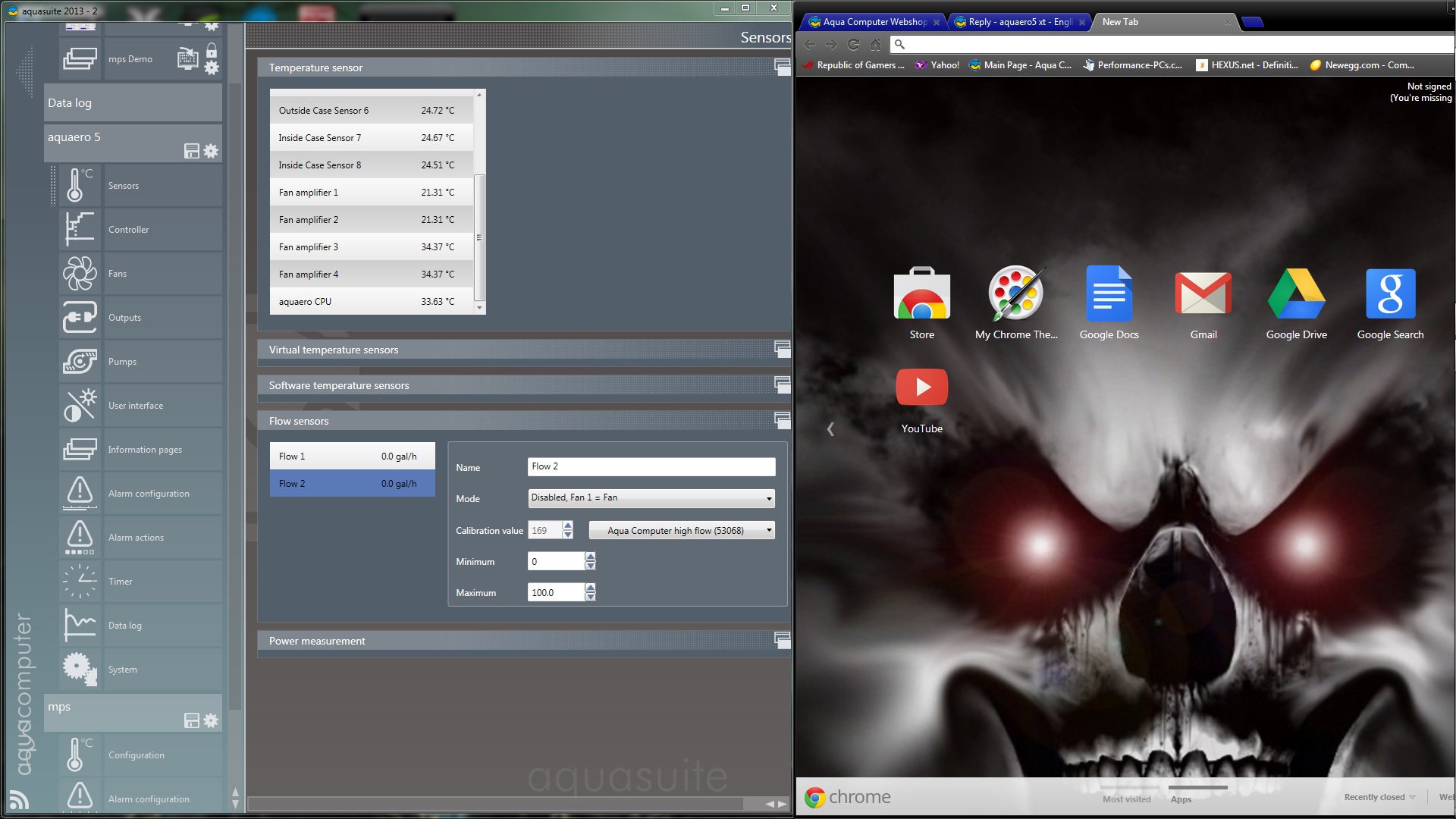

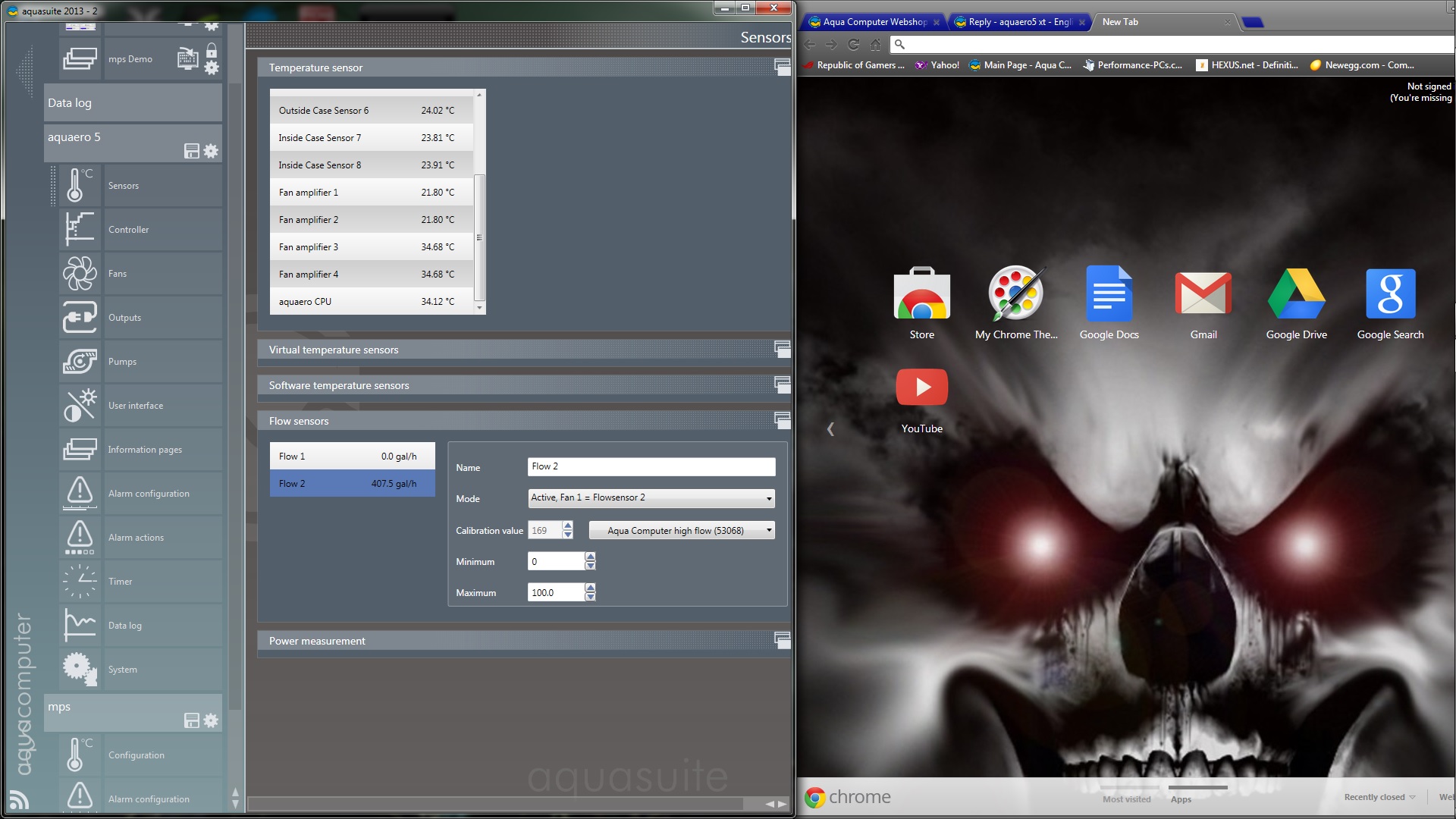

i dont have no fan connected to the flow meter(this is the one i have ...http://shop.aquacomputer.de/product_info…roducts_id=2897) when i click what i said above it will turn fans full blast then will show flow but only when i clcik the one setting
pegleg
Samstag, 10. August 2013, 09:08
see first pic nothing but when click the active fan 1 it will kick on the fans on channel 1 how do i get it not to kick them fans on and show the flow in a5 screen and in the aquasuite.it has flow on mps last page but how do i get it to show up on screen or software

Flow 1 and Flow 2 have nothing to do with the USB high flow or MPS pressure based flow sensors, they are only for the non USB flow sensor connected to the "flow" port and fan header 1
To get a USB flow meter to show in the Aquaero tab I'm pretty sure it needs to be connected via Aquabus to the Aquabus high port and have the priority switched to Aquabus.
The Flow meter works as you have it set, and you can add a flow guage or graph to an overview page in Aquasuite because it is connected via USB ... but to see it in the Aquaero tab it needs to be able to talk directly to the Aquaero, hence the Aquabus connection.
The High flow USB sensor should show up as flow 11

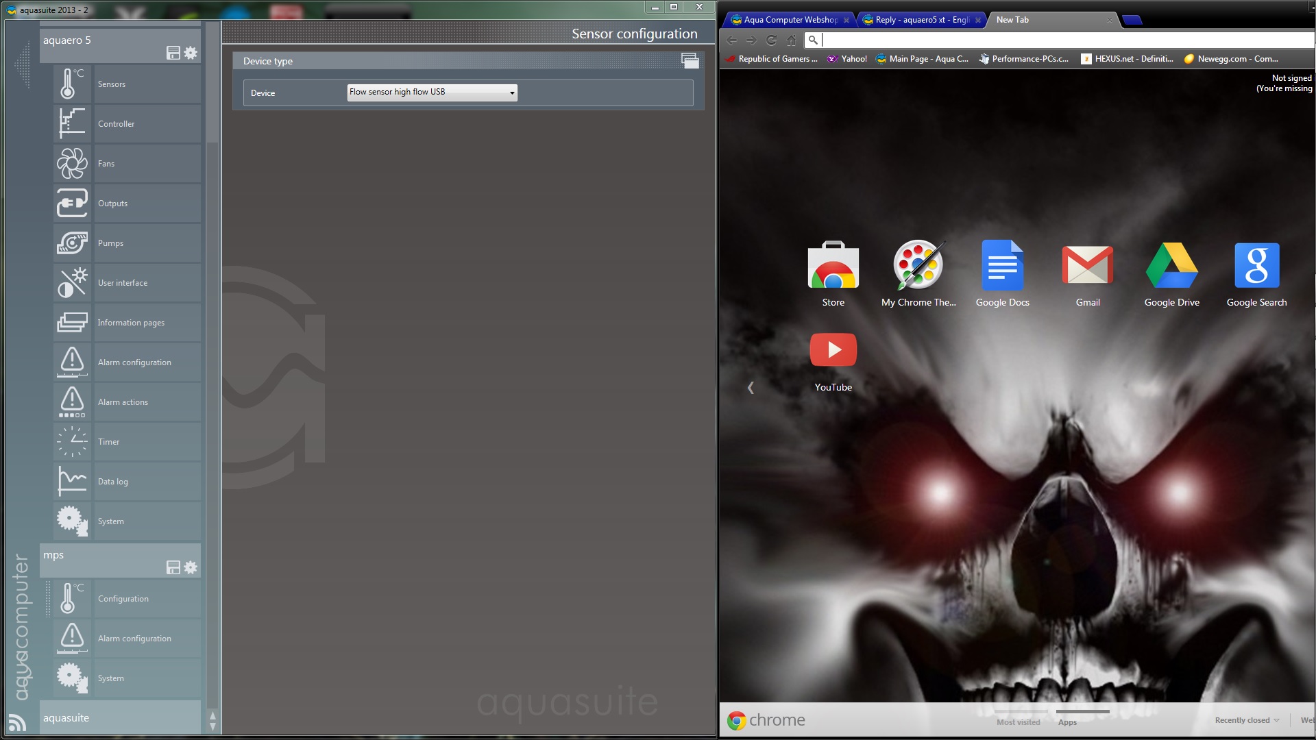

Sonntag, 18. August 2013, 15:25
i had it all working before i redid it,because got new case and did the tubing again with the acrylic tubing,i have it hooked to the a5 high flow my pump is on there too pump shows up but not the flow usb.i have tried swapping out wires and all,it will not show flow 11 under flow sensors,could my aquaero5 be messed up?can i reset the flow meter ?
