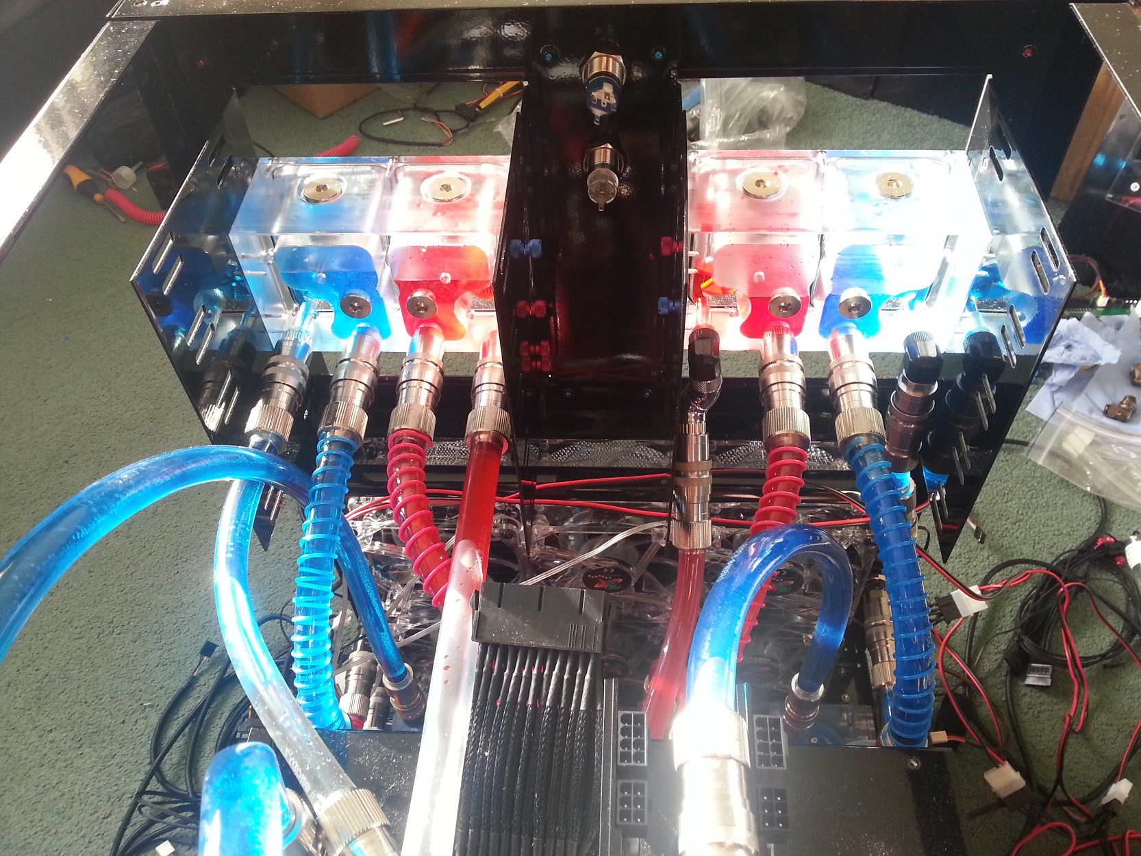

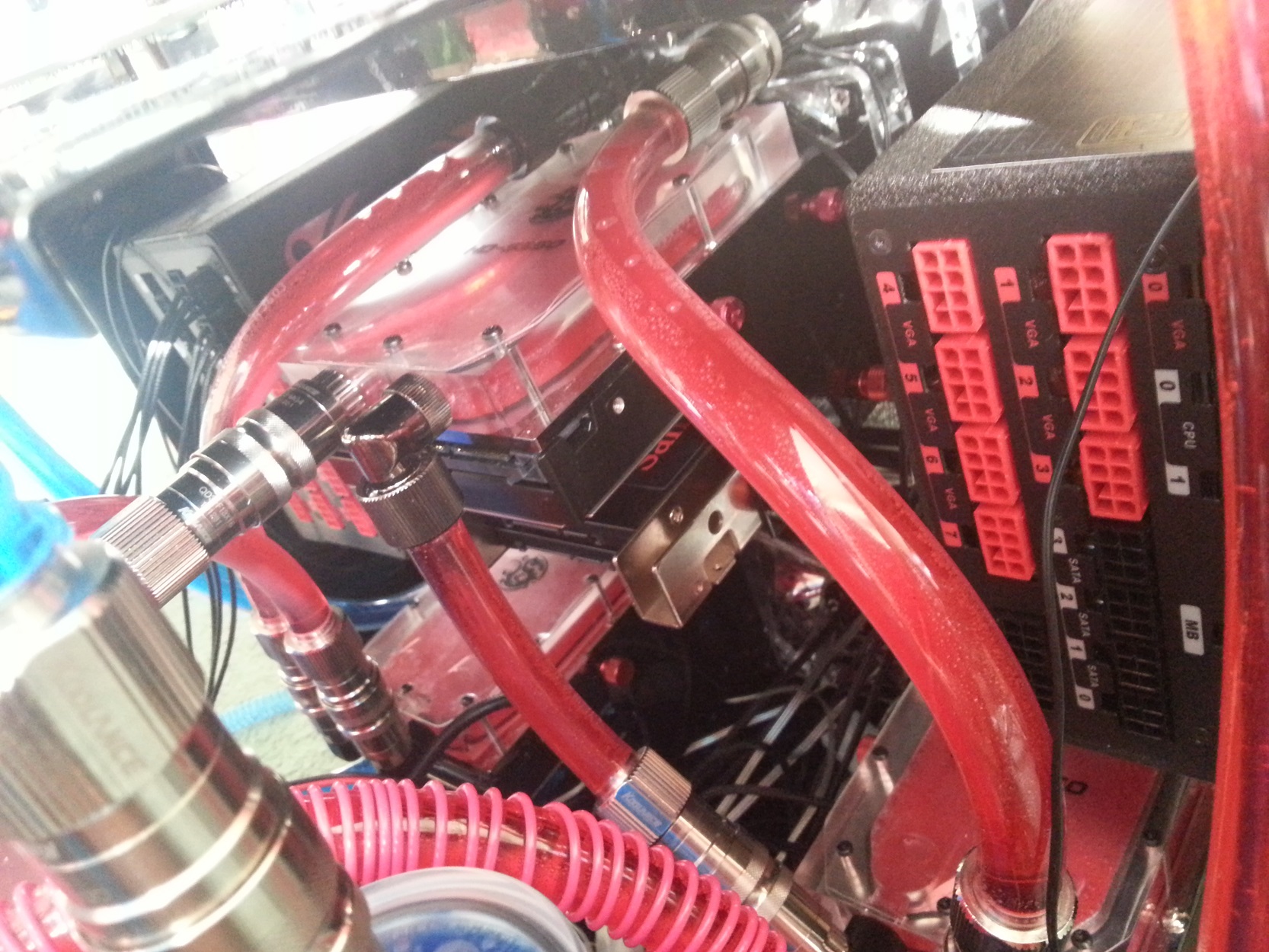

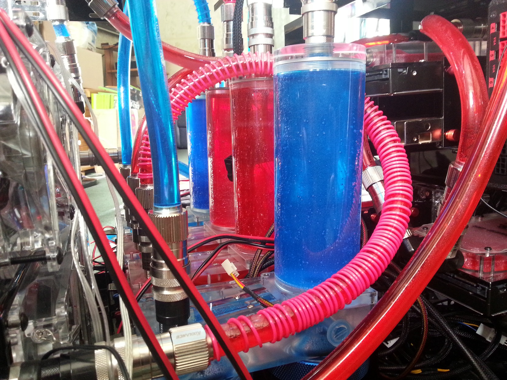

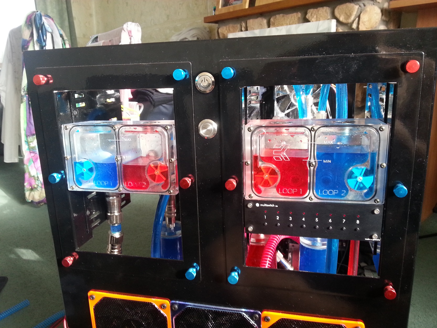

So I've finally got my system together and it's leak tested. Now it's time to connect all my monitoring goodies to my motherboard.
Problem is, the lack of usb ports available on my motherboard.
I need to connect 8 aquabus pumps and 2 aquaero as individual units but I only have 2 ports available.
Am I right in thinking that I only need to connect the pumps once for a device name and then I can connect them to just the aquaero's freeing up 2 ports for the actual aquaero's?
Has anyone done this before?
The only reason I'm using 2 aquaero's is so I can connect my pumps.
Granted it's overkill, but check the pics as it looks fantastic :-)

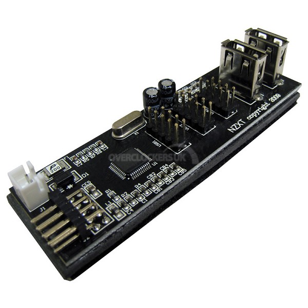

http://shop.aquacomputer.de/product_info…roducts_id=2422
that should fix your problem

Love the NZXT usb internal header you sent me.
Wondering how many of those I can use. Each has 3 available ports, I have 3 motherboard headers I could plug a unit into. That would give me 9 ports in total, I need 11.
Could I daisy chain those NZXT units or am I pushing my luck??

I have the same NZXT USB Hubs and where your right in saying they have three Internal USB ports... remember Each port consist of 2 USB connections.. Therefore each unit has in fact 6 Internal USB connections & 2 external connections to use. So 2 x NZXT USB Hubs infact give you 12 Internal USB's & 4 x External USB's.. :)

Each of my D5 aquabus pumps has a 5 pin usb header.
Are you saying I could attatch 2 of those to one 9 pin usb header on the nzxt? Is that how I attatch 6 per nzxt device?
The 5 pins on the D5's has 2 black wires, are they both the same and both needed?
I'm not sure how to connect 8 pumps to 2 of these nzxt units.
Thanks Namron. You are a legend on here :-)
appel
Freitag, 22. November 2013, 23:06
the 2nd black wire is not needed.
the reason the motherboard has 9 pins, is so you cant plug it wrong.
so yes. you can connect the 2nd pumpt usb on the 4pin as if it has 5 pins

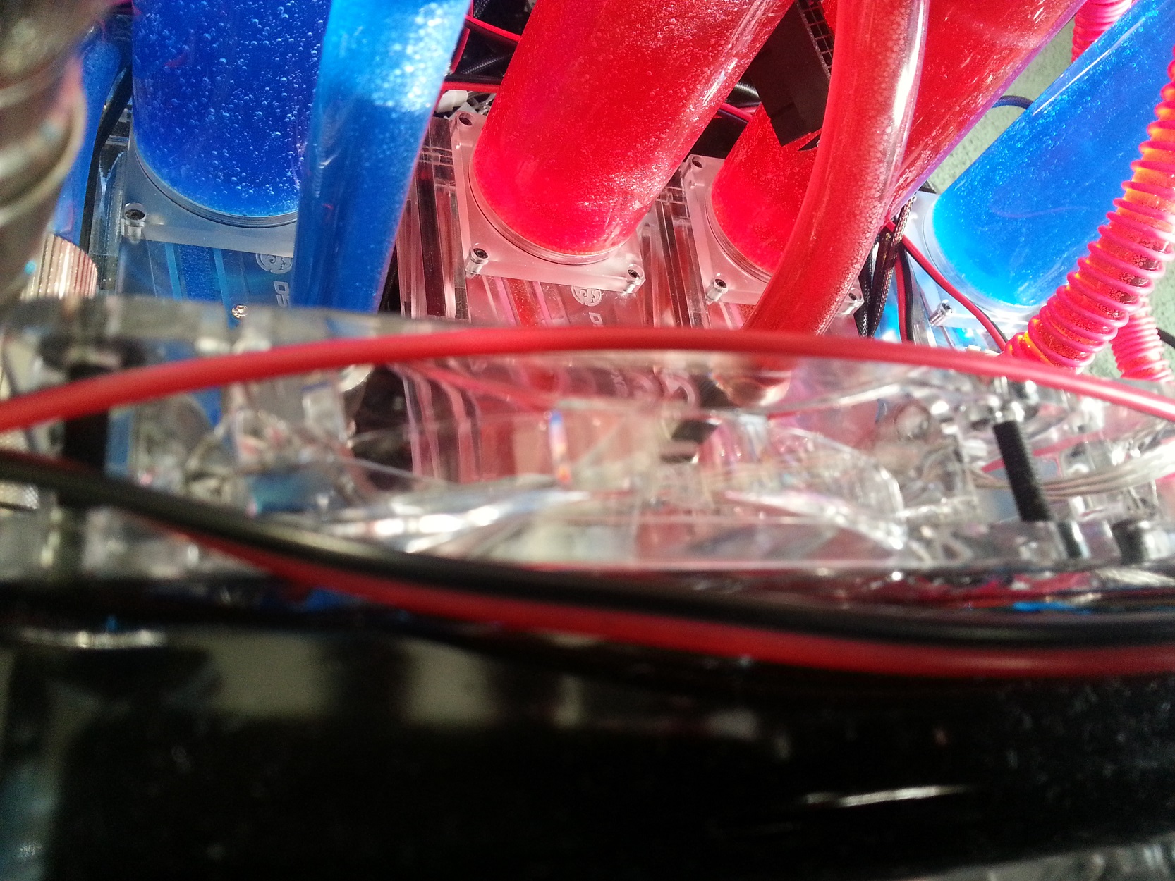

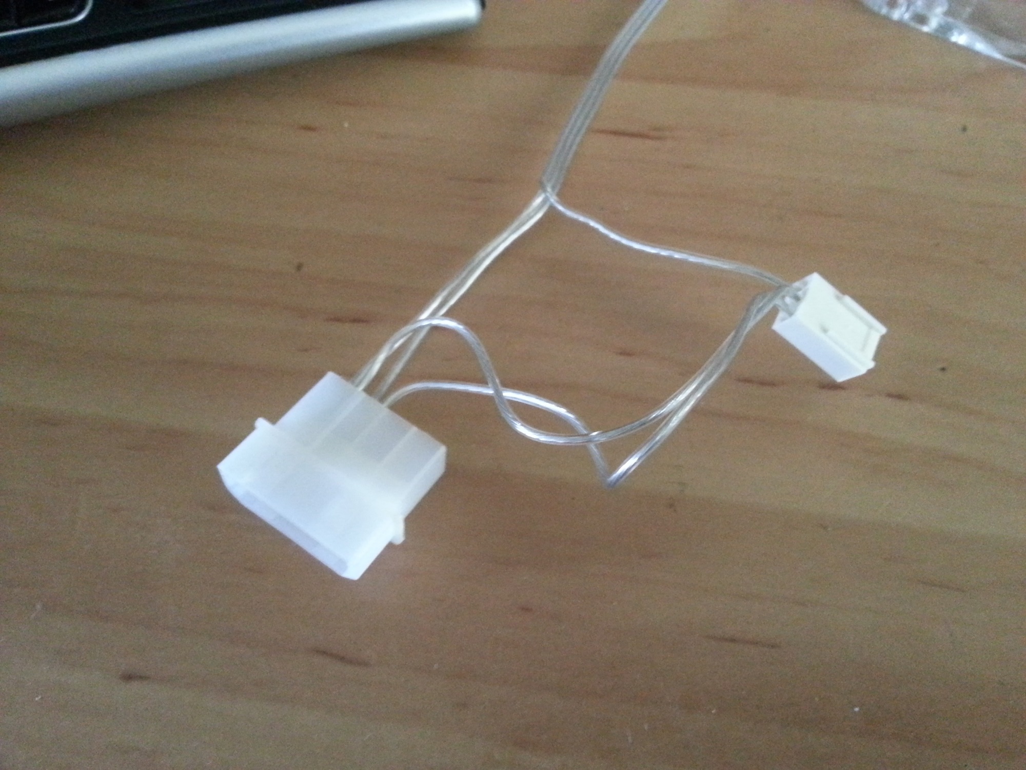

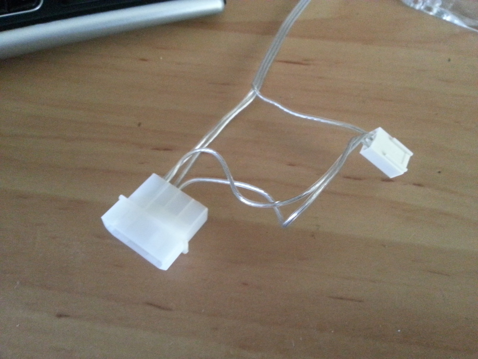

I'm connecting each fan to my psu for power and connecting what I believe is the pwm function to a 3-1 cable and then to the aquaero.
I've enclosed pics of my fan connections
Will this work? Can I get 3 fans per channel using this method?
Thanks again for everyone's help. I'm almost ready to connect the fans and poweradjusts :-)
appel
Montag, 25. November 2013, 13:30
the first pic is just pure power from the psu, and then a signal cable from the fan with its rpm speed. no way to change the speed of the fan.
the 2nd one seems to be just a 3 way splitter.
I power all my fans from aquaero (the 4 fan headers) and split them to power all my fans
mganddrea
Montag, 25. November 2013, 14:20
Are you certain I can't control my fans?
There is 2 wires to the 4 pin molex and both of those wires also go to the 3 pin fan connector with a 3rd wire which must be the rpm.
Have a double check for me and let me know for certain. 22 new fans aren't cheap!!
Thanks

If you power your fans direct from the PSU then you will have not control over them & they will run at 100% all the time (as appel above has pointed out)... Why would you want to do this??.. The Aquaero fan headers are there to power & control the fan speeds.... You say in one of your previous posts that you want to keep this as simple as possible, Yet you keep putting things in to make things more complicated :D ??.. I'm a bit bemused... (also I'm not sure which Aquaero your using?... I'm assuming you have the Aquaero 5? is this correct, have I missed that somewhere?)...
If it's the Aquaero 5 (which only has the one PWM fan header) then first I would suggest getting the water block for it (as you want to run so many fans), then get either 4 x 6 3pin fan splitter & attach one to each Aquaero fan header (meaning you can attach 6 fans per header =24 fans Although even with the water block this may be pushing the Aquaero 5 a wee bit too much, It may be OK I'm not sure. I've never tried running 6 fans per header before on it) or get 6 x 4 3pin splitter cables and connect these to the Aquaero & the 2 PA's, which comes out as 4 fans per header (which I know the Aquaero 5 can handle fairly easily with a water block) 16 fans on the Aquaero 5 & 2 or 3 fans per PA = 20>22 fans total. Either way at least this way you have the Aquaero powering & monitoring the fans which in turn means you can at least then control all the fans (which is after all the purpose of the Aquaero)..
Then again if it's the Aquaero 6 (which can handle PWM fans on all it's fan headers) your going to be using then all those fans would connect to it with no need for a water block & using just 4 x 6 3 pin (standard) or 4 pin (PWM) splitter cables, Again at least this way the Aquaero is powering the fans and in such allows you to control them...
As regards the Pump & USB connection.... Yes you can still Monitor, Set Alarms & control the pumps e.t.c all through the Aquasuite 2013 software even if the pumps are only connected Via the USB :)
I would also Strongly suggest that you make sure everything is turned of and DISCONNECTED (this means taking out the PSU power lead from the PSU) from any power source before you start plugging item into the Aquaero. I know that may sound a bit over the top, But trust me.. sometimes the Aquaero doesn't take kindly to having things connected & disconnected then reconnected without it being totally disconnected from any power source... You Have been warned!!!!
Good luck which ever route (aquaero) your using ;)
N.
EDIT...... I've just seen your reply to appel's post... I've never seen fan connectors like those & am not sure how they work?.. BUT... It looks to me there made to be either powered by a Molex (the big 4 pin connector) or by using the small 3 pin Fan connector & not using both??? you use one or the other not both power lines (as you pointed out the power cables from the molex go to the 3 pin connector... so that must mean that these are to power the fans when using just the small 3 pin connector)...

I didn't mention that I'm using Aquaero 5 XT version and I'm sorry if I've been confusing so far.

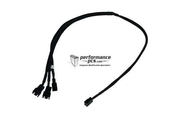

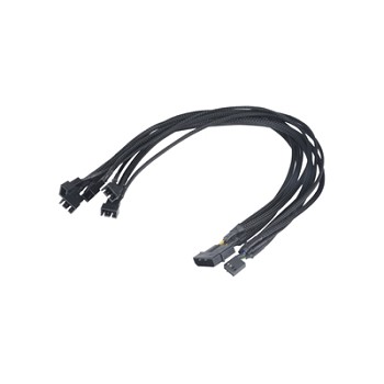

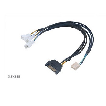

You can the pics above for the fan connections I have. I've already ordered the multiple fan splitters (pics below)
The splitters were bought from overclockers.co.uk and the names of them are...
Akasa FLEXA FP3S 3 Fan PWM Controller
Akasa FLEXA FP5, Smart PWM cable for 5 PWM case fans
Perhaps these are the wrong thing as the title now leads me to believe.
This is very frustrating. I bought half of the gear before I bought my aquaero as I only heard about it after.
I'm trying to make the best out of what I have. I understand I may have to spend a little more to get this setup actually where it needs to be.
I'd really like to control my fans, I believe they are controllable. I've learned many things and I'm doing my research before I plug it all in.

As I said above, I think you would just use the SMALL three pin fan connector from your fan (Although it doesn't look like a PWM fan connection to me from the photo?.. Normally PWM fan connectors are 4 pin but those look like three pin standard connectors) but here is your Problem Now.. If you have all PWM fans there is NO WAY you will be able run all 22 of the one PWM capable fan header on the Aquaero 5 (The Aquaero 6 can use all 4 fan headers as PWM but the Aquaero 5 can't it only has the 4th fan header that can be used as a PWM fan header) If on the other hand you fans are just standard fans then you just need to get ordinary 3 pin fan splitter cables rather than the PWM versions..
This is what is confusing me now... are you tryingto use PWM fans or just standard fans?.. I can't see from the quick glance I just had back through all the post which type of fans your using?.. Sorry if I've missed that somewhere.. It's very late here like 2.10am and I have to be up for work in 4 hours so I'm tierd lol....

This is turning into confusion central. I thought the pics of the white fan connectors you put up were the splitters but now I think I understand they are the connectors on the actual fans themselves?
It seems they are designed to either plug straight into the PSU OR into a 3 pin fan header
If so, they are not PWM fans and PWM splitter cables will be no use to you.
If the fan specs you have mentioned are accurate then an Aquaero 5 would have no hope of powering 22 of them. Why so many high speed fans anyway? a large rad surface area should only need low powered fans.
