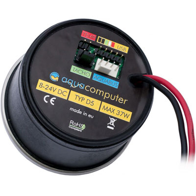

The title pretty much says it all.
I'm trying to get the flow rate to work.
I have an aquaero D5 connected by usb to the motherboard and I'm trying to get a reading of the litres per hour.
I've managed to get the rpm and the power reading but not sure how to get the lph reading from it.
Any help would be greatly appreciated
Thanks in advance.

The D5 can't actually do that. There is a flow section in Aquasuite for it because all MPS devices use the same control board and you have to tell the Aquaero what type of MPS device you have connected. Same as there is an internal temp sensor section with no reading because it does not have one.
Only a flow meter device will give an actual correct flow reading. You can switch the D5 to a flow meter in the Aquasuite software but the flow reading will be totally wrong.

Just incase with fingers crossed.... It's this one I have installed... Defo can't be done???

In order to report flow you need to use a flow meter such as thisThe pump you have pictured cannot report flow.

Can this pump report how many litres per hour it's doing through the rpm feature?
I have 8 pumps in this system and there is no way to monitor 8 mps devices.
Thanks
DarkRanger
Freitag, 13. Dezember 2013, 01:04
No, the pump won't report the flow, just the RPM, and there is no way to calculate the flow from the RPM of the pump, those two thing are totally independent.
You can monitor a maximum of 4 MPS per Aquaero device, but I don't think that there is a limit for the Aquasuite software, except the number of USB port available.
You can add a flow meter that is not USB and monitor it from the Aquaero, those uses the dedicated flow port of the Aquaero, not the Aquabus port.
