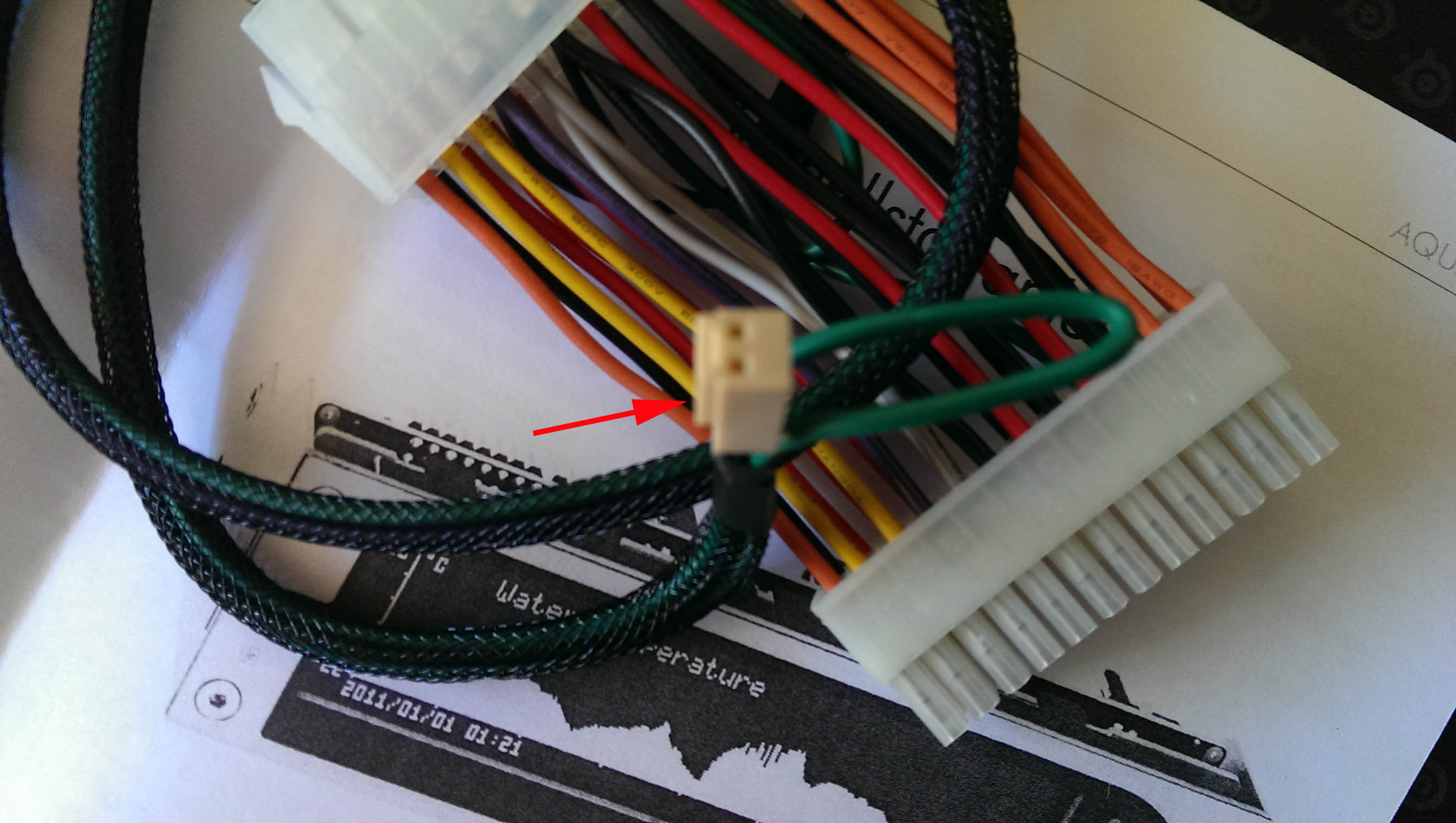

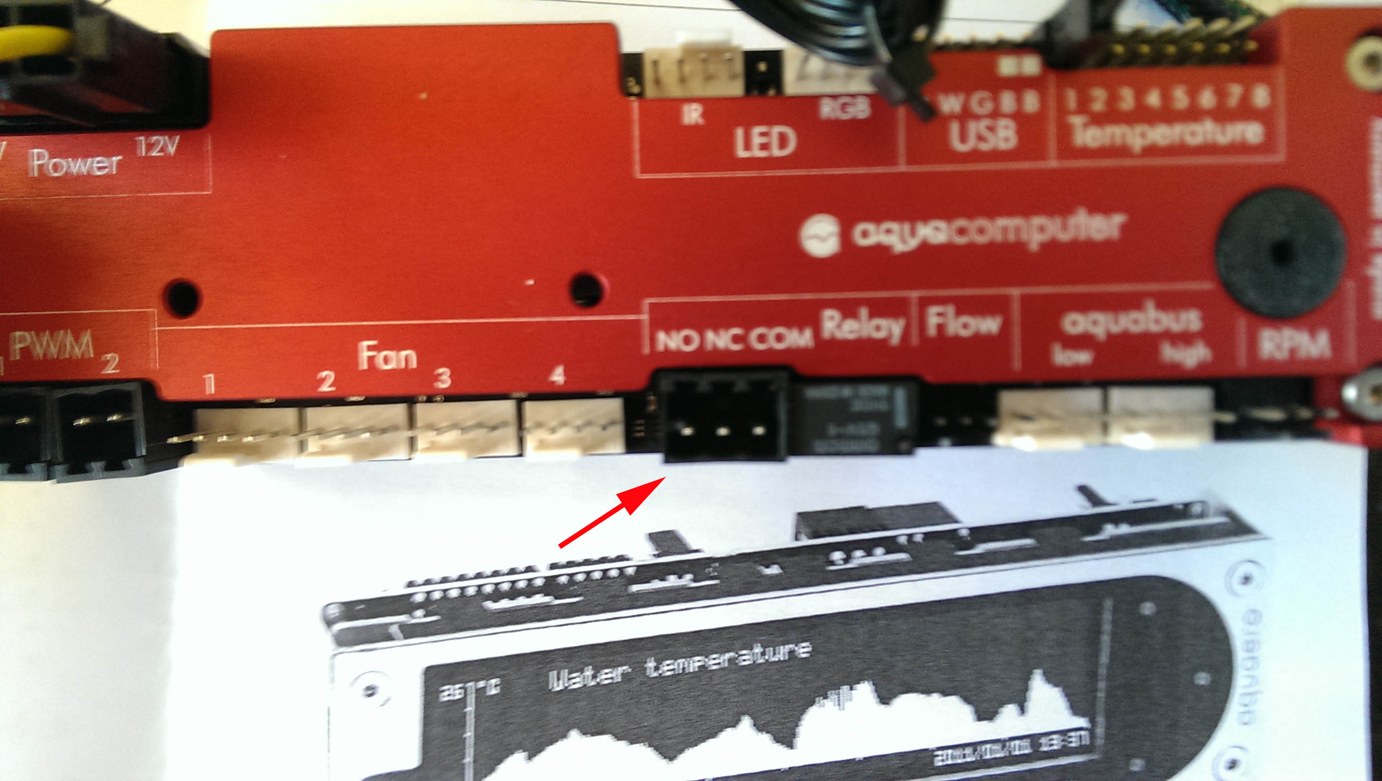

I just got an Aquaero 6 xt and I am trying to connect the shutdown relay cable 53047. The problem I have is that the connector (the plug) for the relay cable
(see attached photo of relay) does not fit in the connector of the Aquaero 6 (see attached photo of Aquaero 6). Does anyone have a solution?
There are two cables going into the relay connector, one is purple, the other is black. The Aquaero pins are labeled NO, NC, COM. Does anyone
know to what pin the purple and black cables attach?

I think I've read somewhere that this cable is not compatible with the Aquaero 6, only the previous versions.

That 2 - pin connector fits the +5v Standby on the Aquaero 5. Probably not needed (IMO) anyway since the USB is normally powered up on most motherboards even when pc is off.
mdsalas
Samstag, 15. März 2014, 01:01
OK, so the 2-pin connector was used in the Aquaero 5 to connect to the standby plug. Since there is no standby plug in the Aquaero 6, I'm guessing that
the 2-pin connector is not used (???). How about the green cable? Do I have to cut that cable and use the 53080 plug to connect it to the relay in the Aquaero 6?

Yes, the wire that goes to pin 16 on the psu needs to be cut and wired to the relay plug. Search around the forum, there are several posts and diagrams.
The alternative way to shut down the pc on alarm is to wire the relay across the switch wires....this can be done right at the case switch (what I did, and usually closer to the Aquaero), or at the front panel header or really anywhere along the switch wires.

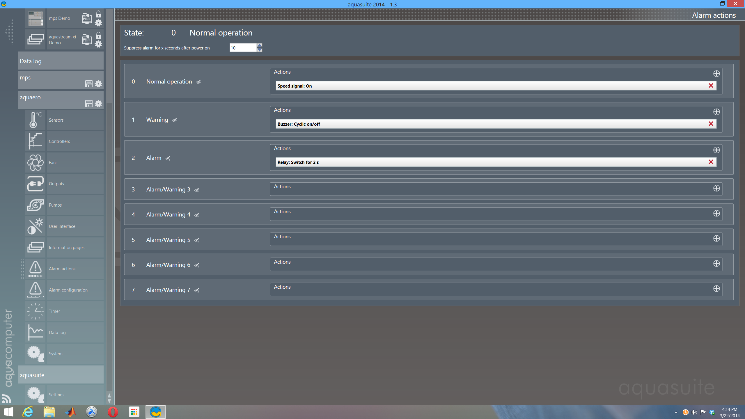

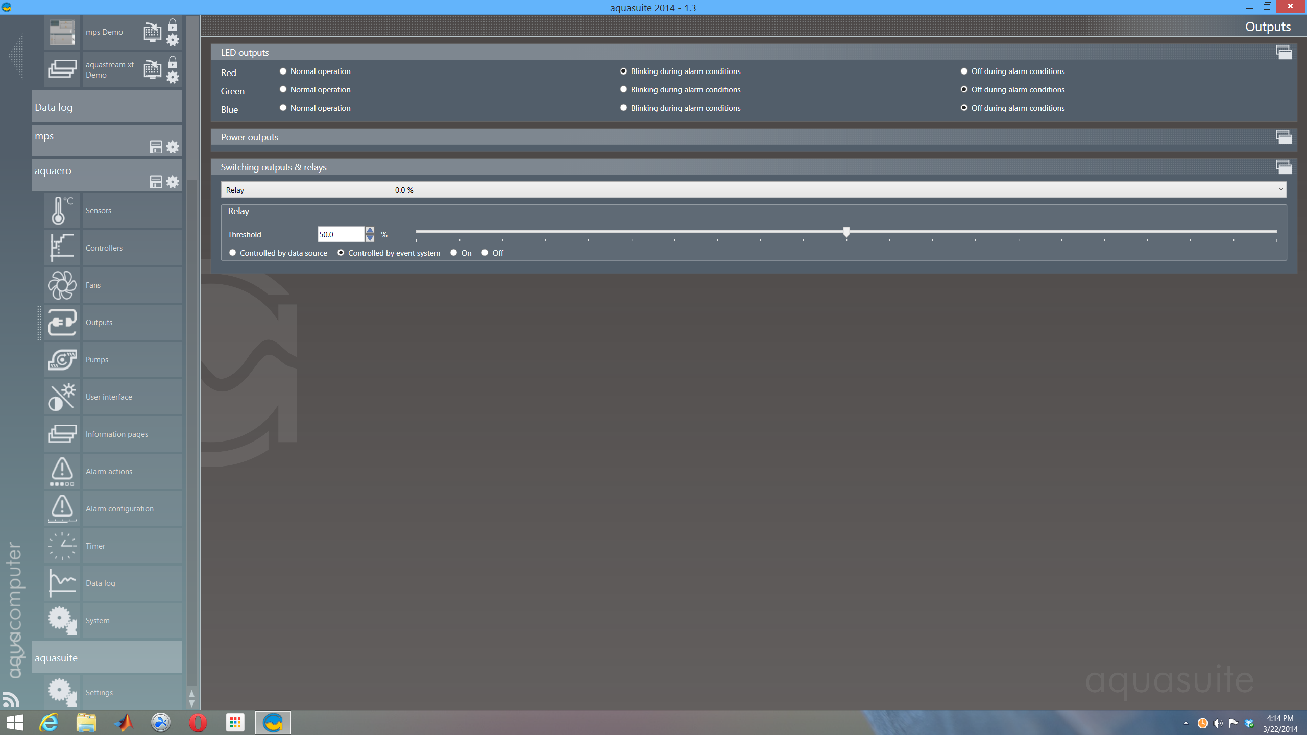

Mandrix, I have the 24-pin relay cable connected using relay pins 1 & 3 as you suggested. Under Outputs ->"Switching outputs & relays" I have selected "Controlled by event system" (What does a threshold of 50% means??). Under Alarm configurations I have Aquastream XT for Data Source, Alarm enabled and in the options window I have it set to Alarm. Under Alarm actions, I have selected Relay: Switch for 10 s under Alarm.
My question is, If the pump stops running, is this going to shut down the computer???

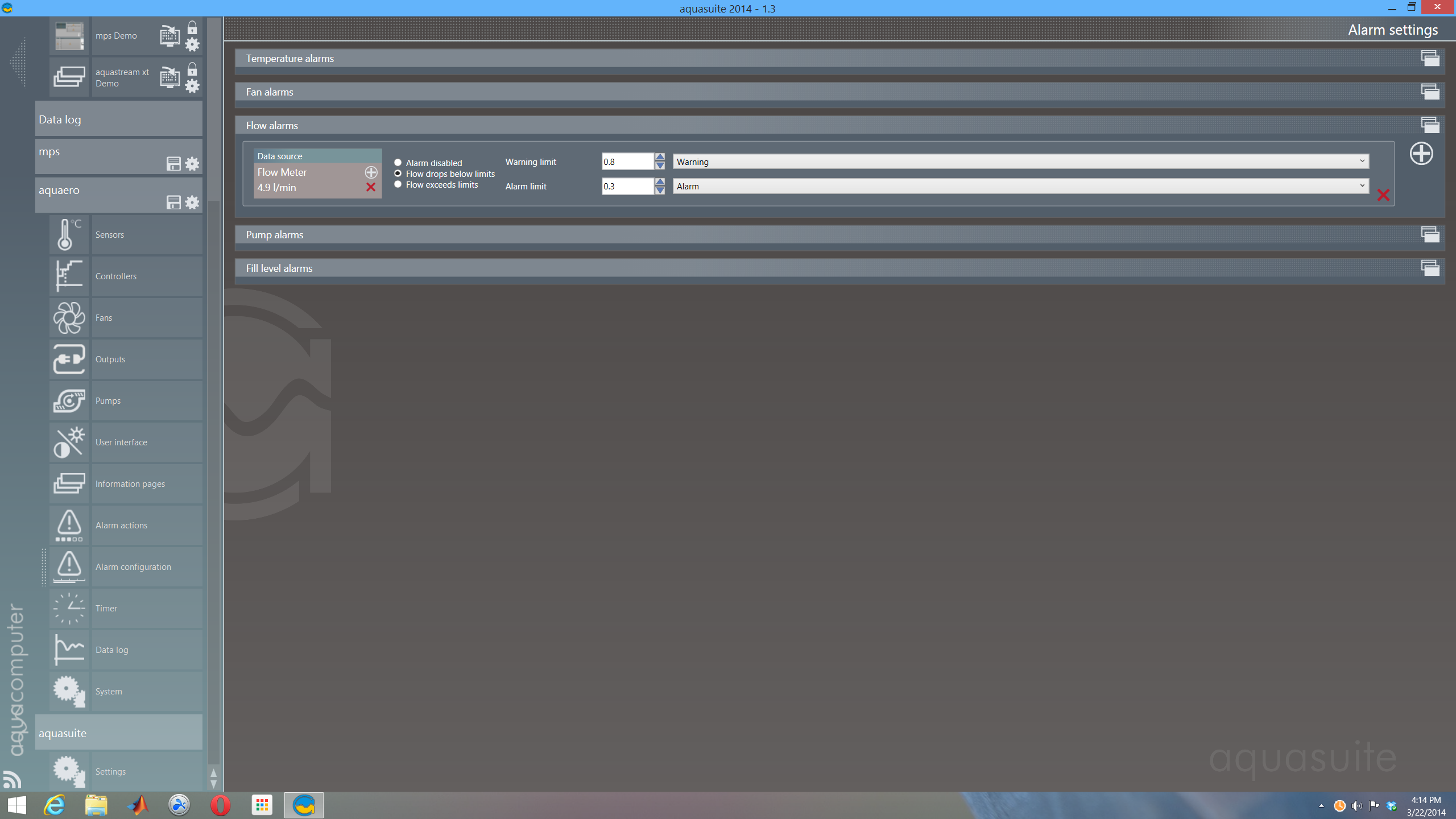

To shutdown on low flow, you must set up parameters under Alarm Configuration Flow Alarms, then under Alarm actions I use Switch Relay for 2s.
Leave the Relay threshold at 50% I was told.
You don't need to set anything up for pumps, you are trying to shut the computer down on low or no flow. This is all dependent on the output of your flow meter.
To test if the relay works, you can activate it by going to Outputs/Switching outputs and relays/ and selecting "on" I think will open the relay.

I did "Outputs/Switching outputs and relays/ and selecting "on"" by accident a while back and it sure turned the computer off. I'll try what you suggested above. Thanks again.

This is how I have it set up, see the 3 attached screen shots. Hope it will be helpful to others.

The marking engraved on the AQ6 cooler block is incorrect, pins 1 & 2 are switched. I'll post the link for that info when I find it again.
