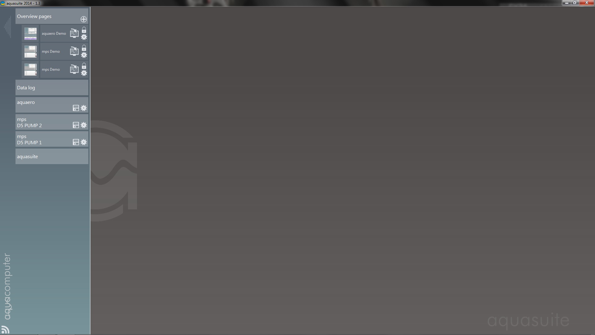

Montag, 17. März 2014, 11:43
I need alot of help ,I got my pumps and res now when i hook this up i have to set one pump to channel 12 and the other to 13 right? i also will have my flow sensor and that will be i think is flow 11,Can someone give me some reading on hooking these pumps together(Aquacomputer D5 Pump Mechnics with USB and Aquabus Interface)why do i see just one pumps and why does it come up as mps?thanks all 4 the help

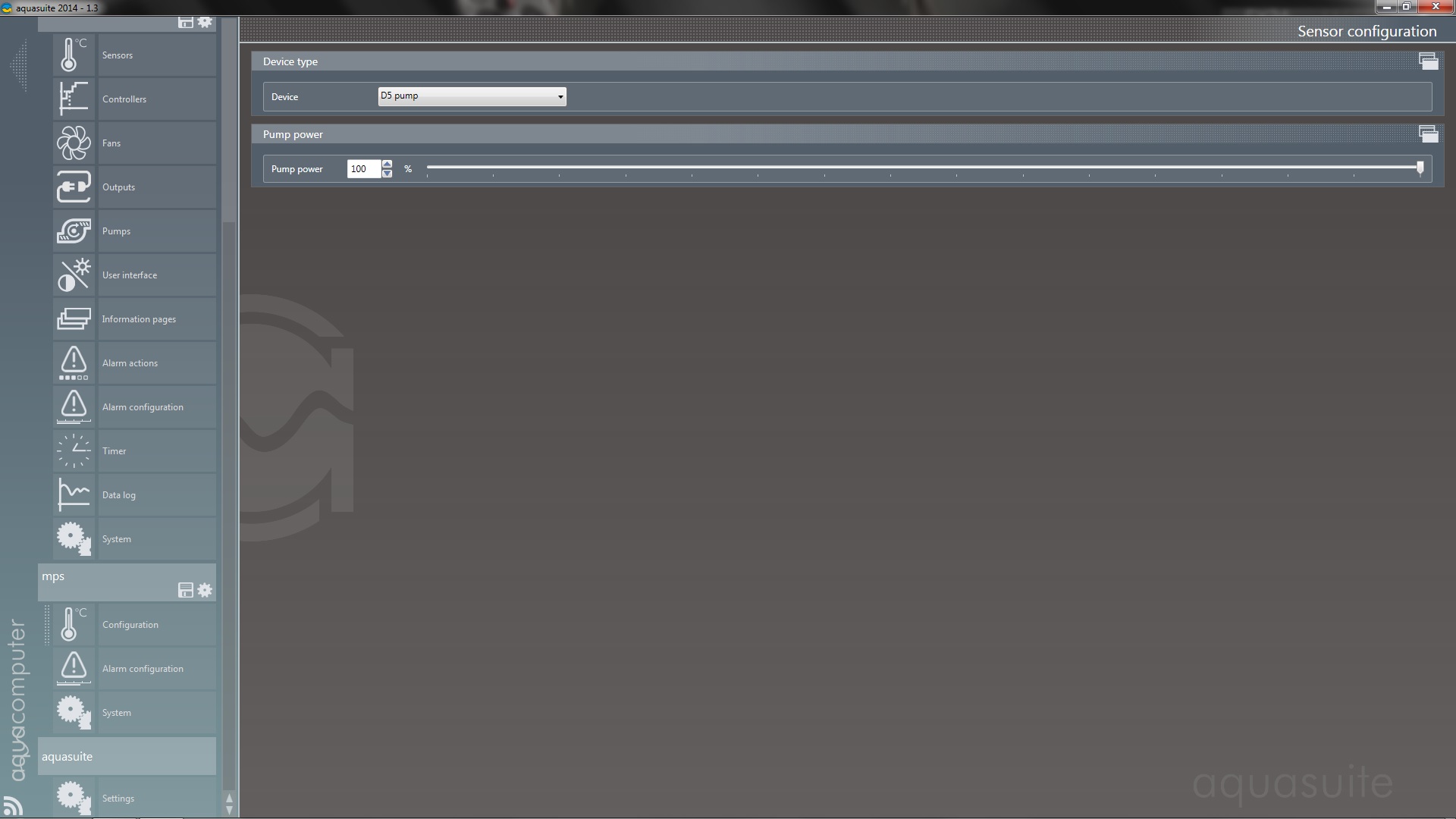

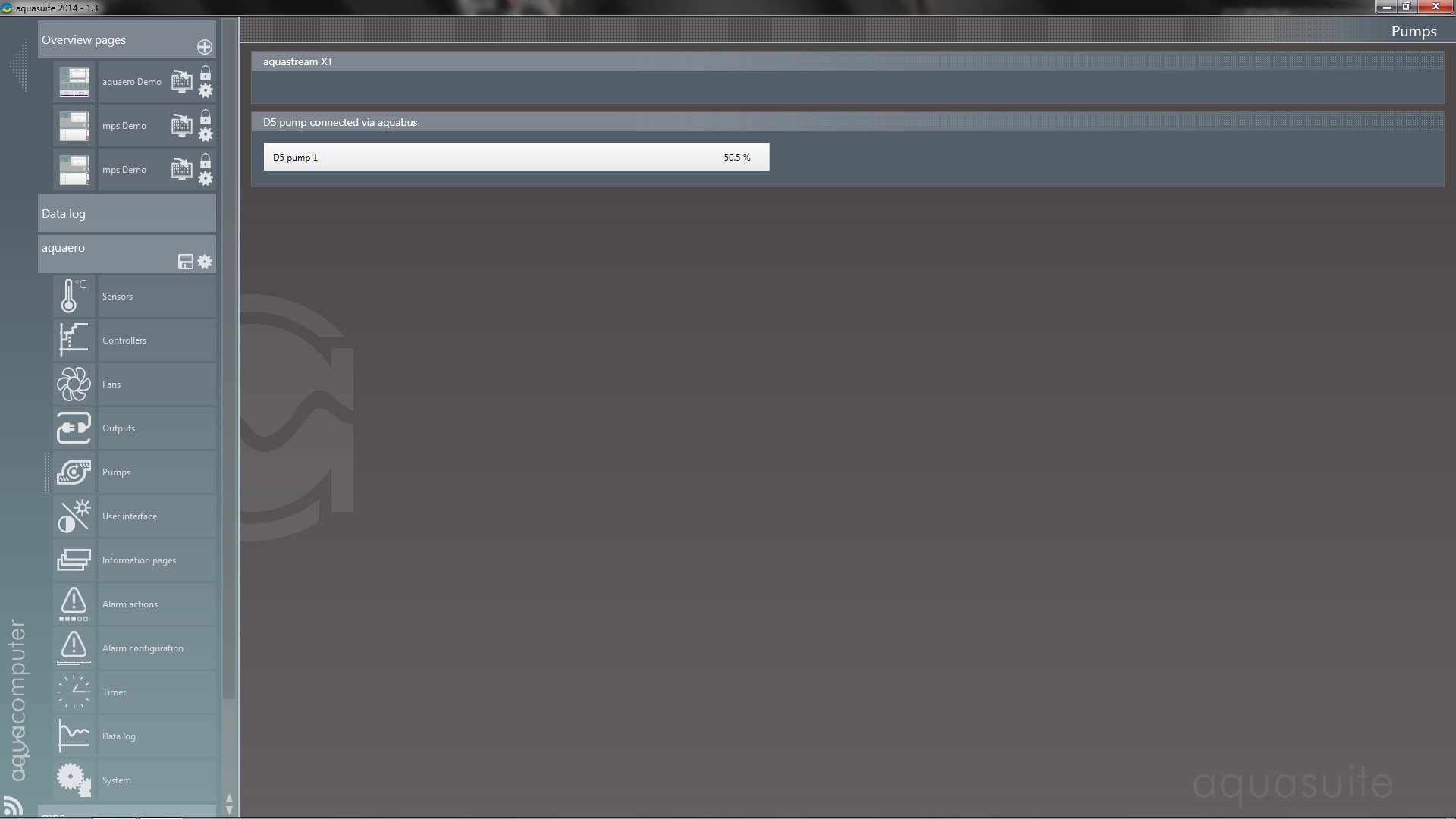

bcikota
Dienstag, 18. März 2014, 10:05
Hi pegleg,
You need to browse the forums a bit, read the new manual , or even better, take a look here. That site is done by Namron, one of the frequent visitors of this forum. You should be able to find all the guides you need to properly set up your system.
Basically, you need to connect your pumps via USB. Set them do individual adresses, 12 & 13 is fine. Flow sensor can be 14. Both pumps and the flow sensor have the MPS board integrated, that is why they are reported as MPS type devices. You can have a total of four on one Aquaero.
Once you have set up the addresses properly, you can choose whether you want to connect them via USB, Aquabus or both. There is no problem leaving them connected with both cables.
Kind regards,
Boris.
madcratebuilder
Dienstag, 18. März 2014, 13:51
What Boris said.
All I can add is you may need to restart Aqua Suite 1 or 2 times for all mps devises to appear

I see 2 mps's but when i click pumps on the aquaero all i see is one pump and when i go to controllers and look 2 set up the pumps in there all i see is one pumps .
»pegleg« hat folgende Bilder angehängt:

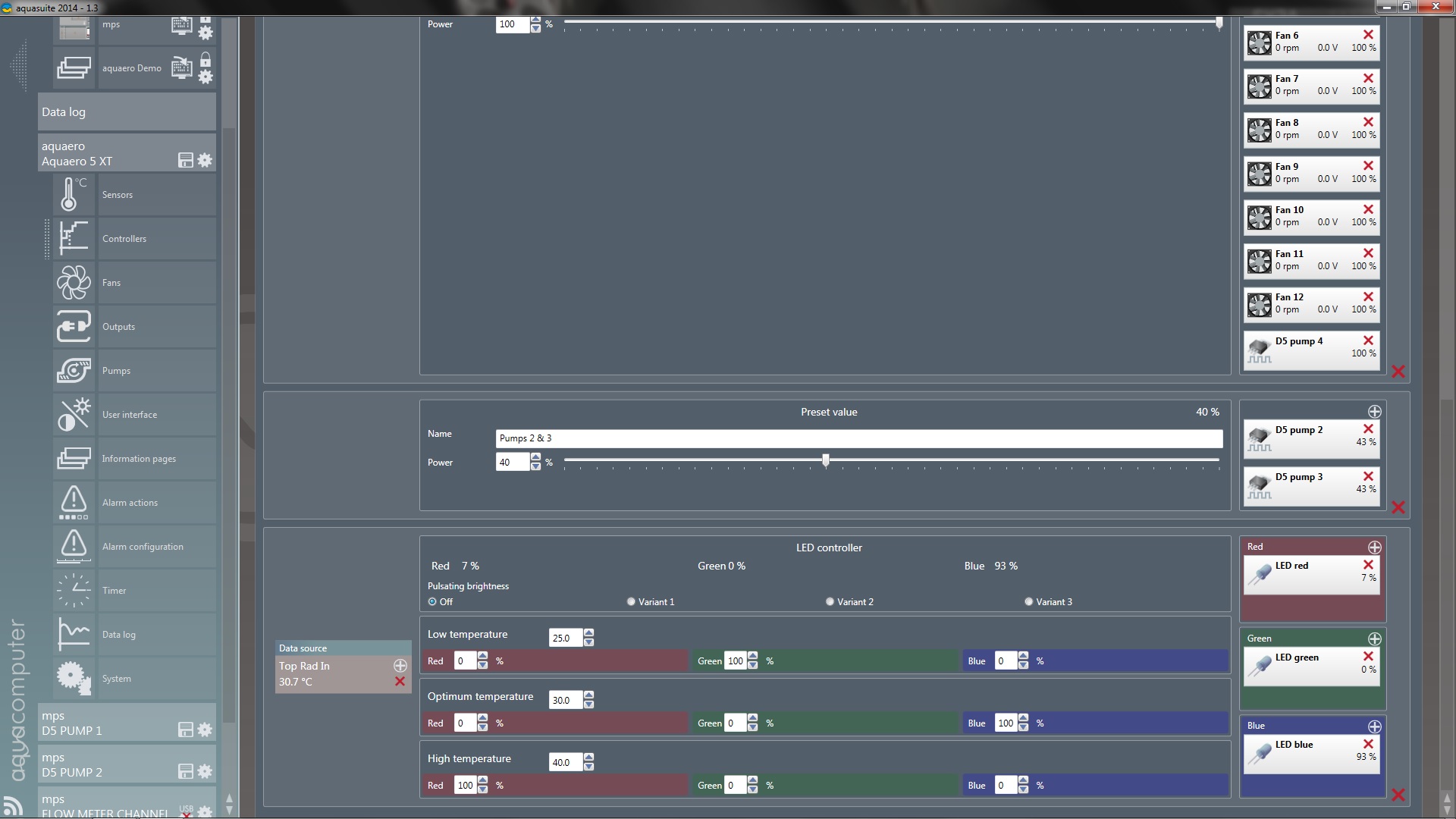

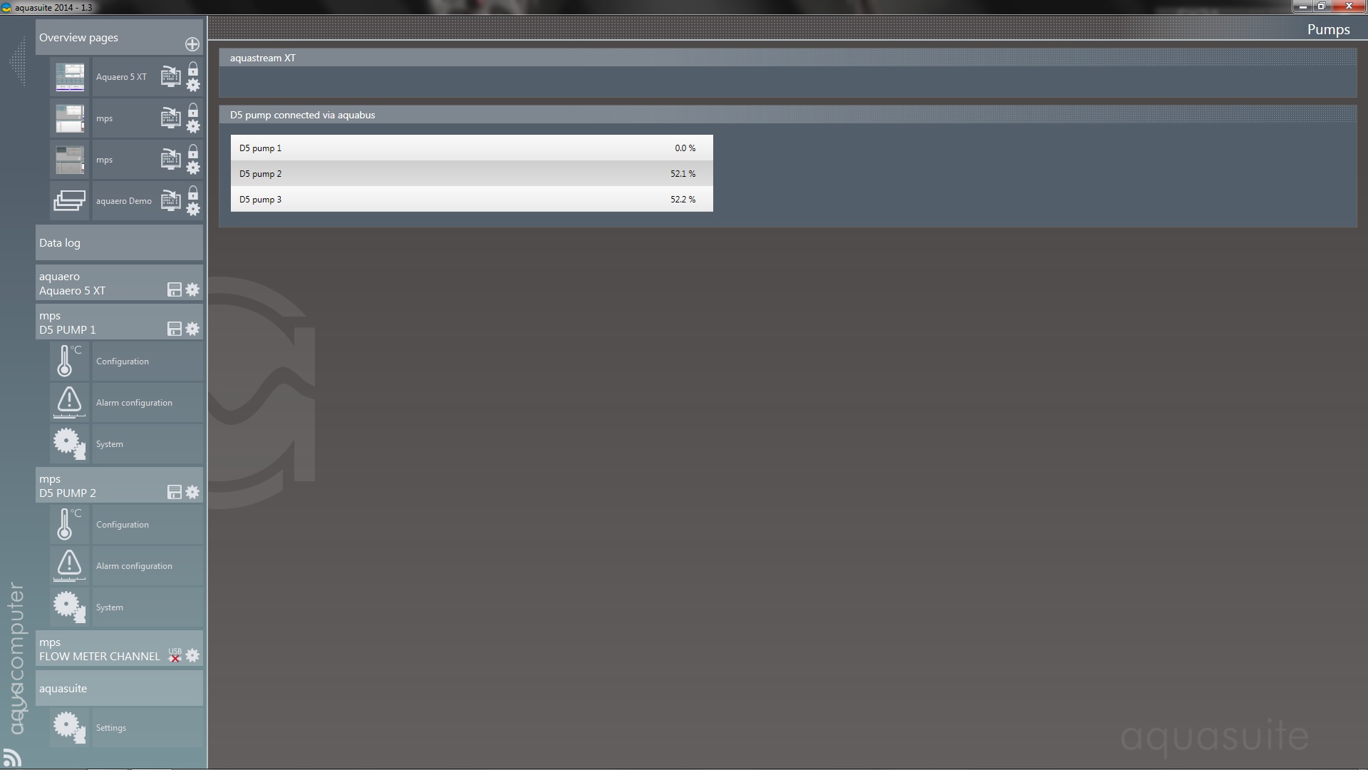

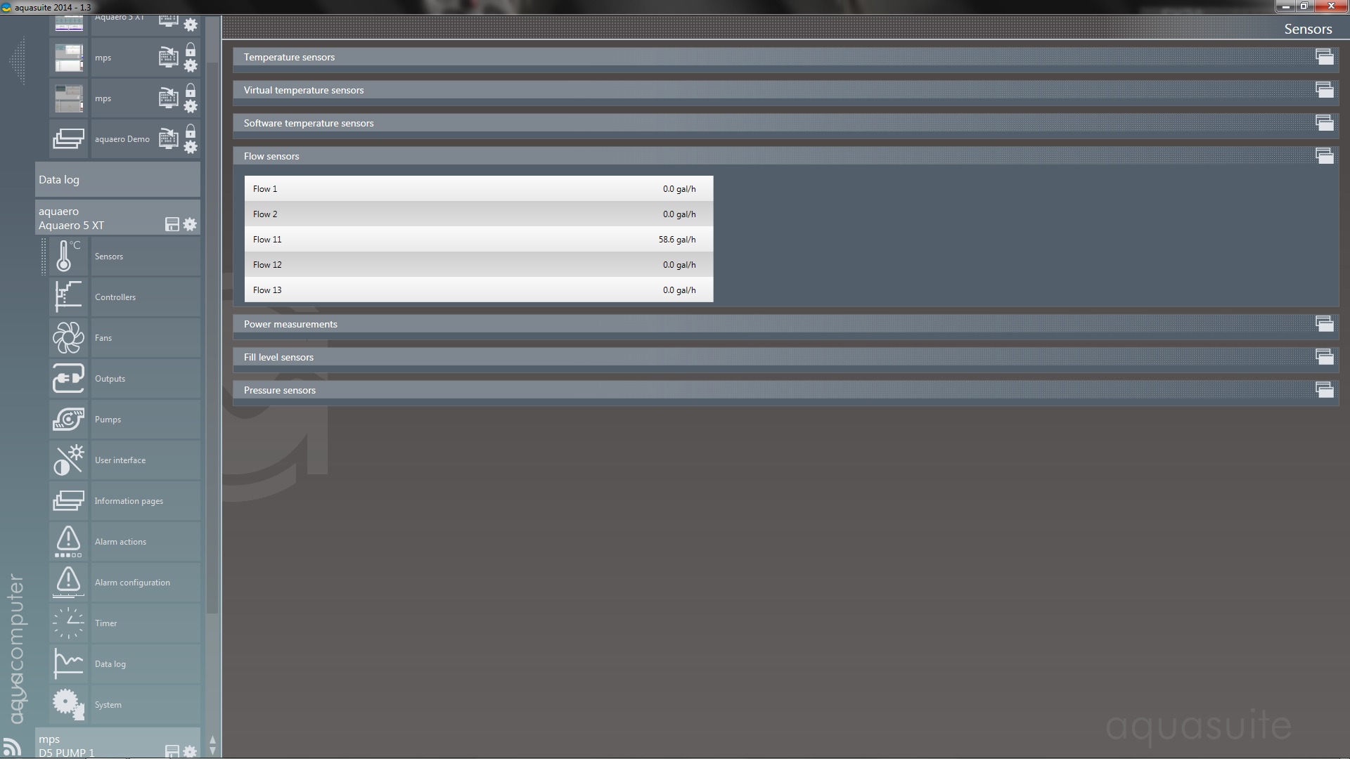

Sonntag, 23. März 2014, 09:32
why do i have 1,2,3 pumps and also u see on left i have it set to 1&2 for the pumps but on the right side u see 1,2,3 for the pumps only two with power and its not my 1 and 2 pumps,and why do i have so many flows....Anyone please
also why when i set my pumps to 40% it will say on the right 43 %?

Montag, 24. März 2014, 16:25
All MPS-devices have place holder for all MPS-function.
