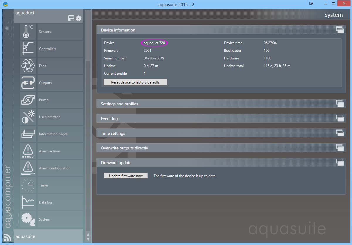

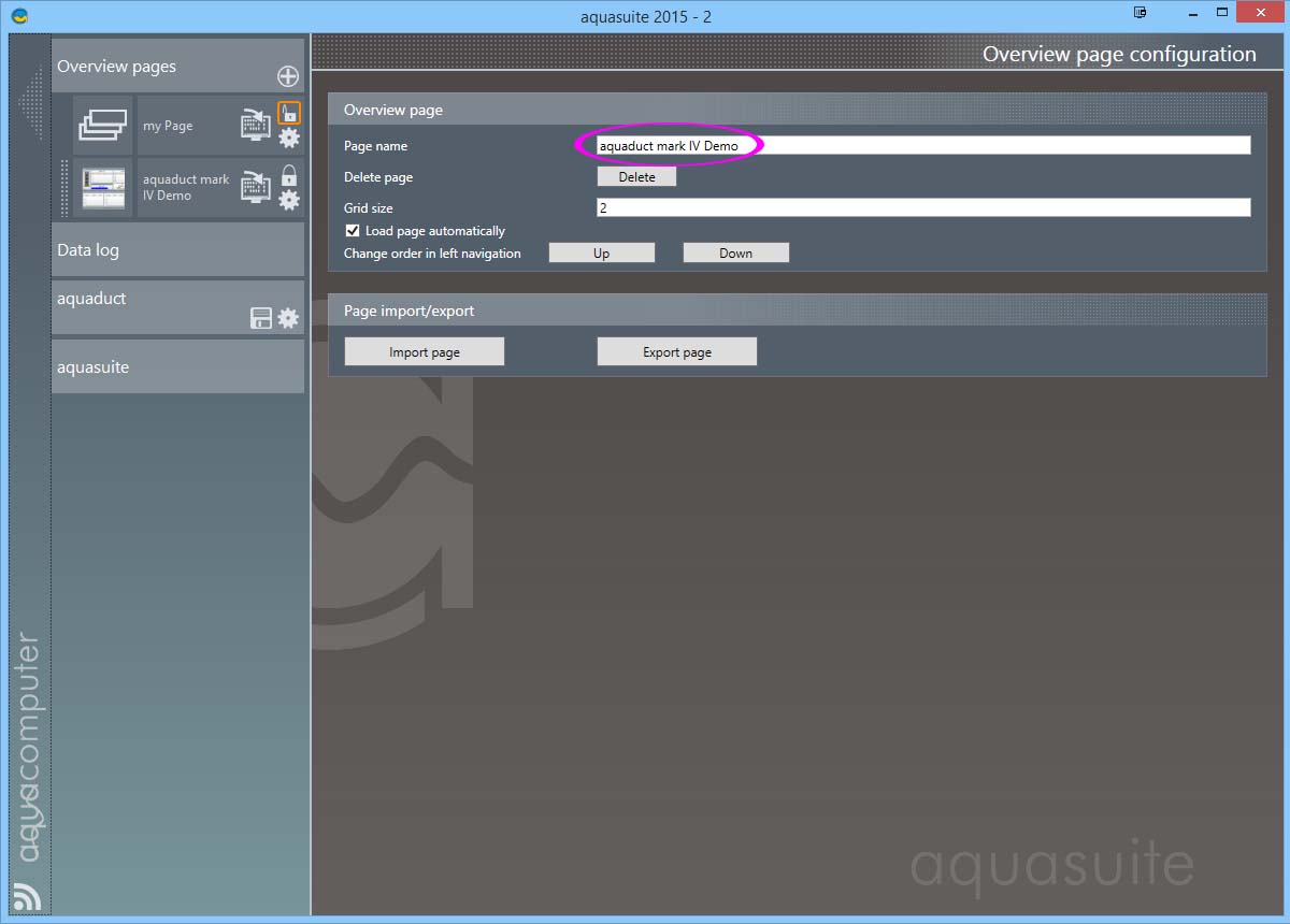

Not sure how much of an impact this has, but aquasuite 2015 appears to read my 'Aquaduct 360 XT mark V' as being an 'Aquaduct 720 XT Mark IV'.
Dieser Beitrag wurde bereits 1 mal editiert, zuletzt von »InfoSeeker« (21. Dezember 2014, 14:18)
Montag, 22. Dezember 2014, 09:12
It does not matter. These are only names. The overview page can be renamed by yourself and the wrong name in the info box was very likely caused by a wrongly set name when it was flashed the first time. Maybe we can add an option for the next version so it can be set by the user but as said it has no effect at all.

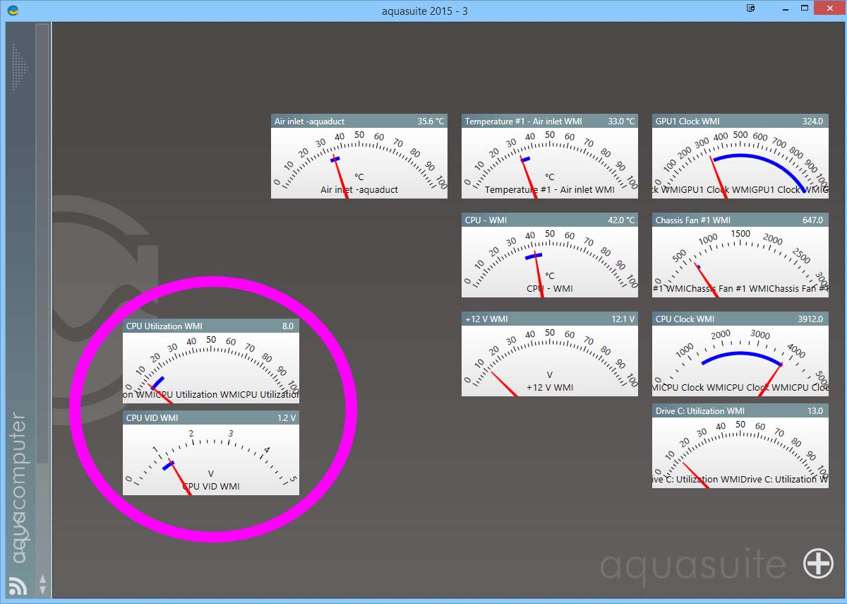

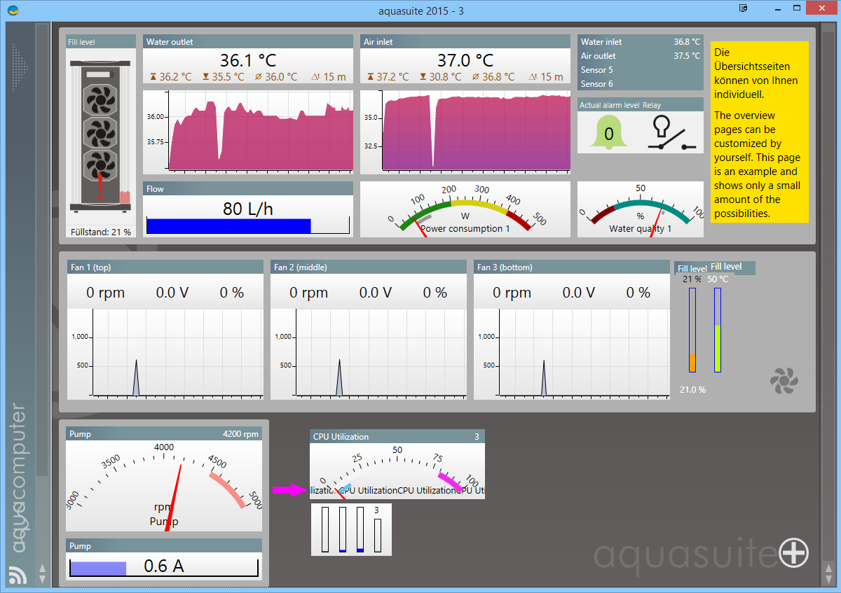

Possible anomoly when using a WMI source
Dienstag, 6. Januar 2015, 14:45
I am playing with aquasuite to learn it, and when using a WMI source, it appears the title at the bottom of the gauge is formatted incorrectly.
This was noticed with versions 2015/2 & 2015/3. See CPU Utilization gauge bottom center of attachment.

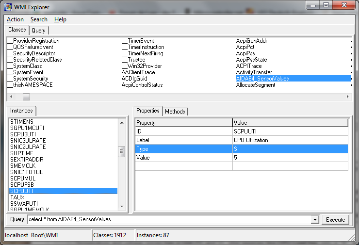

Regarding my post 27 above, I found that any value taken from WMI that has a label (v, rpm, °C) attached, formats properly. But without a label attached, the formating fails.
Dienstag, 13. Januar 2015, 13:50
Working under the assumption Aida64 was not providing the units/labels for all the values sent to WMI, I suggested it would be useful if Aida64 did so in their forum.
The reply was "AIDA64 exports both units and values for all type of readings It's the fault of the other (importing) software if it only picks up some of the units. Or, in this case, I suppose Aquasuite assigns units based on type of values, and doesn't use the units provided by AIDA64 through WMI.".
Is it possible there are varying interpretations/implementations of the WMI specification, particularly in passing unit values?
Mittwoch, 14. Januar 2015, 13:25
I have checked the aida export via WMI.
Temperature and voltage sources has a Unit (°C and V), other sources like CPU Load has only a "S" as data type. We cant attach a unit to this value.
When no Unit is provided, we have actual a problem with the formated output of gauge values/descriptions in the element.
This bug is fixed in the next version.

It appears unit type/definition needs further definition/agreement between Aida64 & Aquasuite.
I see six WMI variable designation applied by Aida64.
   T - Temperature (°C)
   V - Volts
   C - Current (A, mA)
   F - Fans (rpm)
   P - Power (watts)
   S - System
         date
         time
         uptime
         cpu/memory/etc clock speed
         memory timings
         bios version
         device used/free/utilization
         NIC up/down speeds & total up/down
         master volume
         battery & estimated time & status
         & others
Temperature & Volts are currently read correctly by Aquasuite.
Current, Fans & Power, though not currently read, should not be dificult to implement, as each is specific to a unit.
System encompasses many varying types of units, and both parties would have to agree on unit designations for the various types.
