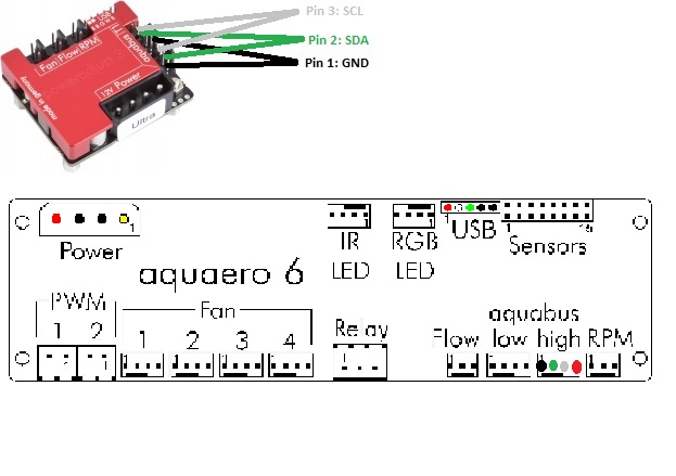

I stil need to figure out the 3 pins of the PA3s Aquabus connectors, which ones are in relation to the 4 pins the aquabus has on aquaero.
Probably pin 4 is missing, and pin 1 is the one on top.
4.6. Connector “aquabus low speed/high speed” in the Operation manual
Pin 1: GND
Pin 2: SDA
Pin 3: SCL
Pin 4: +5 V
At the PA the same
Pin 1: GND
Pin 2: SDA
Pin 3: SCL
PS: Do not forget to set the aquabus-address
Dieser Beitrag wurde bereits 3 mal editiert, zuletzt von »EnigmaG« (16. Februar 2015, 15:47)

OK, i saw in the manual of the Aquaero the pin numbering of the aquabus port.
Since i own poweradjusts 3, and not 2, i need to ask if there is an online manual for the 3 version. I suppose that pin number 1 is the pin on top, and 3 the pin on bottom.

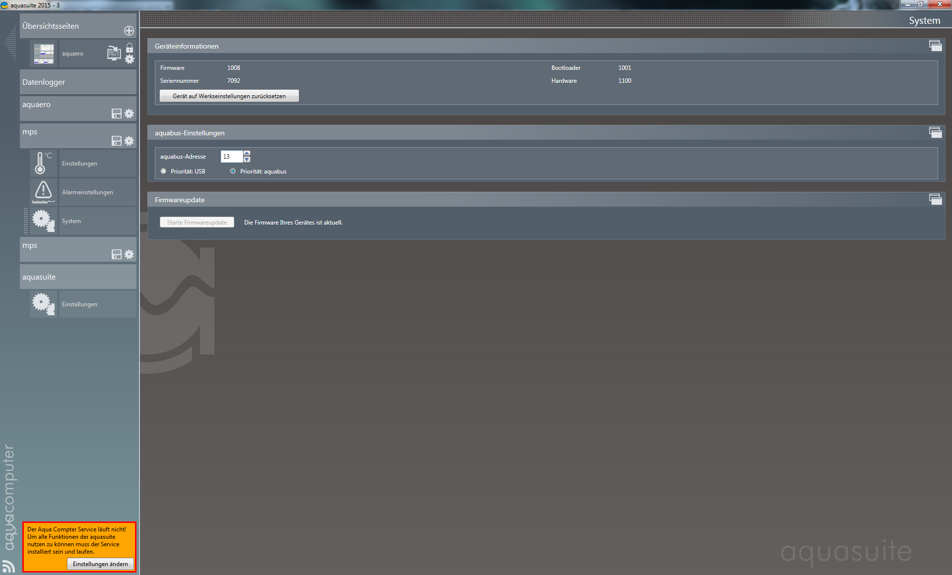

How do i set the aquabus adress for each device ? in the aqua suite software, or somewhere in windows ?

Mittwoch, 18. Februar 2015, 00:36
Yes, it is in the aqua suite software over usb, i would disconnect the aquabus fron the AE6 an till, i do not know if it is a problem for the other function if the aquabus is confused.
It is always the same, is the clip on the bottom pin 1 GND is left

Bytales
Mittwoch, 18. Februar 2015, 11:42
So its actually exactly as i did not said.
Pin 3 is on top, and pin 1 is on bottom.
How do you know this, is there somewehere a documentation, or you wired it like so and it just worked ?
Mittwoch, 18. Februar 2015, 18:11
It is a parallel-bus, the connector a all the same. If you not sure take the original cable as a pattern (3Pin 4Pin)

Sonntag, 22. Februar 2015, 09:25
Ok, i did the chain aquabus cable of the PAs.
Now regarding the 3 pin power output, where the 3 pin fan gets connected, any ideea which pin is pin 1 ?
Because in the poweradjust manual, the poweradjust 2 is depicted, and here the 3 pin power output horiyontal, on the 3 pin power output is vertical.
And i have no fan currently with 3 pin cable to do the test, the Delta Fans were bare wire.
If i were to judge from the way the aquabus pins are arranged i would dare to say the bottom pin is pin 1 (pin 1 is ground, pin 2 is power, pin 3 is sense).
PS> i just took a 3 pin connector, looked at some pictures of poweradjust 2, in the manual, then the waz the pins are arranged in the power adjust 3,
It seems the bottom pin is pin number 1.
I just need confirmation.
