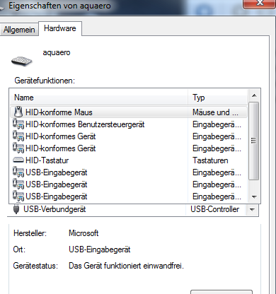

Montag, 20. April 2015, 18:43
Have you double checkt the connection, offset or twisted?
Windows driver all there?
