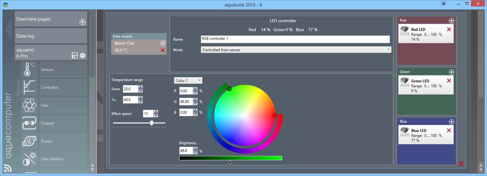

Yea, the LED Controller can be a bit daunting till you follow the logic.
First, you should only have one controller.
select "Controlled from sensor" as you have done.
select your data source, Liquid in your case.
set the temperature range for the full range you want to cover (i.e. 20 to 40).
select color 1, and specify the color you want to show at the low temperature (i.e. R-0, G-100, B-0)
select color 2, and specify the color you want to show at the high temperature (i.e. R-100, G-0, B-0)
on the right side click on the Red + symbol & select Red LED
on the right side click on the Green + symbol & select Green LED
on the right side click on the Blue + symbol & select Blue LED

Donnerstag, 21. Mai 2015, 14:36
Temperature range from 20° to 50° (<20°= 100%B 35°=100%G >50°=100%R)
Color 1 G 100% B 0% R 0%
Color 2 G 0% B 0%R 100%
click on the color arrow to switch from b-pink-r to b-g-r

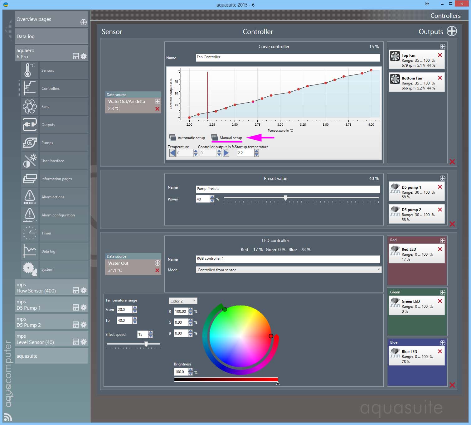

Donnerstag, 21. Mai 2015, 18:21
@EnigmaG
I was not aware clicking on the color arrow would swap it... thank you for that.
@Marucins
I don't believe you can have the colors switch without gradation, and I don't know about running multiple LED controllers.
"How do you set water temp intervals - for the fans and for the pump? "
I think you want to use the Manual setup on the Curve Controller... then you can set each point individually.

Marucins
Freitag, 22. Mai 2015, 01:01
Yes I did.
I wanted to have one color for specific temperatures.
[attach]5285[/attach]
I do not know how to properly set the minimum temperature, maximum. I've never had a custom LC... -> Moved OT on to the correct section (http://forum.aquacomputer.de/weitere-for…d-how-to-setup/)

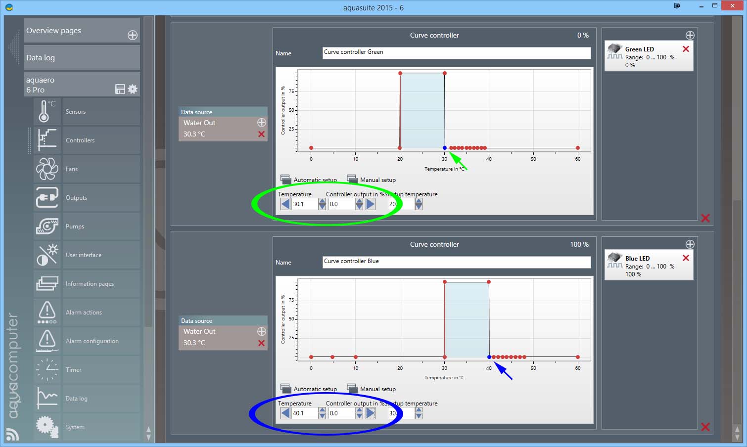

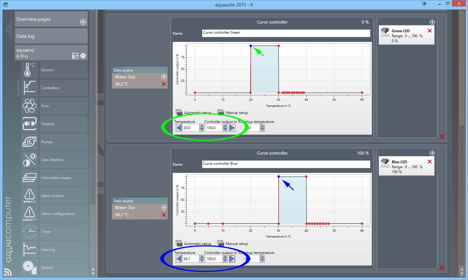

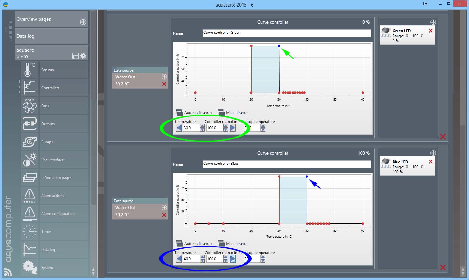

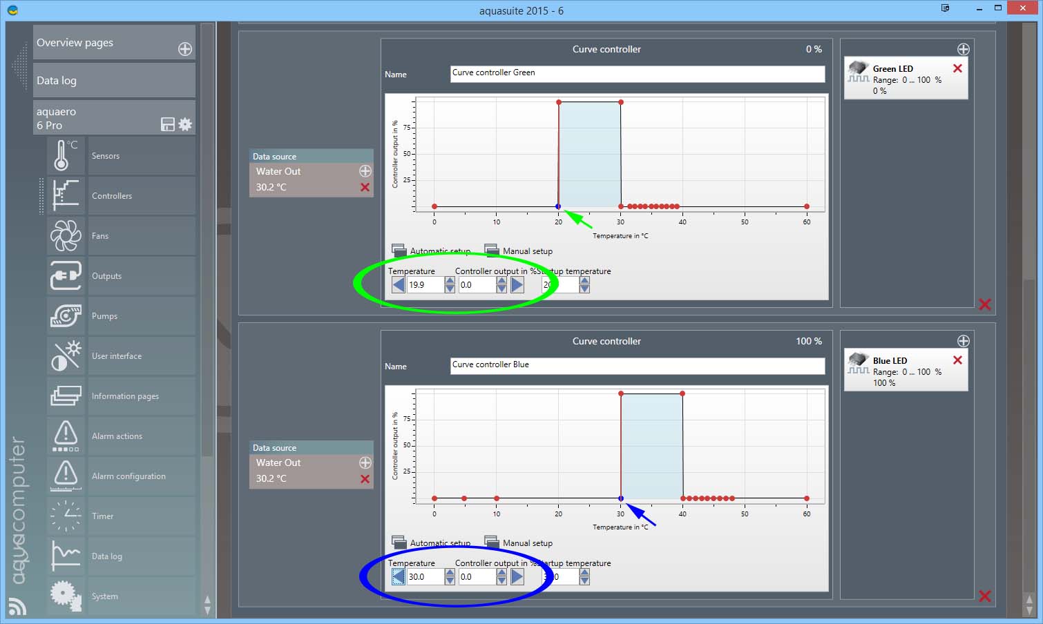

Freitag, 22. Mai 2015, 02:50
OK, then you need to abandon the LED Controller and set up 3 Curve Controllers with square curves as per EnigmaG's suggestion.
I set up two to test and they seems to perform as per your wishes. You can add the third.
Simplest is to set the first point as 0,0, and the last point as 60,0, then set the rest zeros. Then chose 4 consequtive points to make the square curve.
It will not be exactly square as 0,1 is the smallest increment, but good enough to serve.
