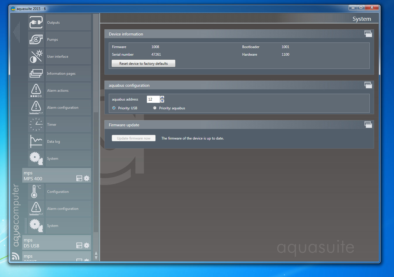

After I rebuild my system my Aquaero 6XT seems not working right , It couldn't detect any Aqua hardware ( MPS 400, 880XT , D5 usb ) none of them now no longer shows in 6XT .

Also, have you set each MPS device with it's individual and unique 'aquabus address'? (your MPS400 is set to address 12)

Yes , the 400 I address it to 12

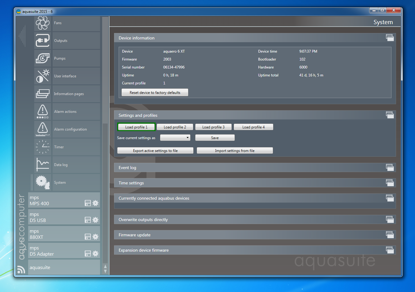

and also the 6TX act funny , at the Currently connected aquabus devices part some time shows " real time clock " instead showing numbers
and the 880TX is only fill level and the Aqua 6XT not even detect the pump , as you can see at the last photo the TX detect nothing at all even when I install them one by one ;(

OK , here is the photo for what I am talking about
as you can see the Aquaero didn't detect the MPS 400 and shows "Real time clock" ! Is that a Joke !!!???

Please don't shout at us, we will do our best.
The real time clock in the MPS list is not a joke. You must have a Real Time Clock installed, and since it communicates via the aquabus, it is listed under aquabus devices.
The problem is that none of your other devices show up in the aquabus list, so the aquaero does not see them.
Since we can see 4 MPS devices in aquasuite, we know you have them connected via USB to the motherboard.
Do you also have the four MPS devices connected with aquabus cables to the aquaero?
EDIT: added link to aquabus cables

Yes both USB and Aquabus cable are connected and none of them shows in Aquaero
And I don't have that "Real time clock" install and I don't know why it shows up ?(

The real time clock displaying in the currently connected aquabus list happens sometimes when you have an address clash. Ensuring each mps device has a unique address from 12 to 15 then removing all power from the aquaero, including USB standby power will fix it.
