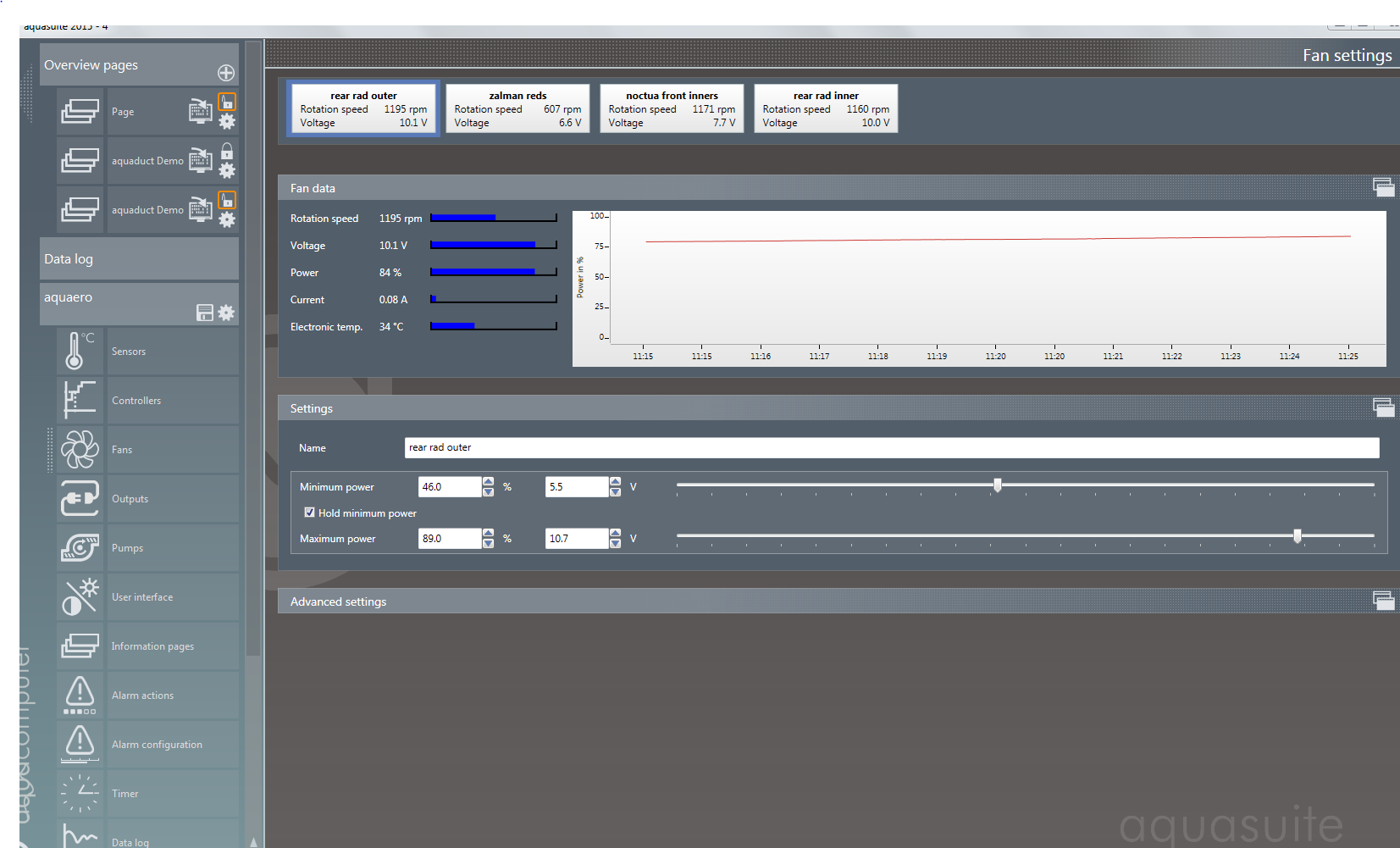

Mittwoch, 22. Juli 2015, 22:22
Hi yes i'm not that savvy with screenshots but hopefully this will work.

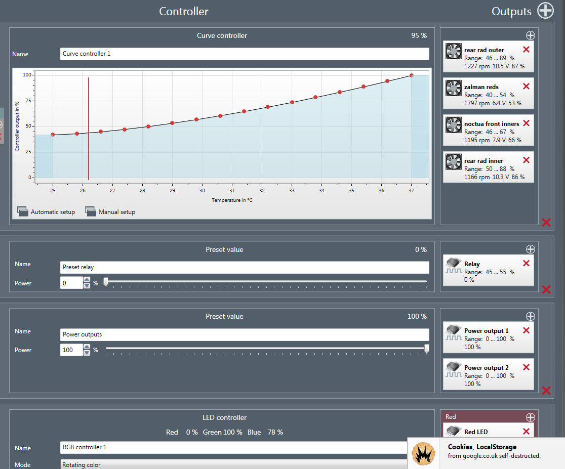

Mittwoch, 22. Juli 2015, 23:55
Nice screenshot, except you excluded a point of interest, the"Source" to the left of the curve. :)
EDIT: a screenshot of the aquaero>fans tab would be useful also. (sample below)

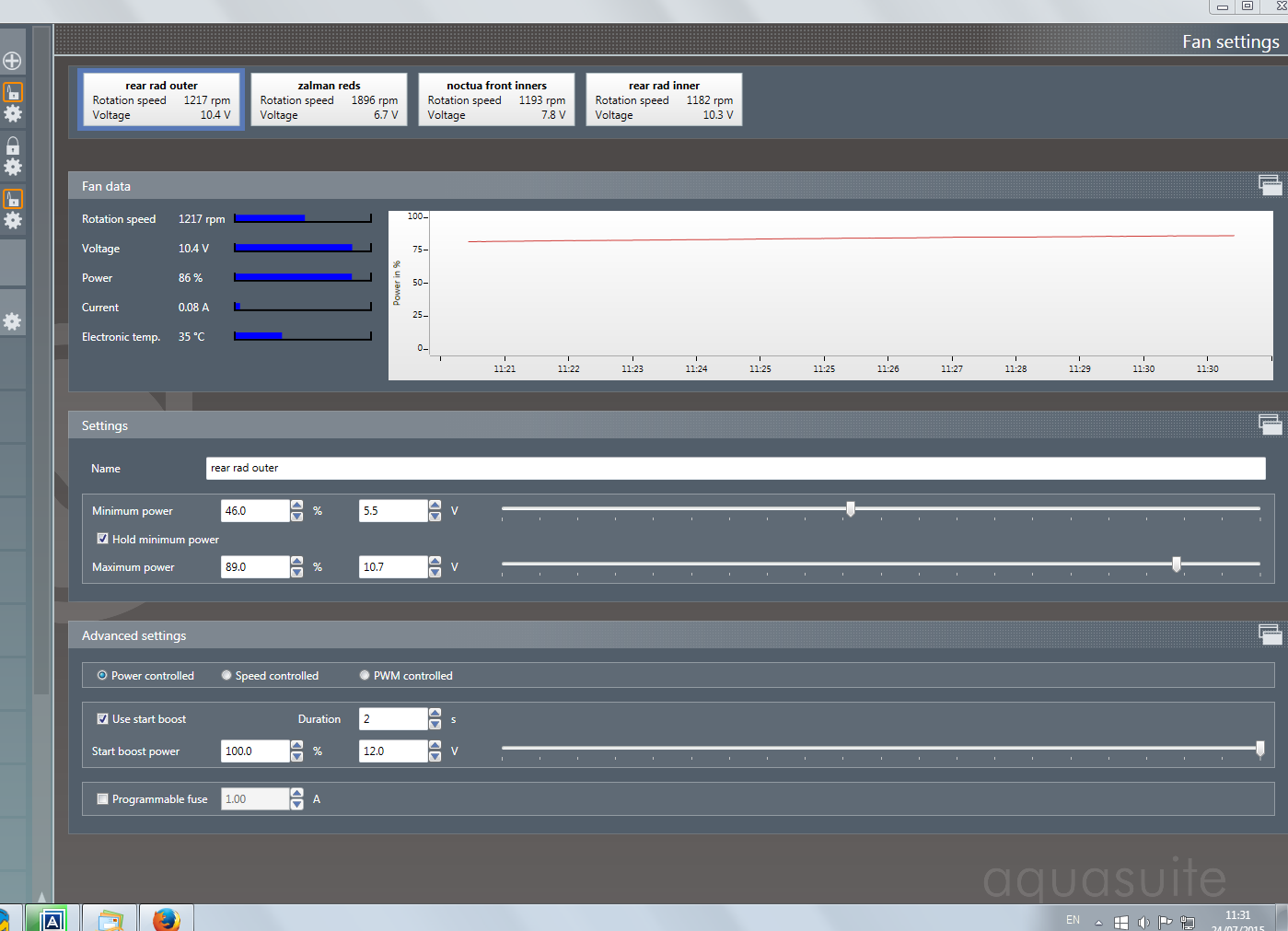

garyd52
Freitag, 24. Juli 2015, 12:34
i've done it again as I did'nt open the advanced settings in the first one
»garyd52« hat folgendes Bild angehängt:
Freitag, 24. Juli 2015, 16:20
I do´t see the Problem. By "Rear Rad outer" the spectrum is 46-89% Delta 43%
1% at the curve make 46+0,43%=46,43% at the fan
at start off your curve approximately 43% should it be 46+0,43*43=64,49% at the fan
At 95% 46+0,43*95=86,85% as it is in the first picture
Dieser Beitrag wurde bereits 3 mal editiert, zuletzt von »EnigmaG« (25. Juli 2015, 09:27)
Freitag, 24. Juli 2015, 19:39
What was the temperature reading of the sensor you use for the fan controller?
I see you have the "rear rad outer" fan set to go no slower than 46% and no faster than 89% of the power range.
The fan is running at 86%, so you are basically running the max as you have it set in the fan setup.
If you specify 46% min and 89% max in the fan setup, the fan controller can only work within that range.
