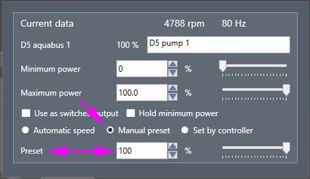

You have the pump set to "Manual preset", and you have the Manual preset, set to 100%.
You can either adjust the speed with the Preset slider, or if you want to control the pump from the controller tab, you should select the "Set by controller" option, and make a pump controller under the controller tab.

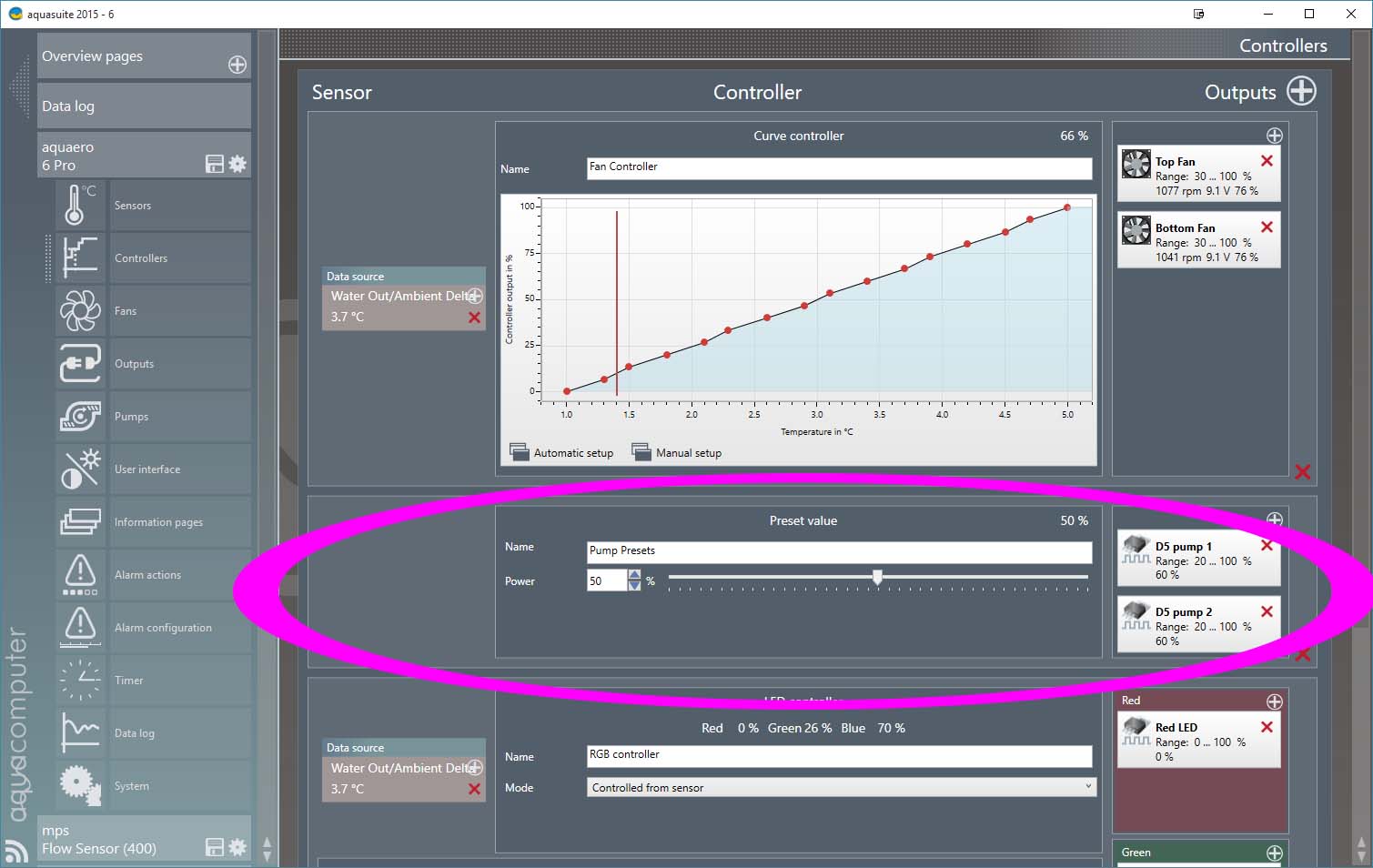

I have a "Preset" Controller for my pumps because I don't vary my pumps due to conditions, but I can control both pumps with one slider.

Heremod
Sonntag, 4. Oktober 2015, 10:24
[attach]5407[/attach]
[attach]5408[/attach]
The pump is unresponsive to any actions up to now.
