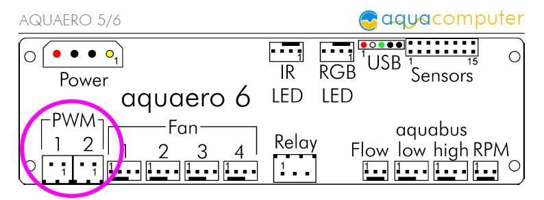

Another question is, what are the outputs of the two, 2-pin, PWM ports on the aquaero 6 for? Are they for PWM control only?
The manual states:
4.4. Connector “PWM 1/2”
   Pulse width modulated 12 V outputs, maximum current load 1 A, carrier frequency 15 kHz.
   Pin assignment: Pin 1: VCC
   Pin 2: GND
Is that the same signal the fans send out if they are set to PWM?

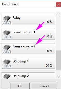

And are the aquaero controller Data source 'Power output 1' & 'Power output 2' the way to control those two PWM ports?
Could I drive a Swiftech 8 way spiltter with one PWM port using a 2-pin cable, as long as power is also provided to the splitter?

No no no nope nada hold up there cowboy.
Deff don't do that.
The twin PWM ports are 12V power outlets. The 12V is modulated at 15kHz to provide the equivalent of voltage reduction. It is the same as some low cost fan controllers use like the cheap Lamptrons. Only without the RPM functions of a fan controller.
You could use the ports to control fans but you would connect the + & - wires, not the PWM line.
PWM fans use constant 12V fit power and are controlled using a 5V modulated signal from the controller through the PWM line to a motor speed controller built into each fan.
So they are very different things and trying to use one on the other will cause damage.
The 12V ports are primarily designed for connecting LED strips to and they work great with dimmable models.
