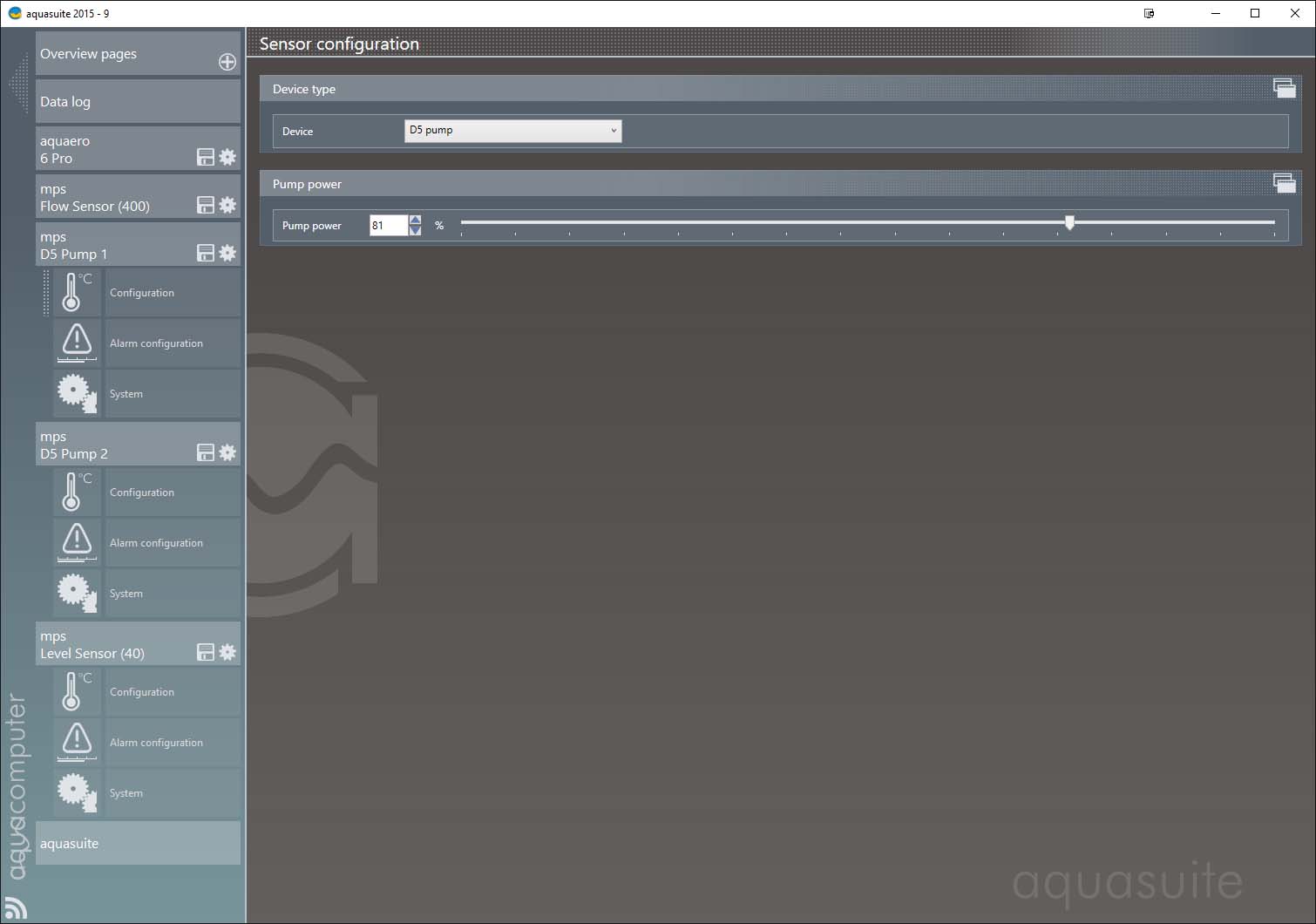

The two D5 Pumps can be configured and controlled from a USB only connection in aquasuite, including setting alarms.

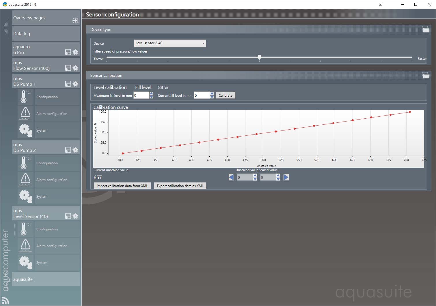

The two Fill Level Sensors can be configured and calibrated from a USB only connection in aquasuite. including setting alarms.
