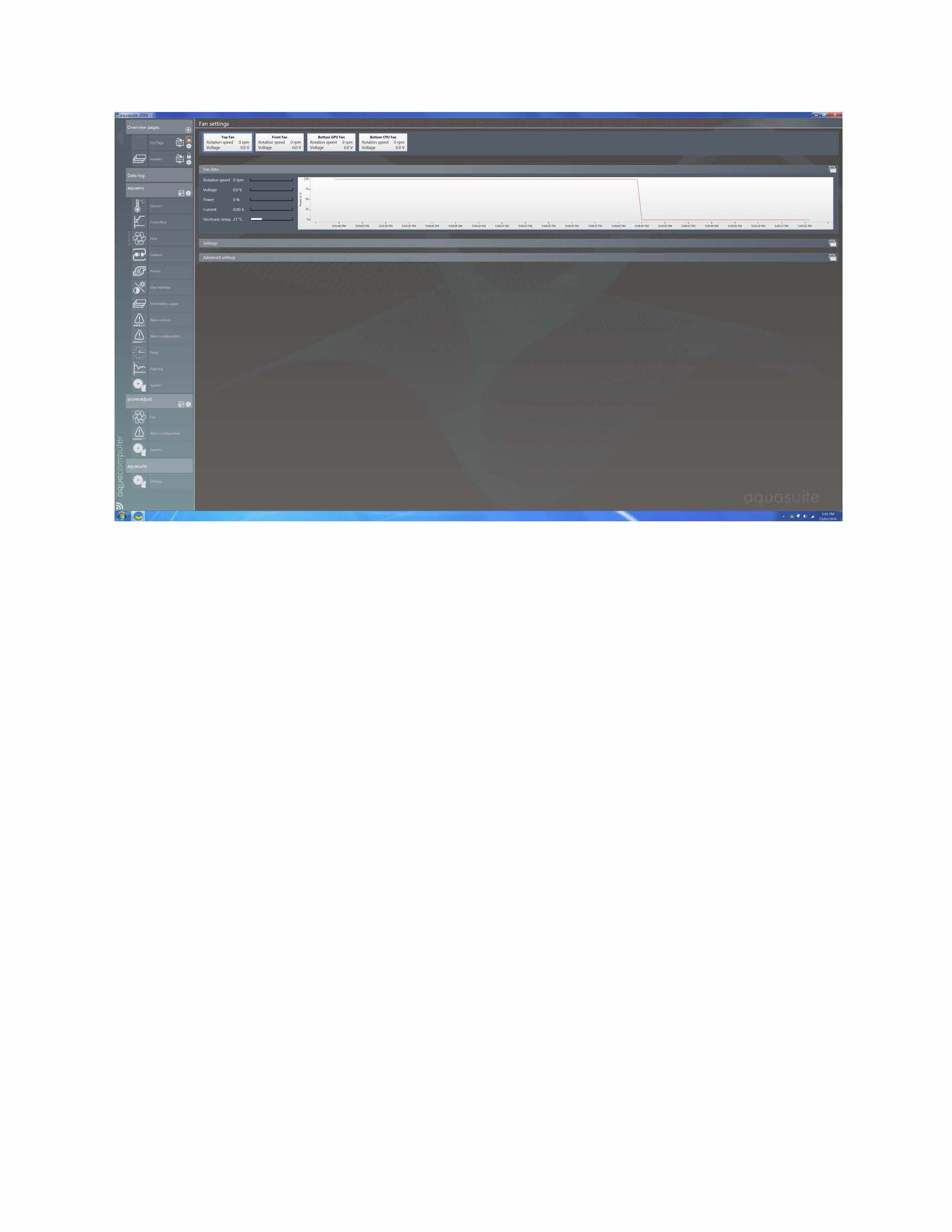

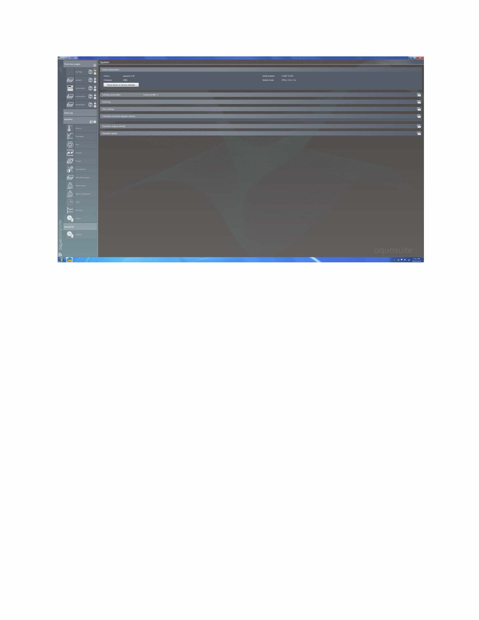

OK here are attachments, that's the only way I could upload them. I have try saving settings but no go.
This is by far the longest I ever spend on trying to configuring either software or hardware on my PC :(
  • Device ID 50_.jpg (215,53 kB - 175 mal heruntergeladen - zuletzt: 2. Oktober 2026, 19:08)
  • With USB_.jpg (217,48 kB - 141 mal heruntergeladen - zuletzt: 3. Oktober 2026, 07:12)
  • Without USB_!.jpg (217,28 kB - 167 mal heruntergeladen - zuletzt: 3. Oktober 2026, 08:48)
Dieser Beitrag wurde bereits 2 mal editiert, zuletzt von »Dundys« (26. Februar 2016, 00:05)

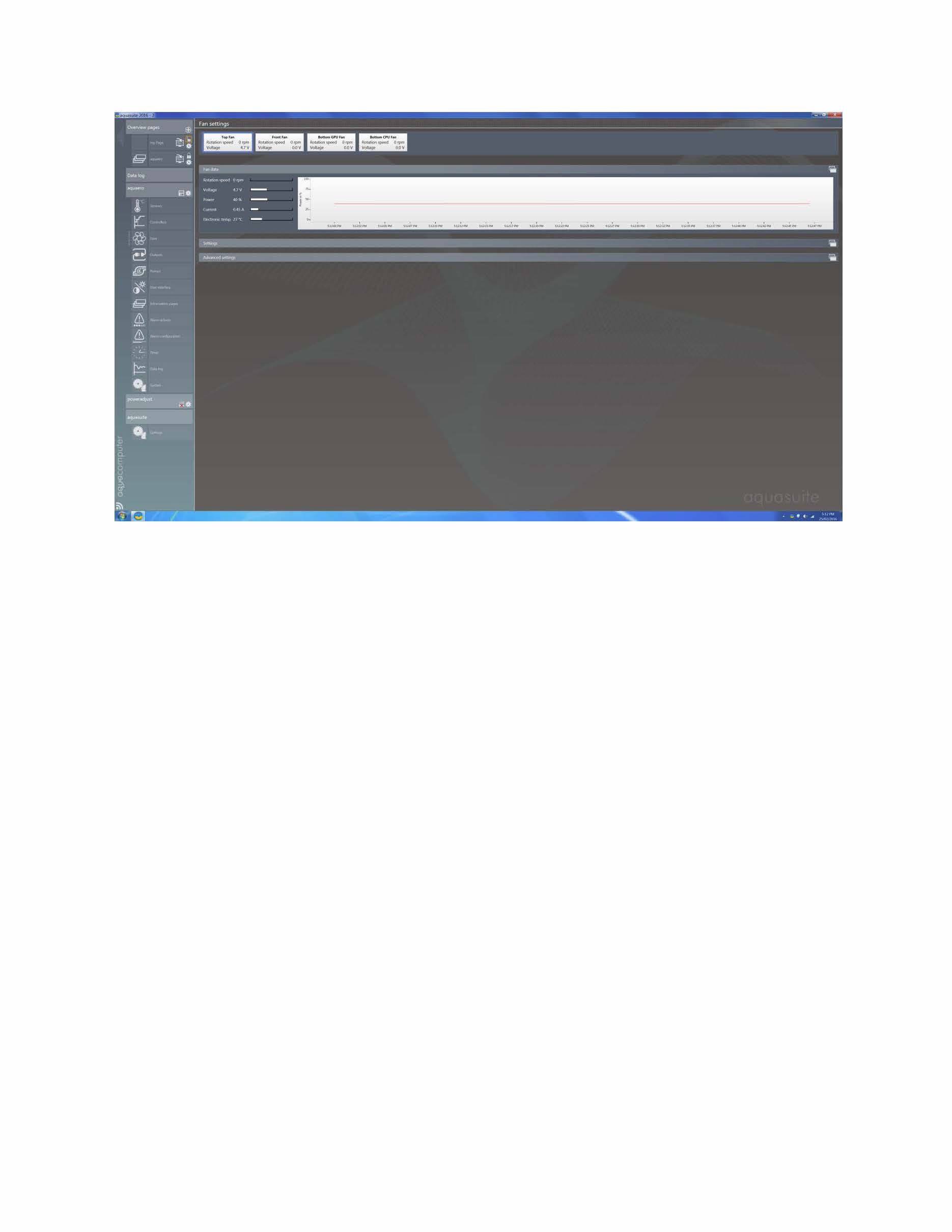

Dundys
Freitag, 26. Februar 2016, 16:01
OK sorry for taking that long.
I hope you can see the images and what they represent I have named them. Basically If I use 4pin cable directly to PA3 from aquaero it works as showing and it shows different ID from the other PA3 under devices.
If I use the 4pin cable to connect to splitter and than connect PA3 to that splitter with 3pin cable its not showing, if I connect 4pin cable again directly to the PA3 and try to daisy chain from that PA3 with supplied or my own 3pin cable them they are not showing at all.
Thank you
Dieser Beitrag wurde bereits 1 mal editiert, zuletzt von »Dundys« (26. Februar 2016, 16:09)

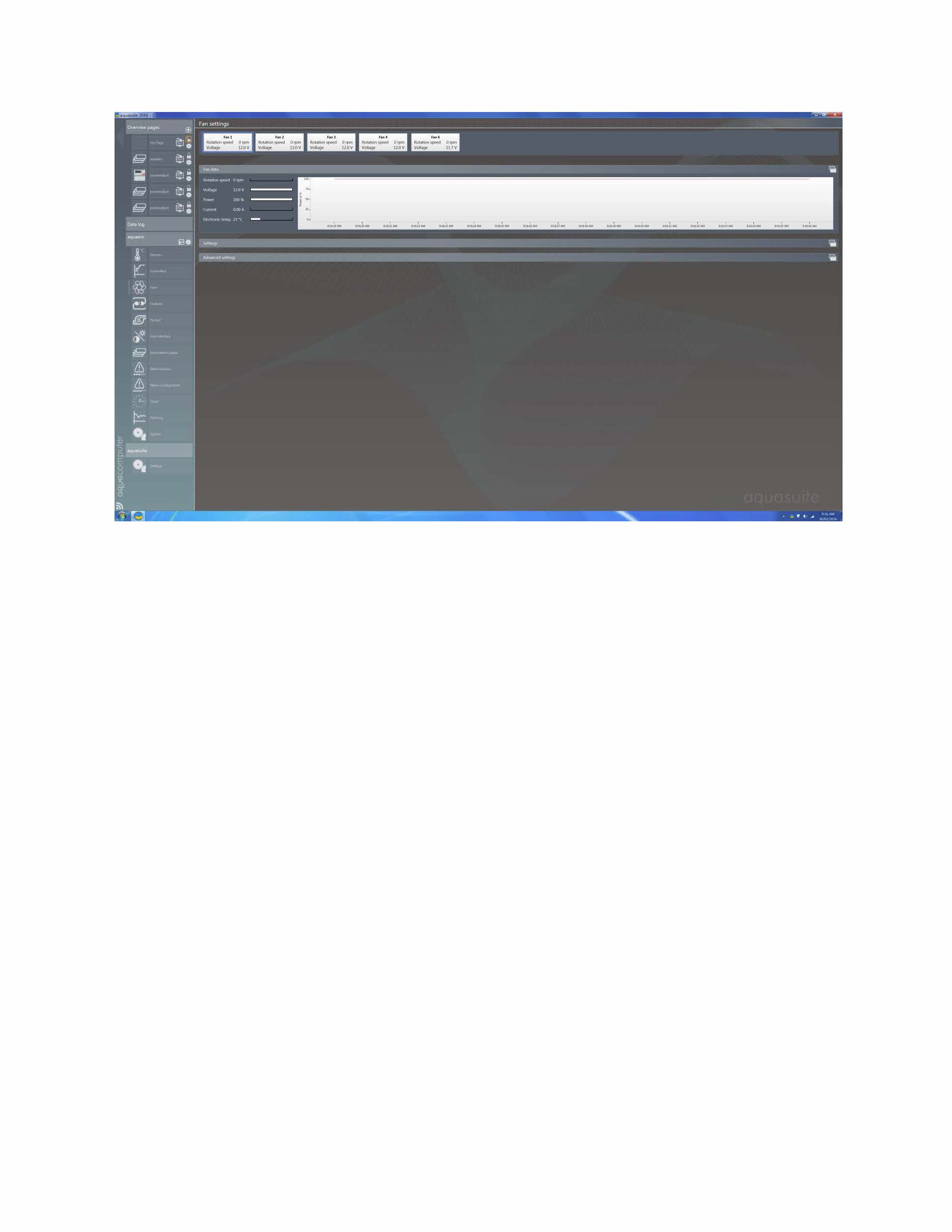

Dundys
Freitag, 26. Februar 2016, 17:19
Well, Its finally done and I can say it all works as it should.
For minute I was second guessing myself. I'm not an expert by any stretch of imagination, but I figure, this should not be a rocket science unless I'm really not grasping simple procedure.
I have a few of aquacomputer cables and some of my old cables that I did for my system, maybe year ago that I forgot about.
I connected one of my old cables (3pin) boom, it works I use 2 more of them (3pin) daisy chain the 2x PA3 and all works great.
Man, all this time, all the harassing email to shoggy which btw. he was very helpful, but I guess if you not in front of someone's PC, you can only do so much.
Thank you Railgun, you have been good member, you have made great effort to try to help I will always remember that.
Thank you
