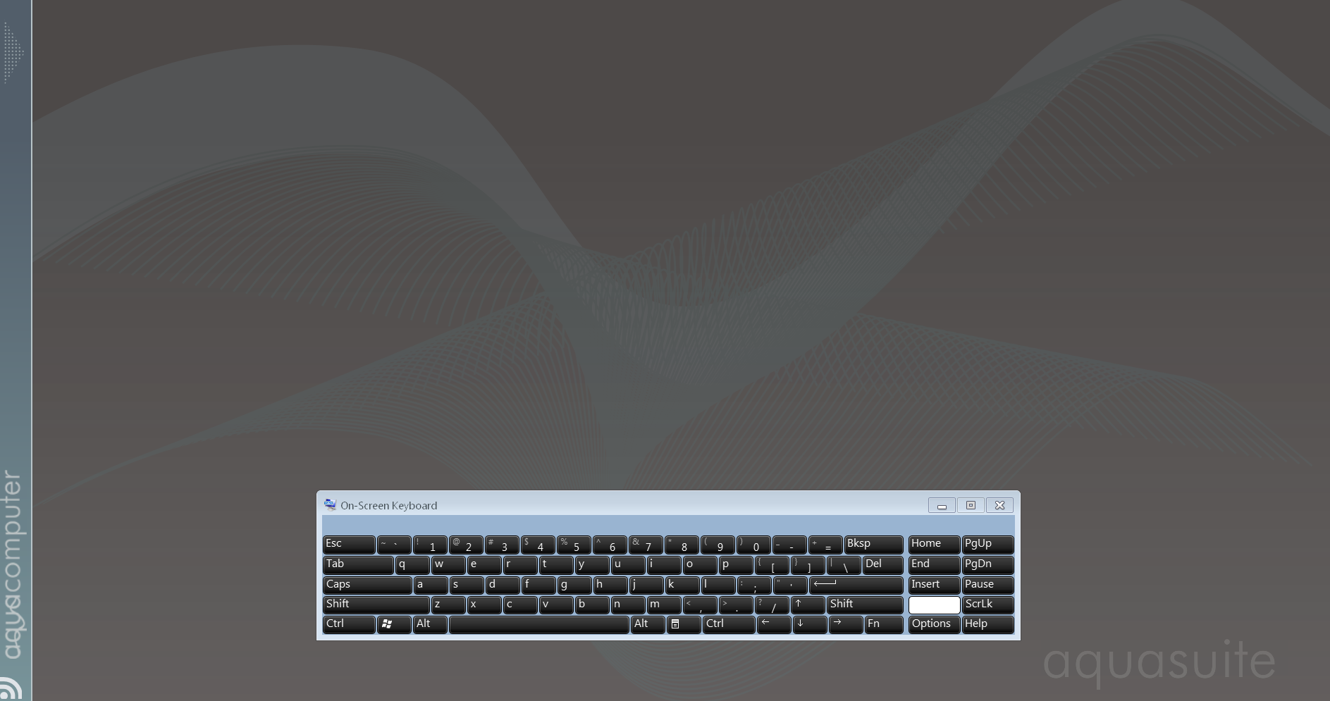

Maybe if you posted a screenshot of what it is you are dragging, and also one of the page where you are clicking the top left arrow.

heres the screen,i didnt have to drag it before,it would open from my secondary screen on boot.
»barfly« hat folgendes Bild angehängt:

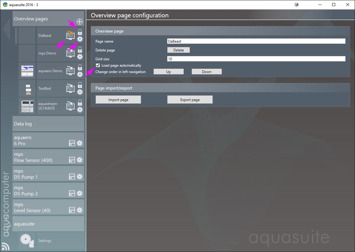

To load a particular page at startup, you can instruct aquasuite to do so:
- select the Overview page tab you want to load on startup,
- click on the gear icon and check "Load page automatically"
Then if you want that page to display on the desktop, click on the monitor-w/arrow icon and aquasuite will place the display on your desktop as per your design.
The Lock icon must be locked.
