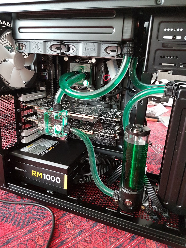

Hi watercooling expert, i am having a weird problem with my brand new Aquacomputer Aquastream ultimate
https://www.techbay.no/product.html/aqua…?category_id=75
My setup is :
i7 5930k EK waterblock installed
2x 980ti EK waterblock installed
Aquacomputer aquainlet pro 150ml
2x 240 radiators 60mm
Using also Aqua computer liquide, green
Please see attachment for pc setup, this picture was taking when i was trying to get all
the bubbles out, its fully assembled now.

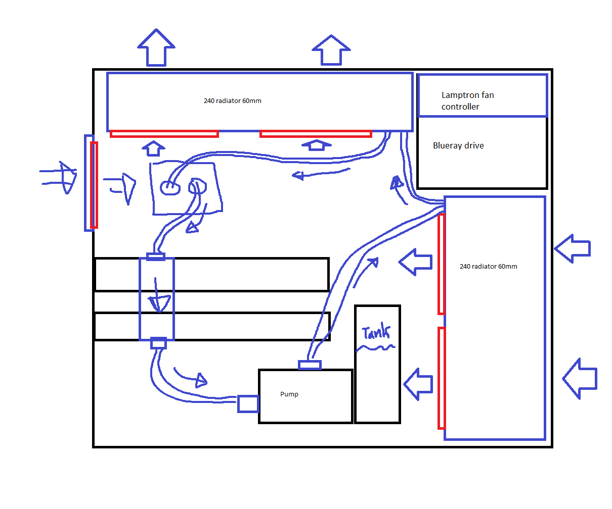

I am suspecting these things are causing issues:
1: My airflow is tottaly wrong, please see attached picture showing how its setup right now.
Maybe you guys can give me advice on how to redo the airflow ??
2: I am running high pressure fans, but only at 1170 rpm, so the CMF might be alot lower..maybe i need to increase the rmp
3: My front radiator has lot of restriction, it got a door and a dust filter infront...that might cause bad airflow and increase case temprature ??
I just ordered 5 Gentle Thypoon fans rated at 1850, i hear they are very good and should give decent air pressure to push air true, hope to get them in a few days.
I am suspecting the front radiator is getting very very low airflow and in that sense only the top 240 radiotor is giving cooling....i hope the new fans will help with this.
And if you guys can give me some directions on airflow that would be very helpfull....right now the front radiator is pushing hot air into the case, and the top radiator is pulling that air
and shooting it up the top radiator.
I hope i can solve this problem, i spend way to much on this to just sit there not being able to game on it :/

Ok so you were implying to your CPU and GPU temps which aren't bad at all. Have a look at your water temp and flow if possible through your pumps display.
Those fans will do you justice. They are the best rad fans out there. If you want to play with the RPM, you can once you get the GTs in and see what's your best temps and noise setting.
As for air flow configuration, have the front as intake and top and rear as exhaust.
For water flow, you look fine with that as long as you have 1.0-1.5 GPM is the sweet spot.

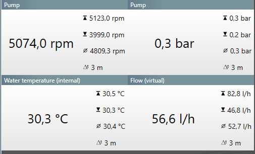

Connect the pump via USB and check your setup via aquasuite.

1: Front radiator is now pushing out air, top radiator is pushing air out, 2 fans on each rad....other then that no other fans are present.
Fans are running at 1200 RMP right now
With the pump running at max speed (6000) RPM it only manages 57-58 liters pr hour, so in terms of gallons that is extremly low flow, not sure why this is.
I have 2 coolgate g2 65mm rads, 2 GPU blocks from EK and waterblock is also from EK
Maybe i have installed the cpu block the wrong way,,,maybe used wrong jet blade ? But will that had such a drastic change in waterflow !!
I suspect when i get my new fans and also add an extra fan to pull inn fresh air i should be able to lower the water temprature closer to 40 maybe.
The room ambiant temprature is at 27c
This is what the aquasuite is telling me, flow is a sad story and then water tempratue is now at 30.1 at idle.
I will report back once i get my fans in the mail, will also try to dissaemble the cpu block and double check if everything is right there

Again, most setups are front + bottom as intakes and top + rear/back as exhaust. In different situations and in massive cases with everything filtered but the back, I have everything as intake except the rear/back which is set up as exhaust.
In your case now you have too much negative pressure. Front bottom intake and top rear as exhaust or all intake except the back. Test both ways and you'll find the right one you'll like.
As for the jet plate, yes it can impede your flow if installed the wrong way or something else is the problem. Hope its not funky color fluids you're using either and you do annual maintenance to the loop.

Are you sure that the system is completely bleed of any air in the radiators and Blocks? Because it looks like there is still some air in your tubing.
Alle Angaben ohne Gewähr :D
servercookie
Sonntag, 12. Juni 2016, 15:18
Yeah there are still quite a bit of bubbles in the tubing and especiall in the GPU blocks, i have been shaving and moving the case for hours but the GPU blocks still got pleanty of air bubbles.
After shacking it for half a day and leaving the pumps run at different speeds with the case standing and laying down, i gave up.
I am guessing the bubbles will work themself out after a bit ?
