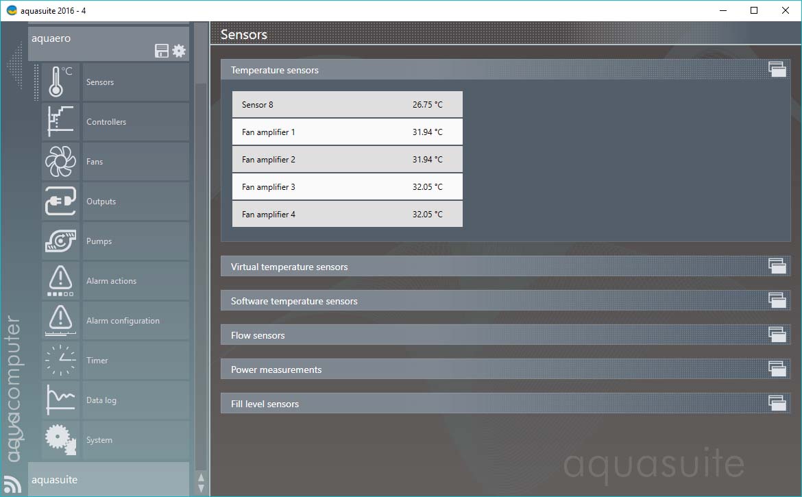

I had a lightning strike kill bits and pieces of my PC recently, and I am in recovery mode atm.
I have the aquaero 6 connect by USB only to my backup system and can see 4 Fan Amplifiers and 1 test sensor connected.
I also connected the RGB LED to the RGB port, but nothing is happening. I guess the RGB port require the 12V input.
Are their any exercises/tests I can do to further confirm the unit's status?
[attach]5744[/attach]
Tell us what exactly is connected and than tells us if its showing or not. Having trouble understanding if you have it all working or not.

The aq6 is currently removed from the damaged system, and I have it connected by USB to the backup system. I have one temp sensor connected.
The temperature sensor section appears to function, but I cannot really test the unit without having it connected in a system, which I cannot do atm.
I was wondering if aquacomputer had an unpublished, built-in self-test routine that I could activate.
Or if there is some test I can perform that would yield a high level of reliability that the unit is working properly.
Maybe just having the temp sensors working indicates the rest of the unit is functional.

The most of the data lines are secured with an additional 30KV ESD protection. When the fan outputs are running i think the device is ok.

OK, I will see to set it up so I can control a fan or 2. Thank you.

Yay for me! I was able to modulate a fan with all four fan ports :)
