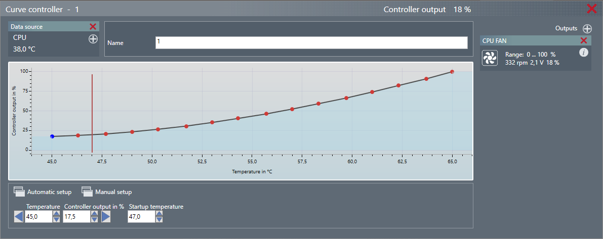

The CPU fan and CPU software sensor (from aida) is assigned to "curve" controller.

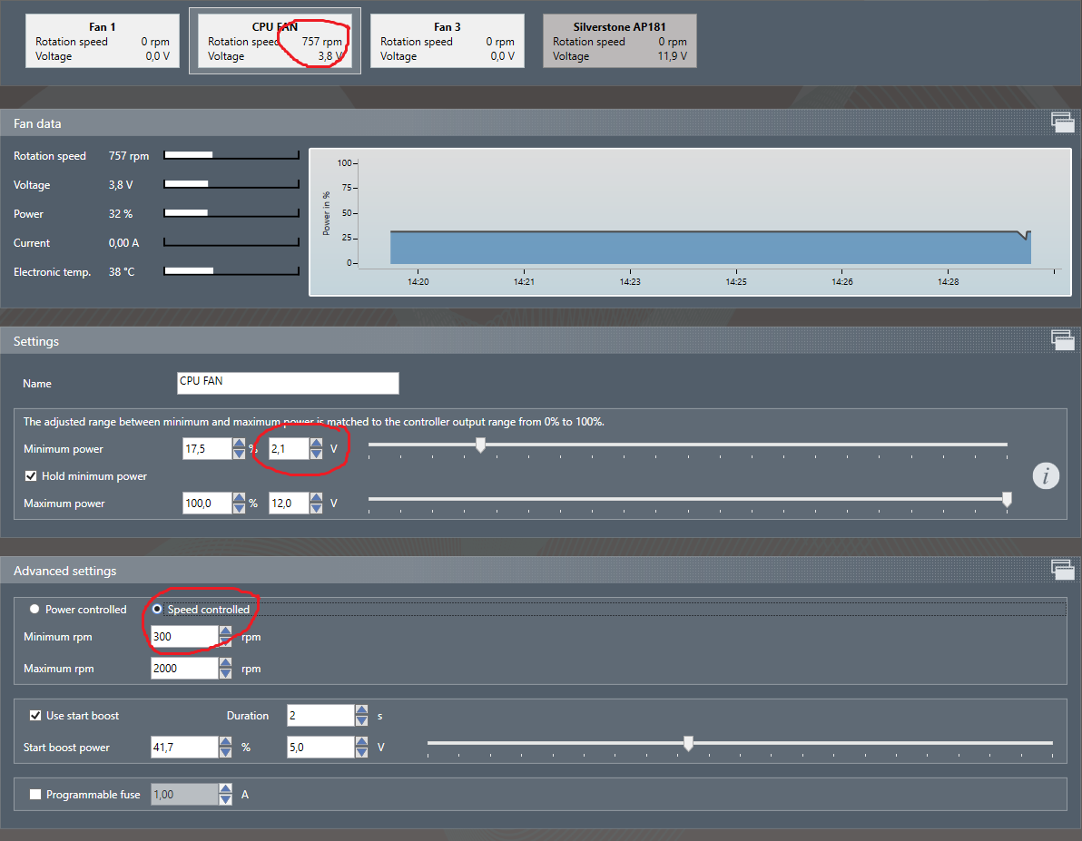

At the "Fans" page the CPU fan is adjusted to "hold minimum power" at 2.1V, and Speed controlled is set to 300 as minimum rpm. All worked ideally.
After updating to aquasuite 2016-5.3, the CPU fan has increasing its rpm and its voltage increasing. After a few experiments with settings, I found that:
1. setting "minimum power" now is working incorrectly (even with clear checkbox "hold minimum power"), it is summed up to the current voltage value by some unknown formula, instead of being as minimum value.
2. setting "Speed controlled" now is working incorrectly with minimum rpm, it is summed up to the current rpm value by some unknown formula, instead of being as minimum value.

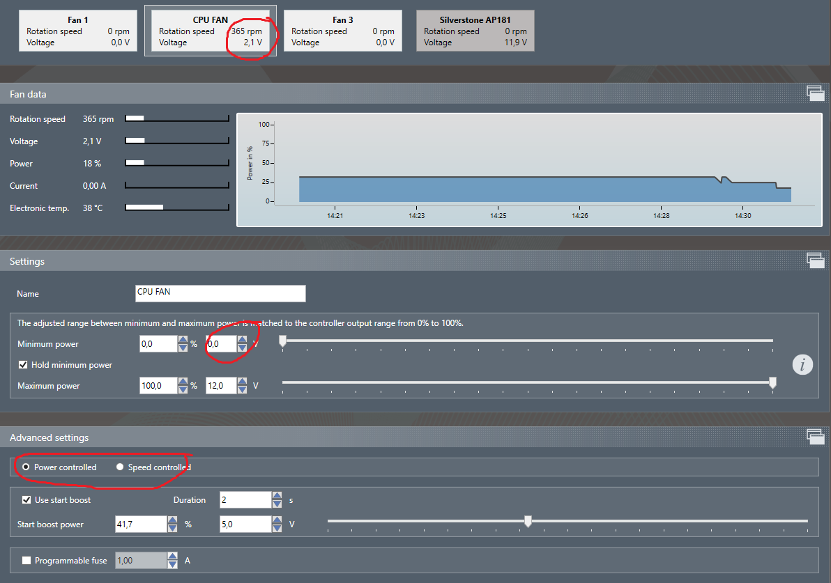

For adequate fan control, I had to set a minimum power to zero, and set "Power controlled" instead "speed controlled".
I reboot PC, reset device to factory defaults, power off device and even trying aquasuite with another PC.
Setting "minimum power" and "Speed controlled" now is working INCORRECTLY.
Wait your comments about to fix this or how can I downgrade to old aquasuite/firmware version.

I am not sure I fully understand the issue, but let me make a couple comments.
  • The curve controller you show appears to be working as you have it set
    it starts at 45C and the source is at 38C, so the controller is not active
    but you are seeing the 2.1V minimum set to the fan

About your first comment: you are right in everything except "controller is not active". Controller at temperature below minimum is setting voltage value corresponding to the minimum temperature point in curve line. In my case, voltage at temperature 38C is corresponding to 45C and voltage must be 17,5% = 2.1V. And it is 2.1V as must be.

At 38C, the voltage is 2.1V (RPM=330), and when I set minimum power to 2.1V, the voltage grows to 3.8V as shown in second picture. After setting "minimum power" to zero, the voltage decreasing to its normal 2.1V.
Also, when I set fan to "speed controlled" where the MINIMUM RPM is set to 300, the RPM grows to 570. After setting fan to "power controlled", the RPM decreasing to its normal 330.
When I said the controller was not active, I meant it was sitting at zero, which corresponds to the Minimum Power you specified in the fan profile.
ALL source temperatures below the specified Curve's low end 45C of your controller, will have the same impact on the controller, zero or the minimum you set in the fan profile.
That is what I see the controller doing in the clip you posted, so I believe it is working as designed.
As to the all the calculations you are doing, I don't understand them and will leave that to someone more versed than I.

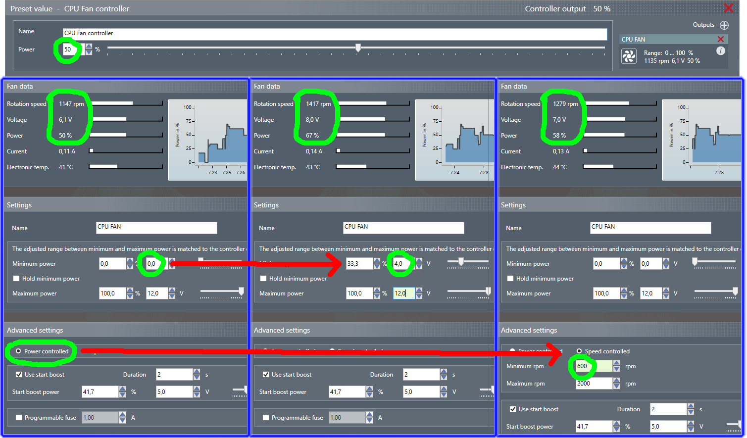

On previous firmware, nothing was changed when I set "minimum power/rmp" below current value. And after that, the current rmp/power can not be smaller than the minimum value. It works logically and I always enjoyed these settings.
Now in new firmware I create controller with "preset value" and set power to 50% ( 6V ). The fan speed is 1135 rpm.
When I set minimum power to 33% ( 4V ), the voltage grows from 6V to 8V ( from 1135 to 1417 rpm )
When I set minimum speed to 600 rpm, the rpm grows from 1135 to 1279 rpm ( from 6V to 7V )
Option "hold minimum power" is always enabled even checkbox is clear.
I do not understand how it works, and what is now means "minimum" power/rpm in CURRENT firmware.

Samstag, 14. Januar 2017, 09:46
0-12 frame 50% =6 Volt
4-12 frame 50% =4 + 4 Volt min is 8 Volt
600-2000 1/min frame 50% =700 + 600 1/min min is 1300 1/min
This has always been this way.
