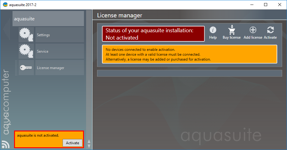

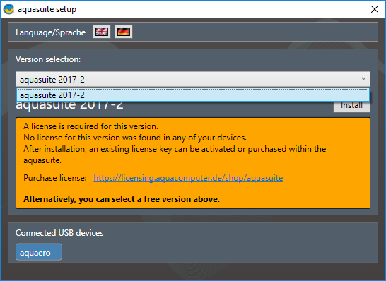

Hi, I switched from Intel Z87 (Haswell) platform to AMD X370 (Ryzen) and my Aquaero 6 is not detected as a valid Aquasuite device via. USB. The only place I can see it is in the installation screen, where it is listed as "Aquaero". It does not show up at all in Aquasuite as a device, as you can see in the below screenshots. I have a valid Aquasuite 2017 license attached to the Aquaero 6. It was working correctly on the Intel Z87 platform.

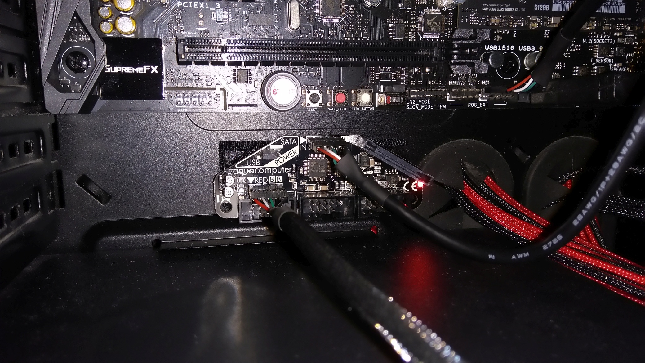

Hi, as requested I've attached a photo:
1 = USB to M/B
2 = USB to Aquaero
3 = USB Case (because I used MB USB)
4 = Make sure this jumper is in the correct position for either USB power or SATA power
https://docs.google.com/uc?id=1IkDwVd3gP…Ws-cgNHkWTEfSyg

I have tested all ports on the Hubby 7, 1-7 now, and none of them pick up my Aquaero 6 Pro in Aquasuite either with SATA or USB power. Video to prove it here: https://www.youtube.com/watch?v=UtfaJHVuWTE&feature=youtu.be
Photo attached to show it's installed correctly.

Strange thing is anything else I plug in to the Hubby 7 is recognised, including an Aquastream. You would think that rules out the Hubby being at fault. Take a look at the very first screenshot I attached in the original post. At the bottom you can see something called "Aquaero" is picked up in Aquasuite Installation, but it still doesn't register as a licensed device or show up in Aquasuite when it completes installation. It has a valid license and shows up correctly when plugged into the motherboard directly, however.
If this isn't a firmware issue, then perhaps it is an incompatibility problem specifically with Ryzen / AMD chipset drivers and Aquaero.
