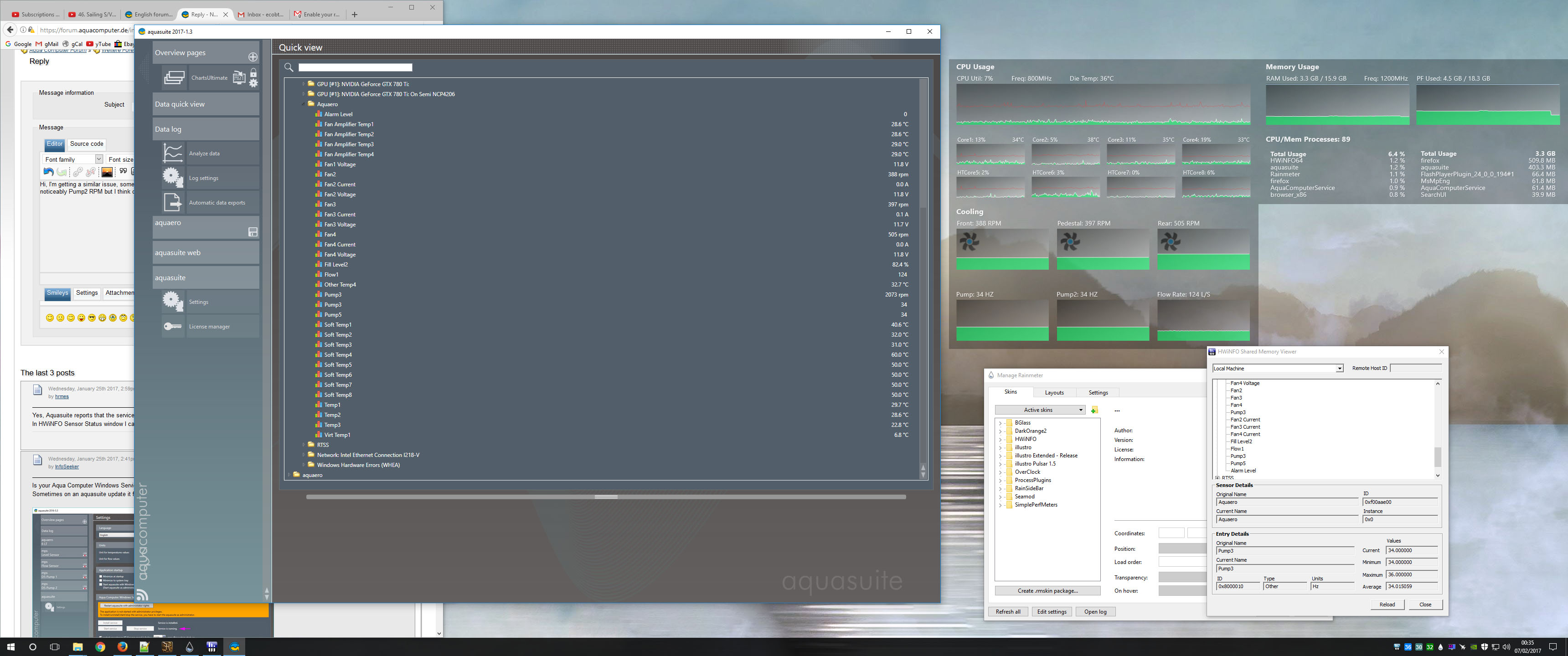

Hi, I'm getting a similar issue, some sensor info isn't going into shared memory from aquasuite and others are named incorrectly. Most noticeably Pump2 RPM but I think others are missing too.

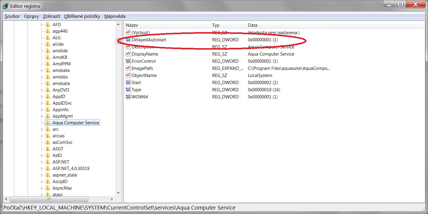

SOLVED FOR ME !!!!
Sonntag, 11. Juni 2017, 00:27
Hello All,
I solved this bad situation myself and here is the solution that has been working for me for weeks without a single problem.
It was important to understand why this is happening and then just find a solution. :D

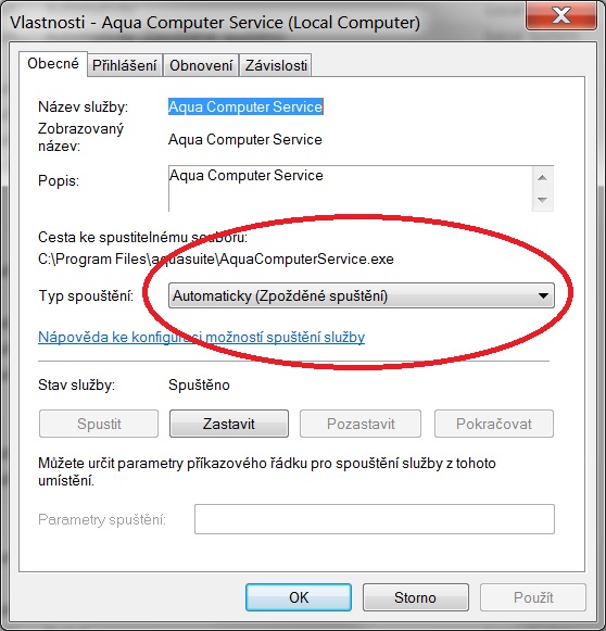

1.) Start "services" and set on Aqua Computer Service "Automatic(Delayed start)".
2.) Open "regedit".
Now you can see on HKEY_LOCAL_MACHINE\SYSTEM\CurrentControlSet\services\Aqua Computer Service : DelayedAutostart (1).

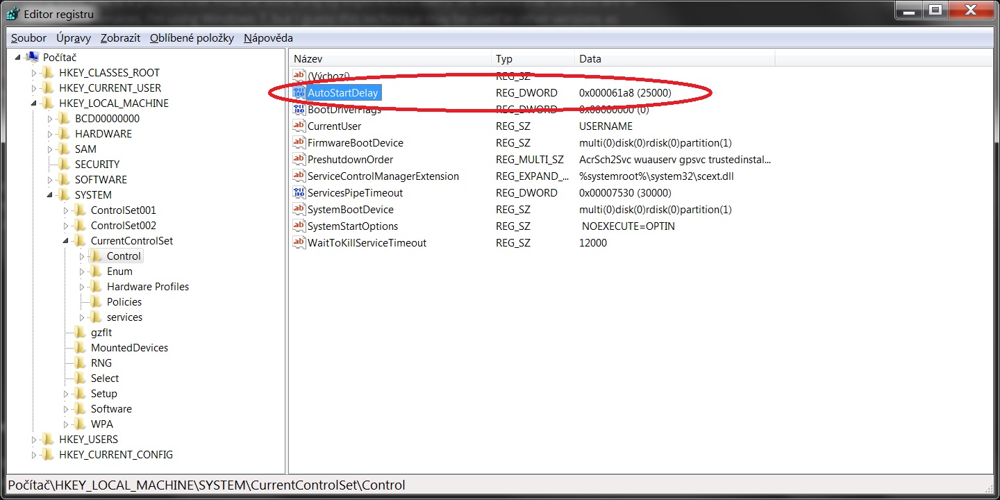

3.) Now we need shorten Delayed autostart because system basic value is 120 second.
Select HKEY_LOCAL_MACHINE\SYSTEM\CurrentControlSet\Control\ in the keys tree.

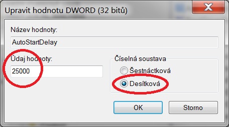

Right click the right panel -> New -> Value DWORD (32bit) , name it as "AutoStartDelay".
4.) Set AutoStartDelay value to 25 second (it is good for my system and a lot of aplication run on start of Win 7) in decimal so, 25000.
DONE.
