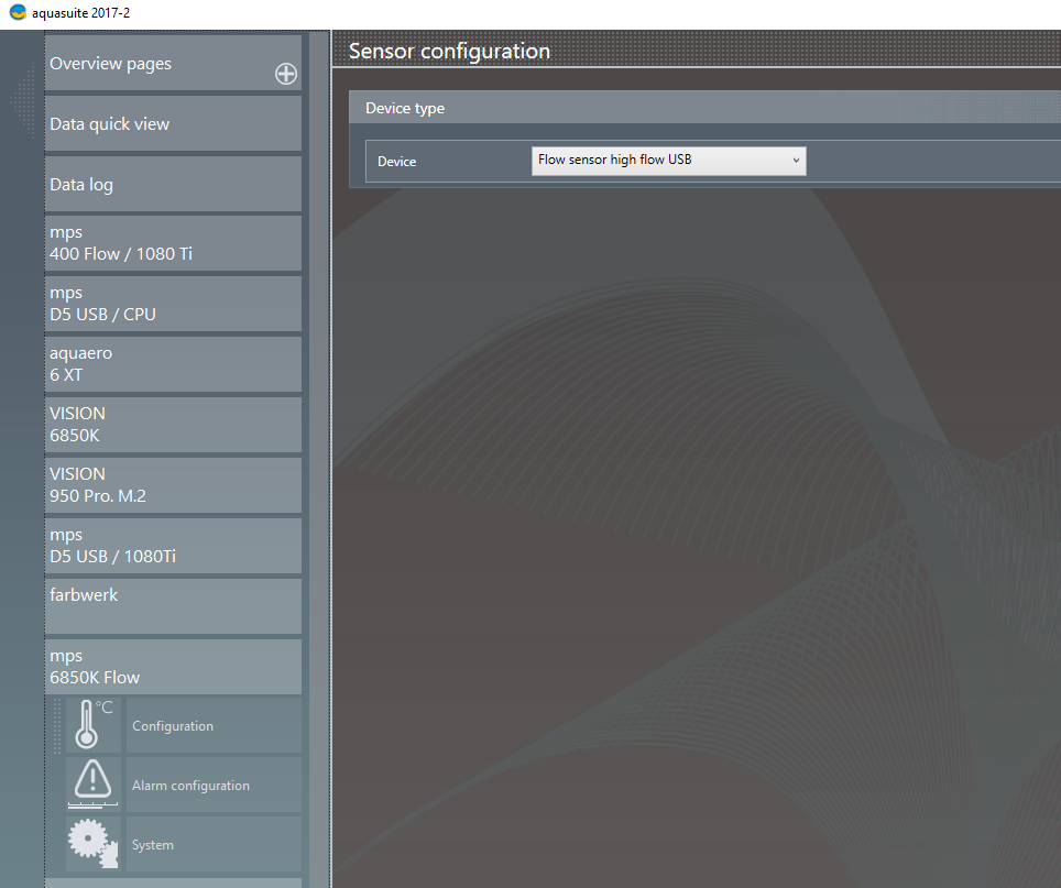

Hi Guys !
Could anyone tell me is there a software for this High Flow USB sensor
Coz this is what it shows at my Aquasuite
Thank You

How do you have that connected. It should show as a mps1 under aquabus device and than under Sensors/ flow sensors/ however you name it.
Did you allocate bus address for the flow meter
Dieser Beitrag wurde bereits 1 mal editiert, zuletzt von »Dundys« (23. Oktober 2017, 21:13)

There is everything OK. The High Flow sensor has no configuration menus in the main tab. You can see the current flow rate in the alarm configuration tab or as flow sensor X in the sensor tab if you use it together with an aquaero via aquabus.
The sensor should have also created an new overview page where you can see the flow rate. Easiest way to get it again: disconnect USB, remove the dead menu entry for the sensor and connect the sensor via USB again. It will set up the overview page automatically.

Thx Sven ^^
