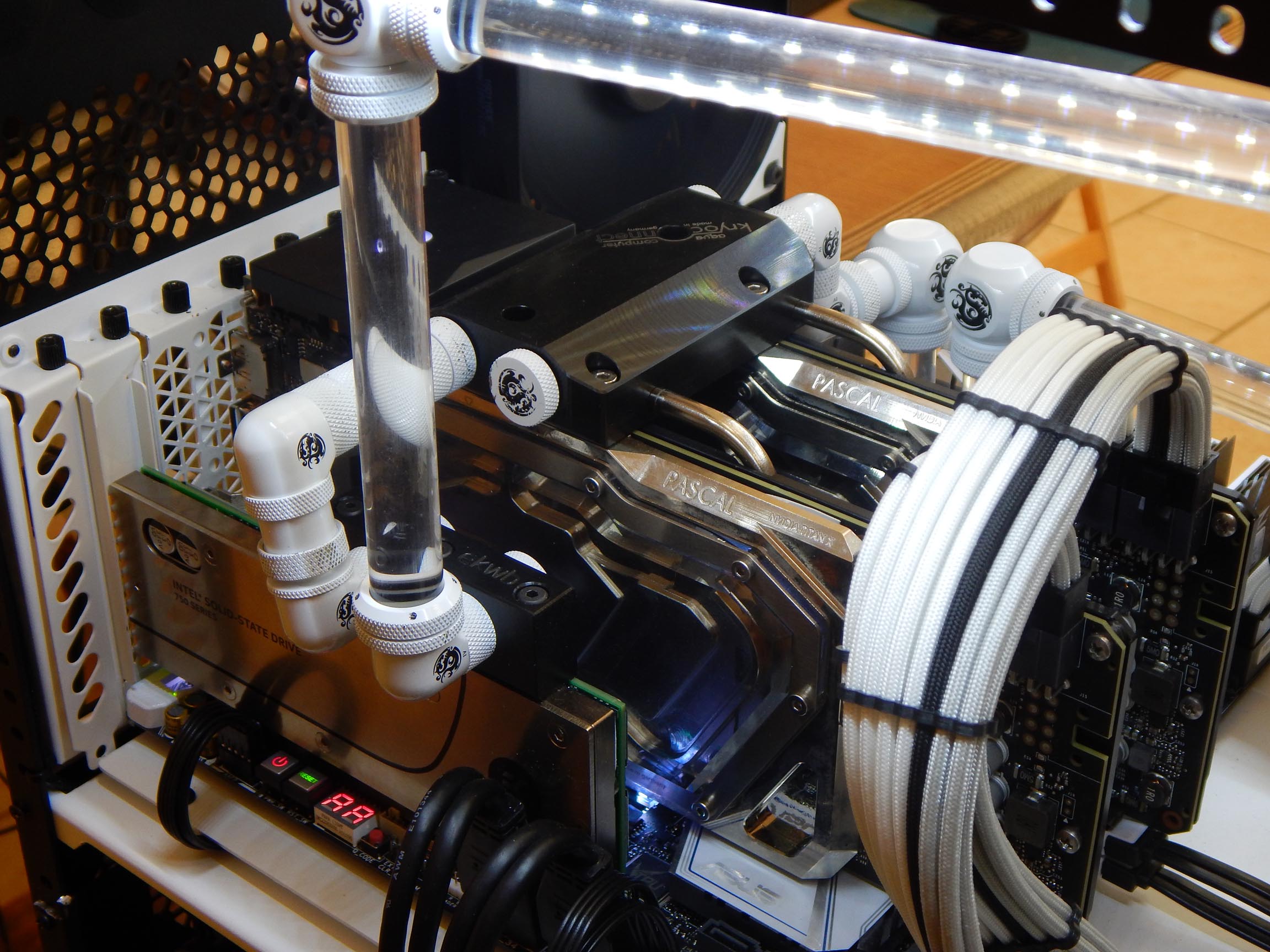

Samstag, 9. Dezember 2017, 21:19

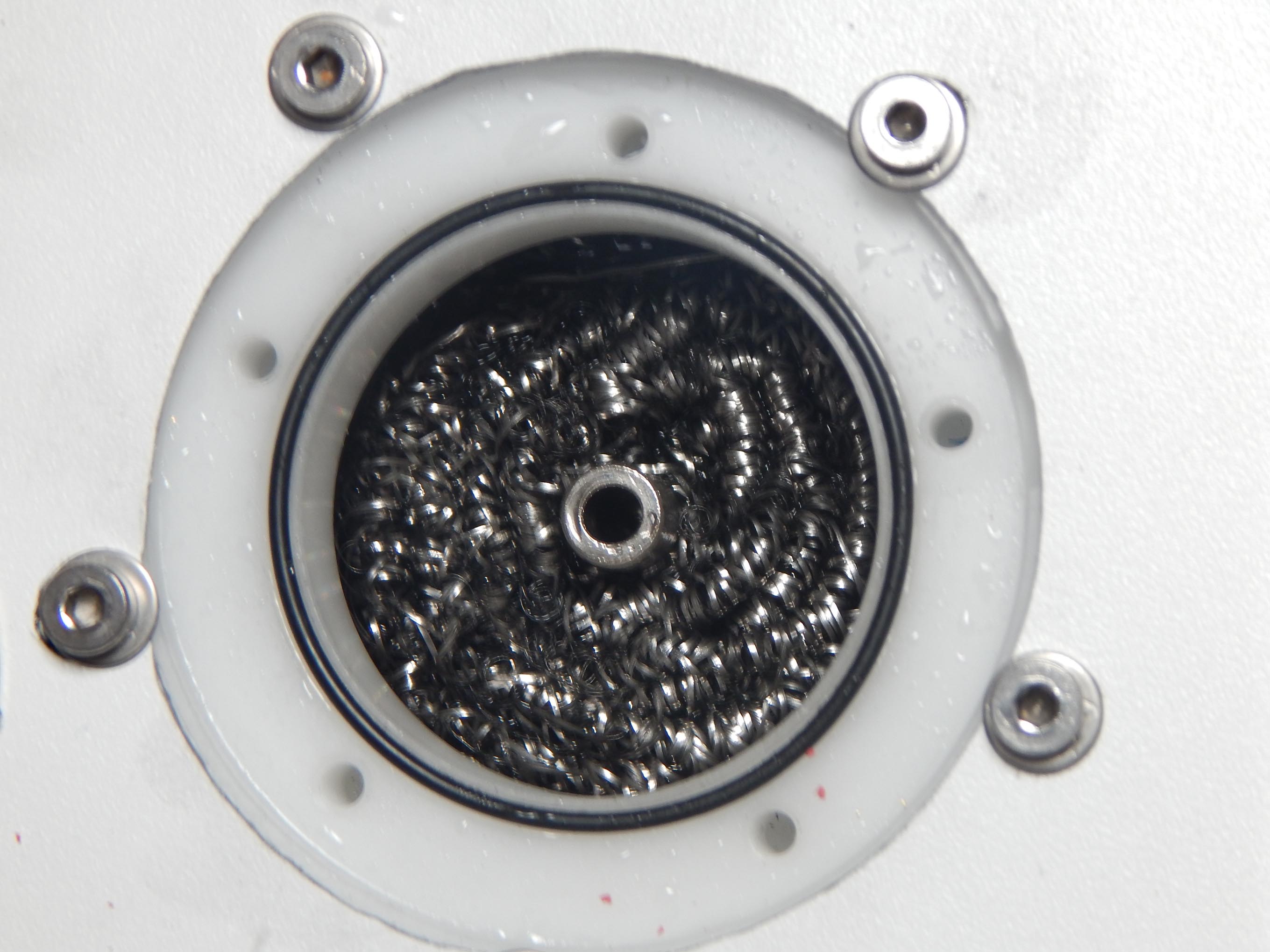

An update on my deaeration quest.

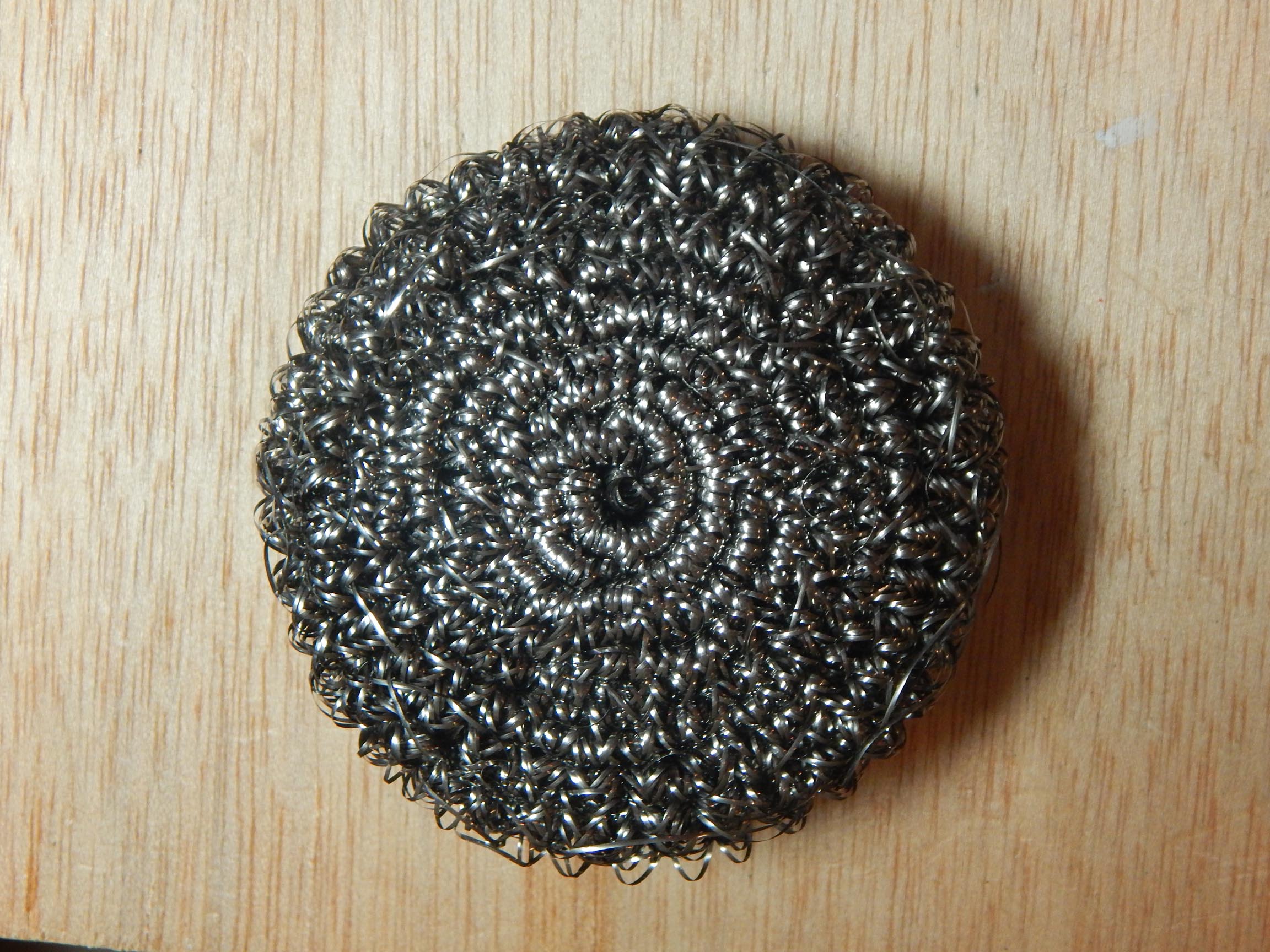

It was MUCH bigger than I anticipated, and completely filled the cavity, but I tried it anyway to see the results.
This did attenuate the vortex issue, but I still experienced micro bubbles (bubble cloud) in the coolant stream.
I assume this is from the coolant flowing across the many edges of the scrubber causing cavitation.

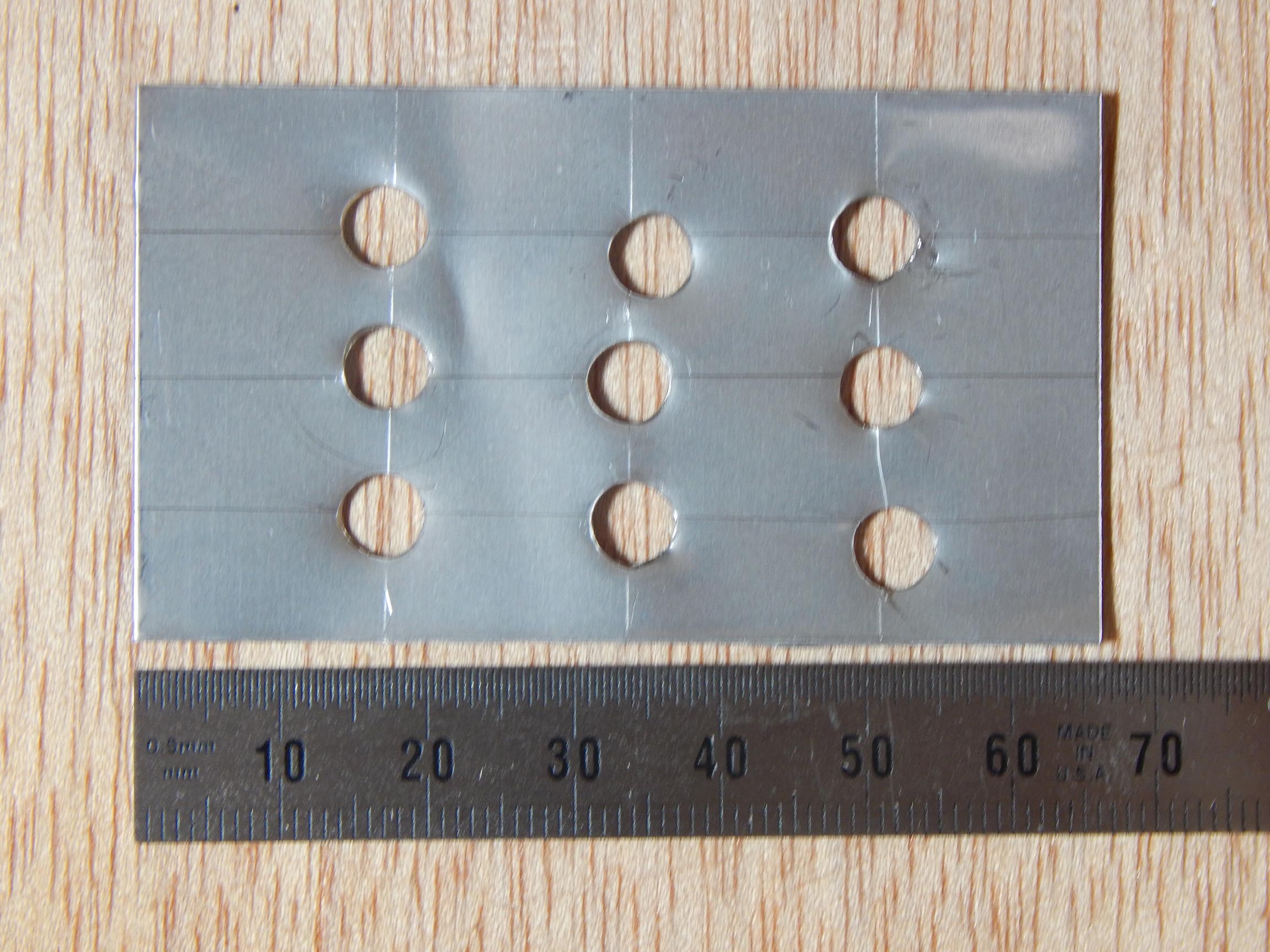

So I removed the scrubber and decided to try a 26 gauge stainless steel perforated plate SSplate.jpg
I know, I know, it looks ugly, but my drill bit was not made for stainless steel, and it dulled quickly and drifted.
Unfortunately, I still saw aeration in the coolant stream.

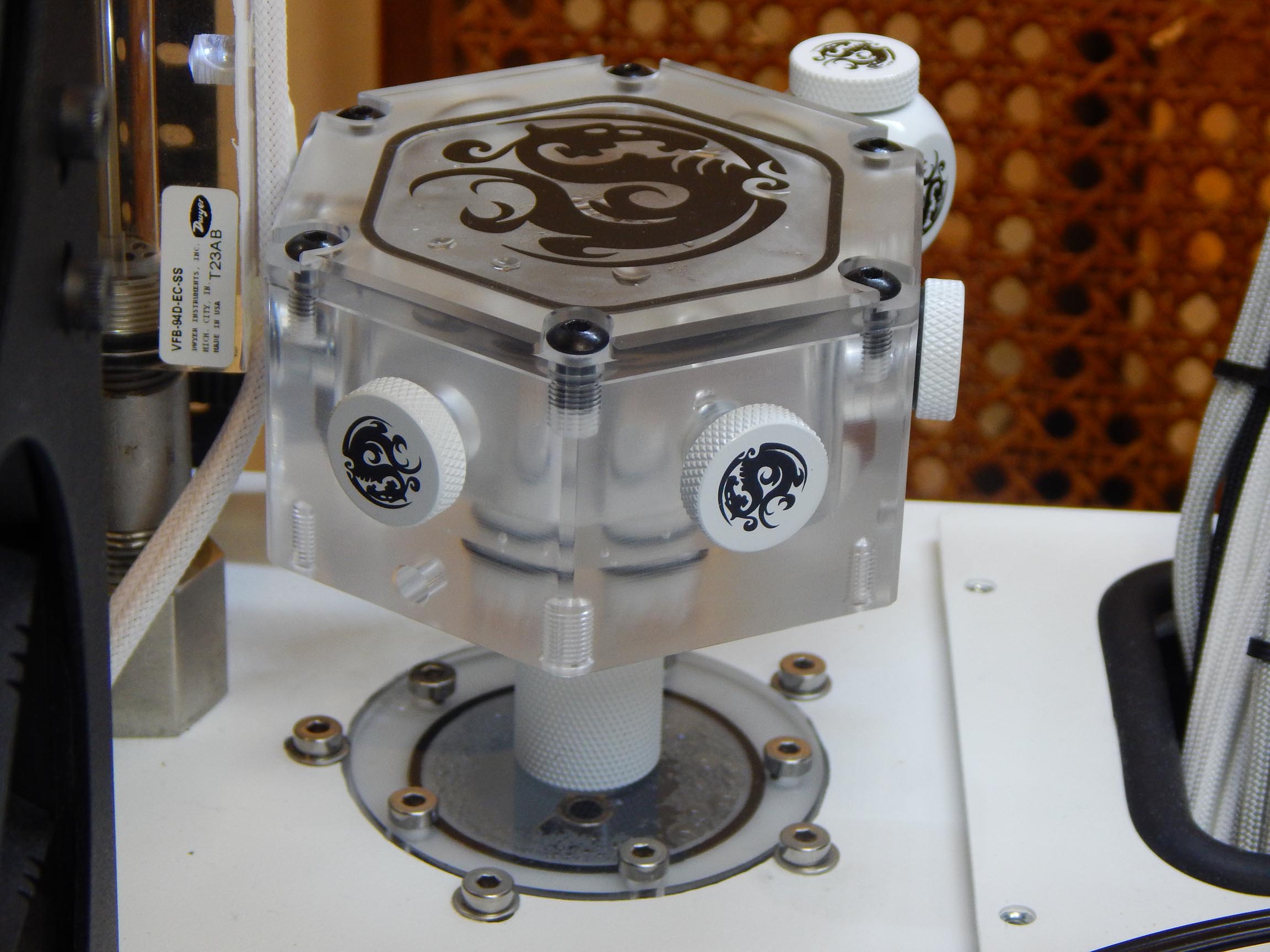

I then decided to add head pressure by extending the water column.
I left the perforated plate in believing it did no harm, and it will attenuate vortexing.

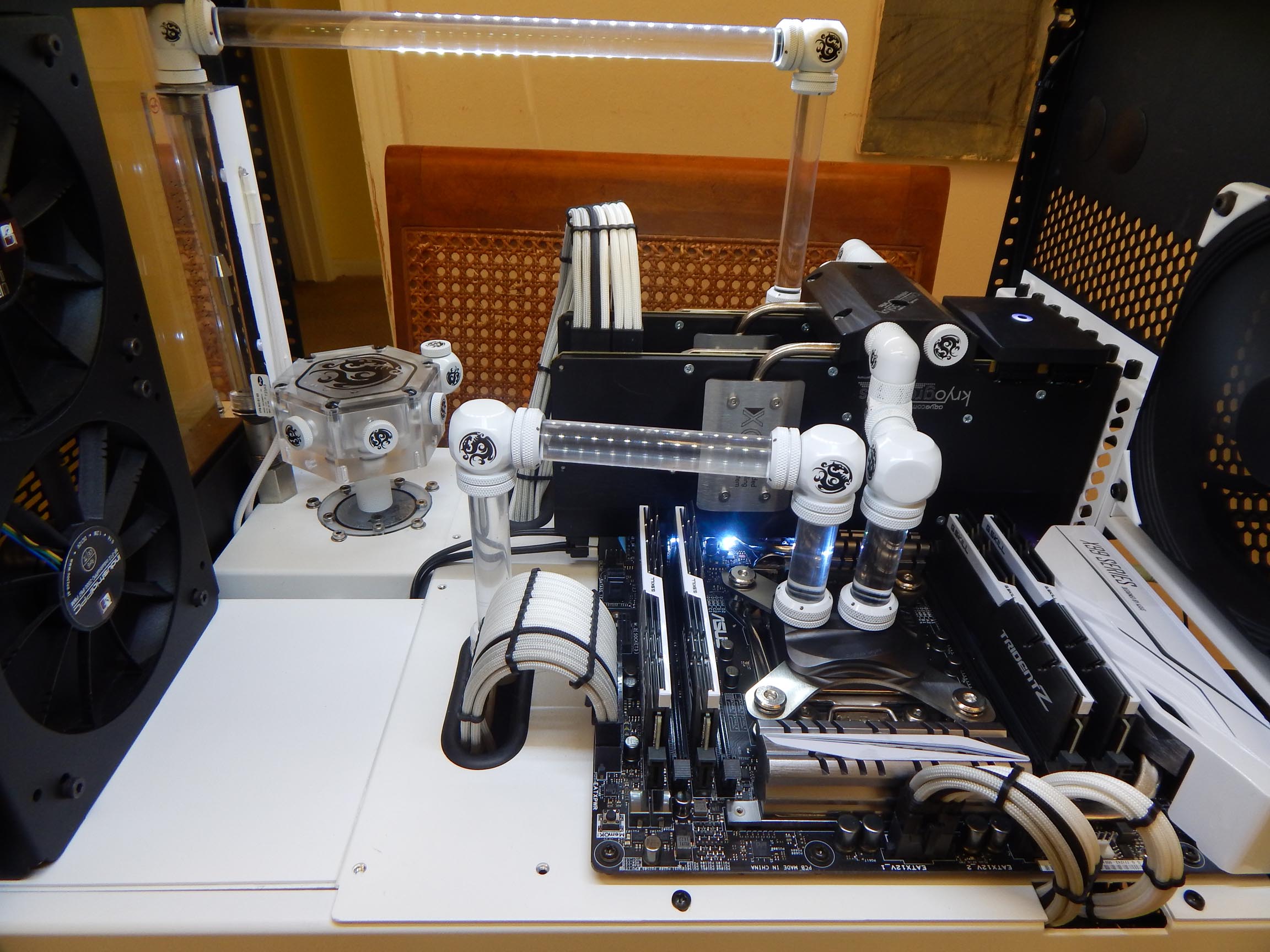

I drilled/tapped a G1/4 port in the center of the aquatube acrylic top plate, inserted a D-Plug, and added this Hex Tank on top.
The reason for the D-Plug is that space constraints do not allow rotation of the Hex Tank, and it truly simplified installation.
Some may find the hex tank ugly, but I find it unique and as such interesting.
I do have the aquatube Rinsing Device installed, so the discharge into the aquatube is just below the new port in the acrylic plate.
This causes the coolant, and any air in the stream, to be pressed into the hex tank.

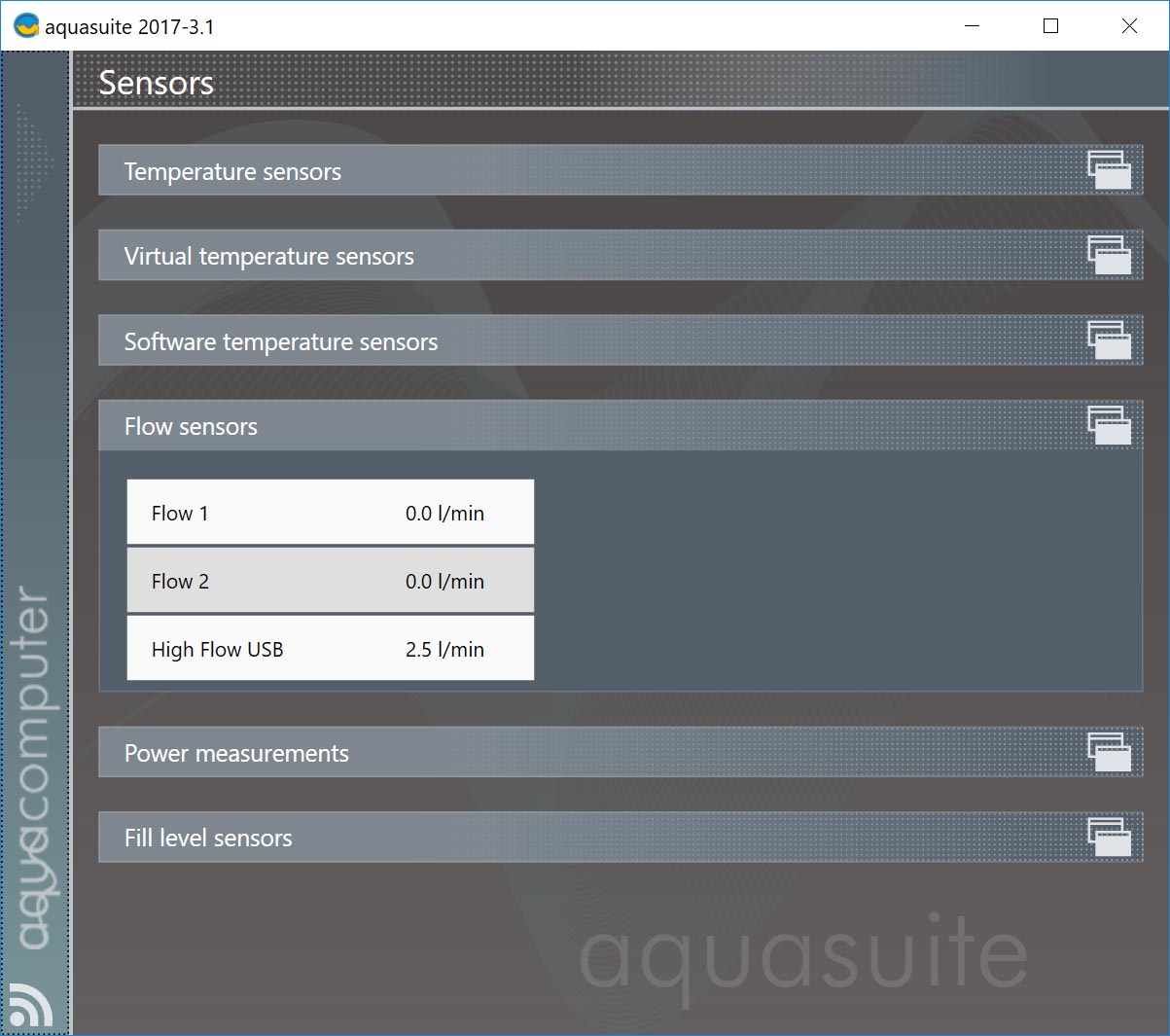

With this solution I am able to increase pump power from 50% (1.8 LPM) to 100% (2.8 LPM), with no visible aeration.
I run the system at 85% power (2.5 LPM), because I do not generally run machinery at 100%, and I am pleased with 2.5 LPM output.
The flow values above are taken form the installed High flow USB sensor .

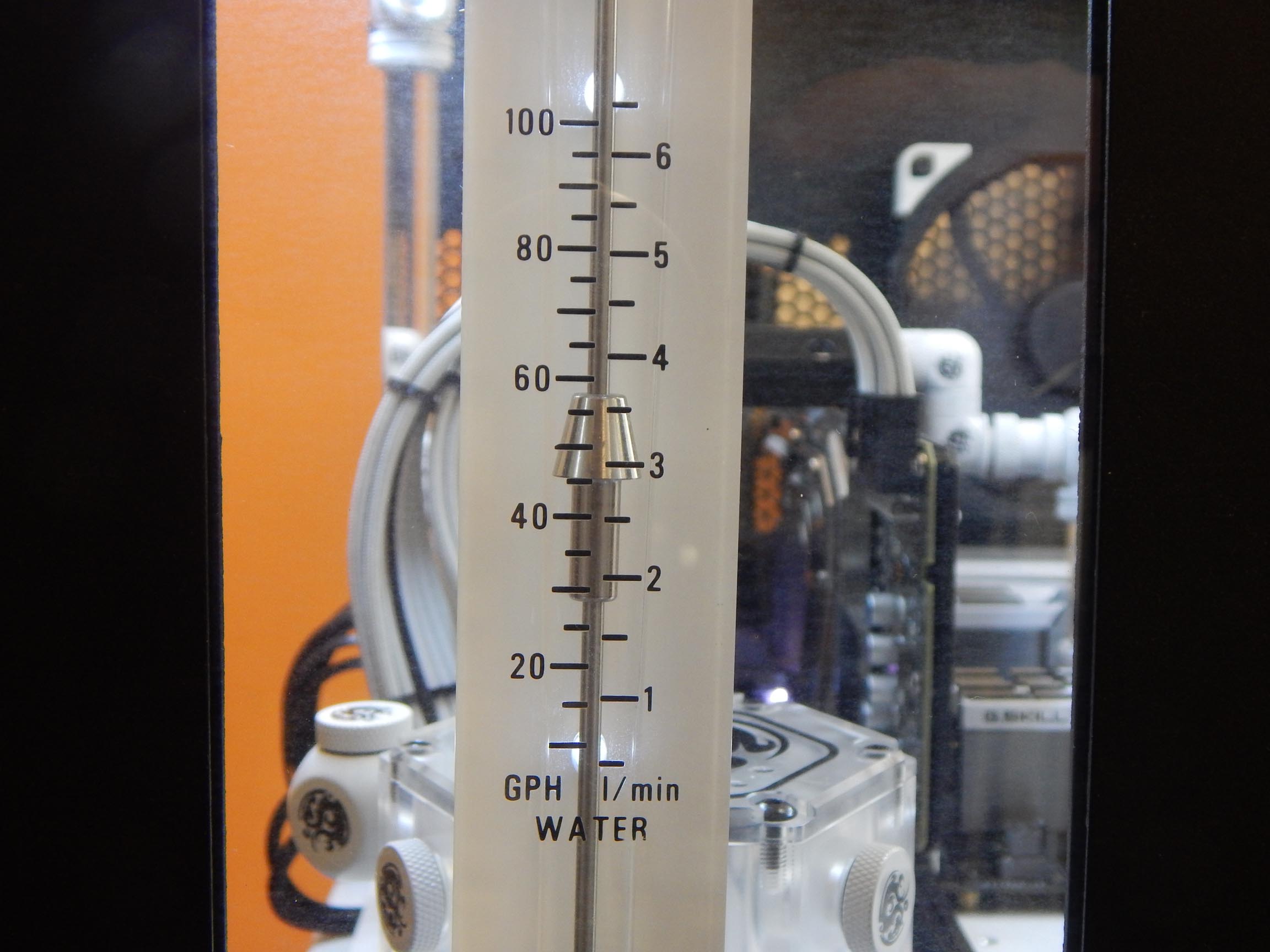

I also have a Dwyer Rotameter installed in the loop which generally reports a slightly higher flow rate.

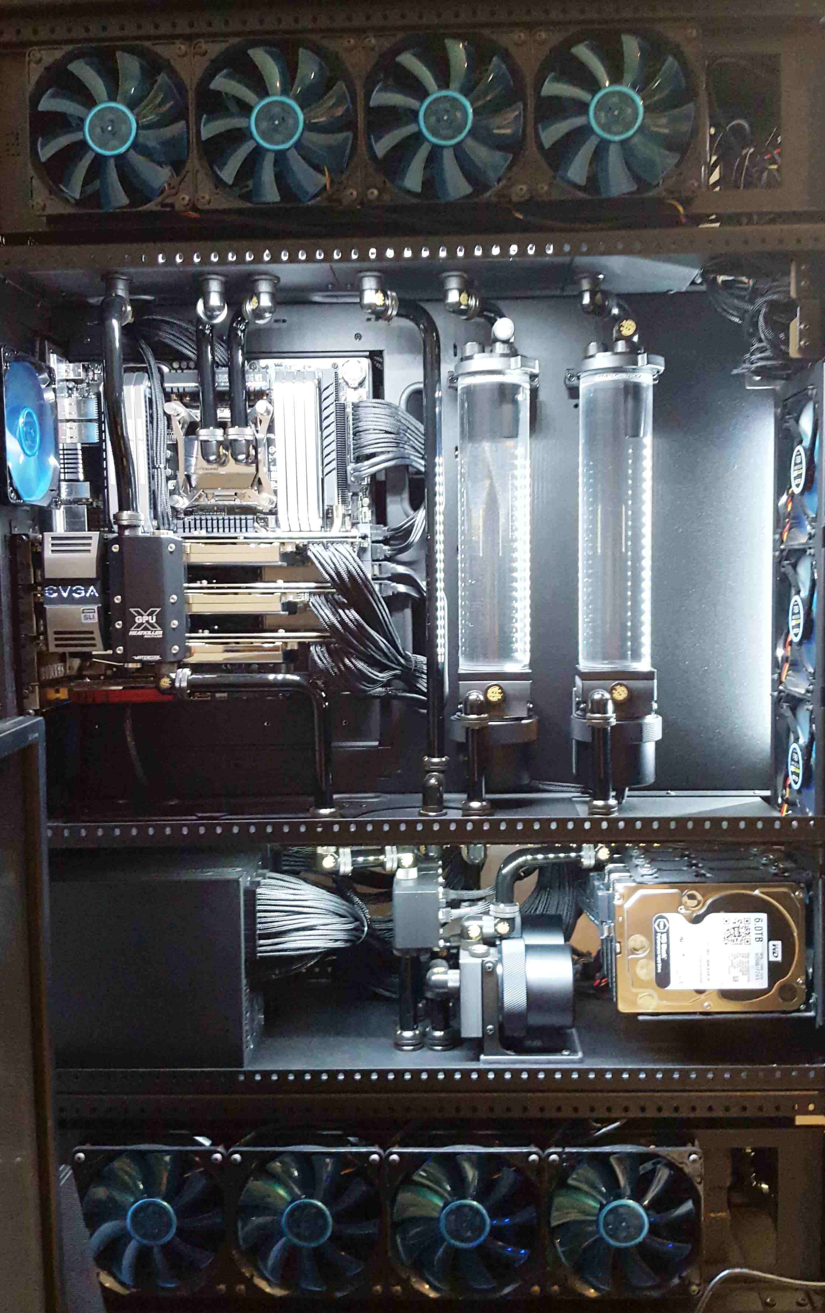

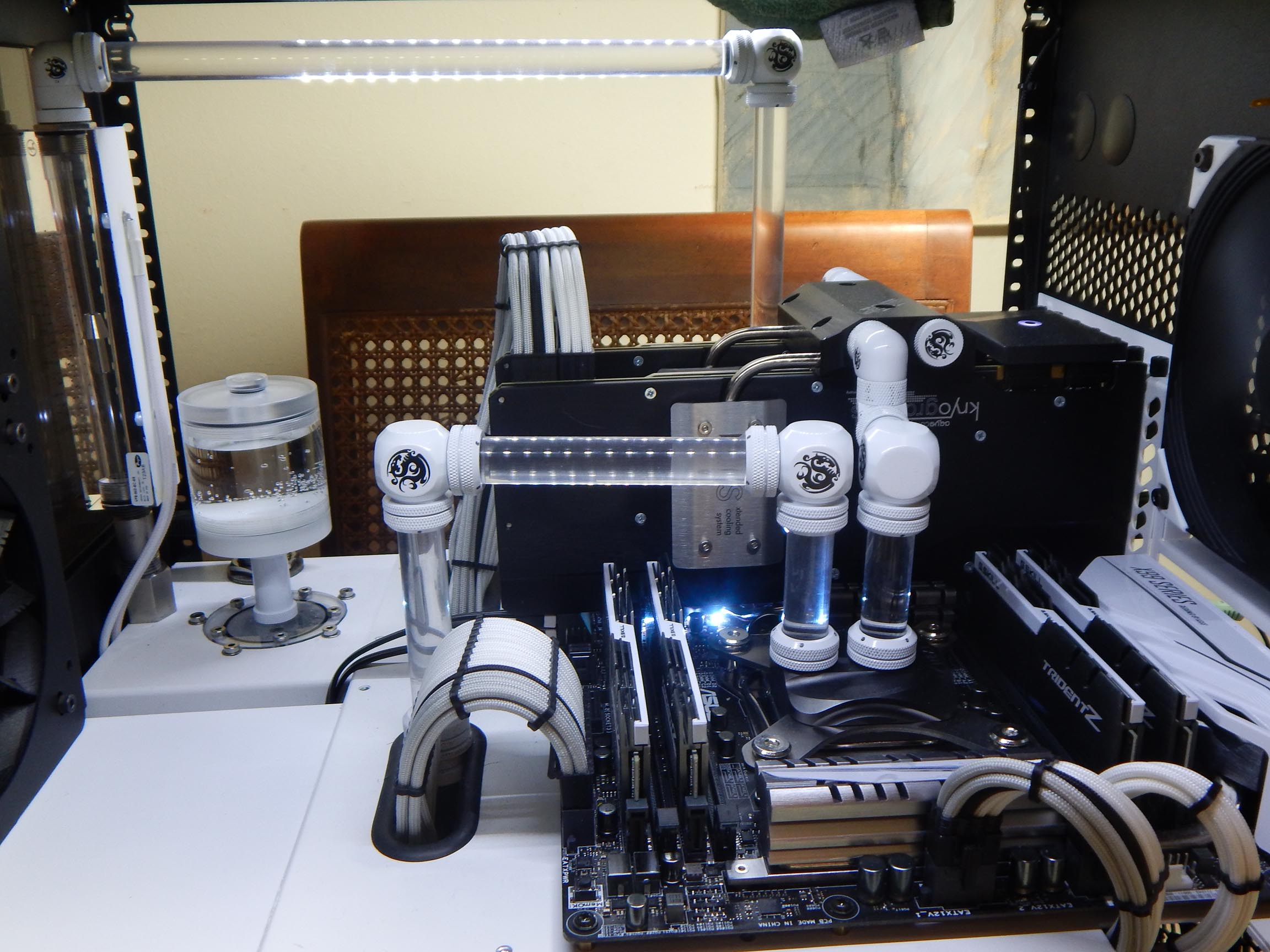

As a seperate comment, for my first water cooled system I used EKWB blocks for the CPU & GPUs.
For this machine I used aquacomputer blocks for the CPU & GPUs, and they are much more appealing to me... downright beautiful.
I also used the active back plates for the GPU cards. I do not know if they actually improve performance, but they look sexy and break-up the large back plate.
I still have an EKWB on the Intel SSD 750, but that is because aquacomputer does not have one.
CPU block & GPU back plates (cpublock)
GPU blocks (pcieblocks)

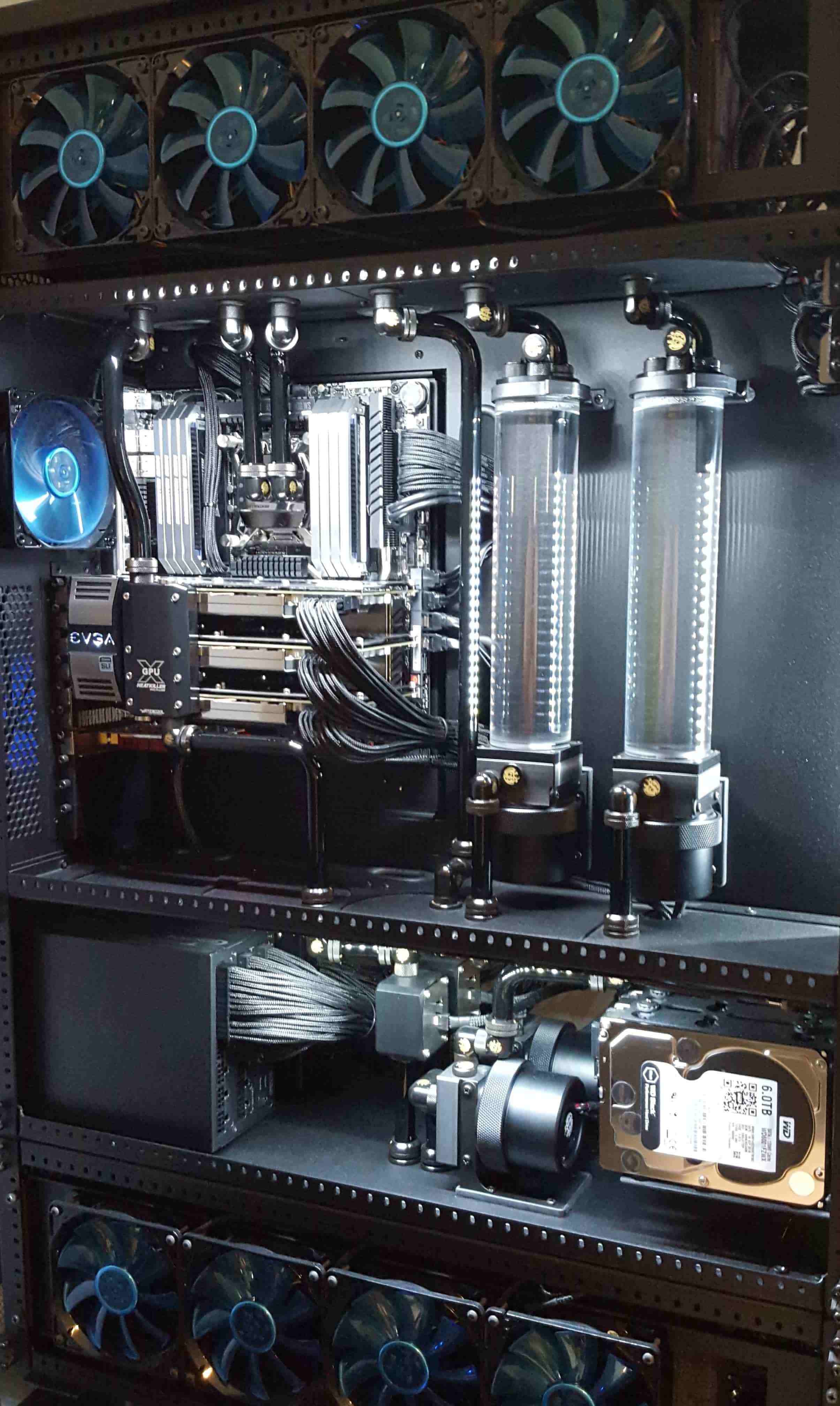

minor aesthetic update
Donnerstag, 28. Dezember 2017, 17:22
The HexRes is unique and as such interesting, but it has two other properties I learned to dislike over time:
1. it is gaudy to the point where it distracts from the minimalist build I wanted
2. it is butt-ugly
