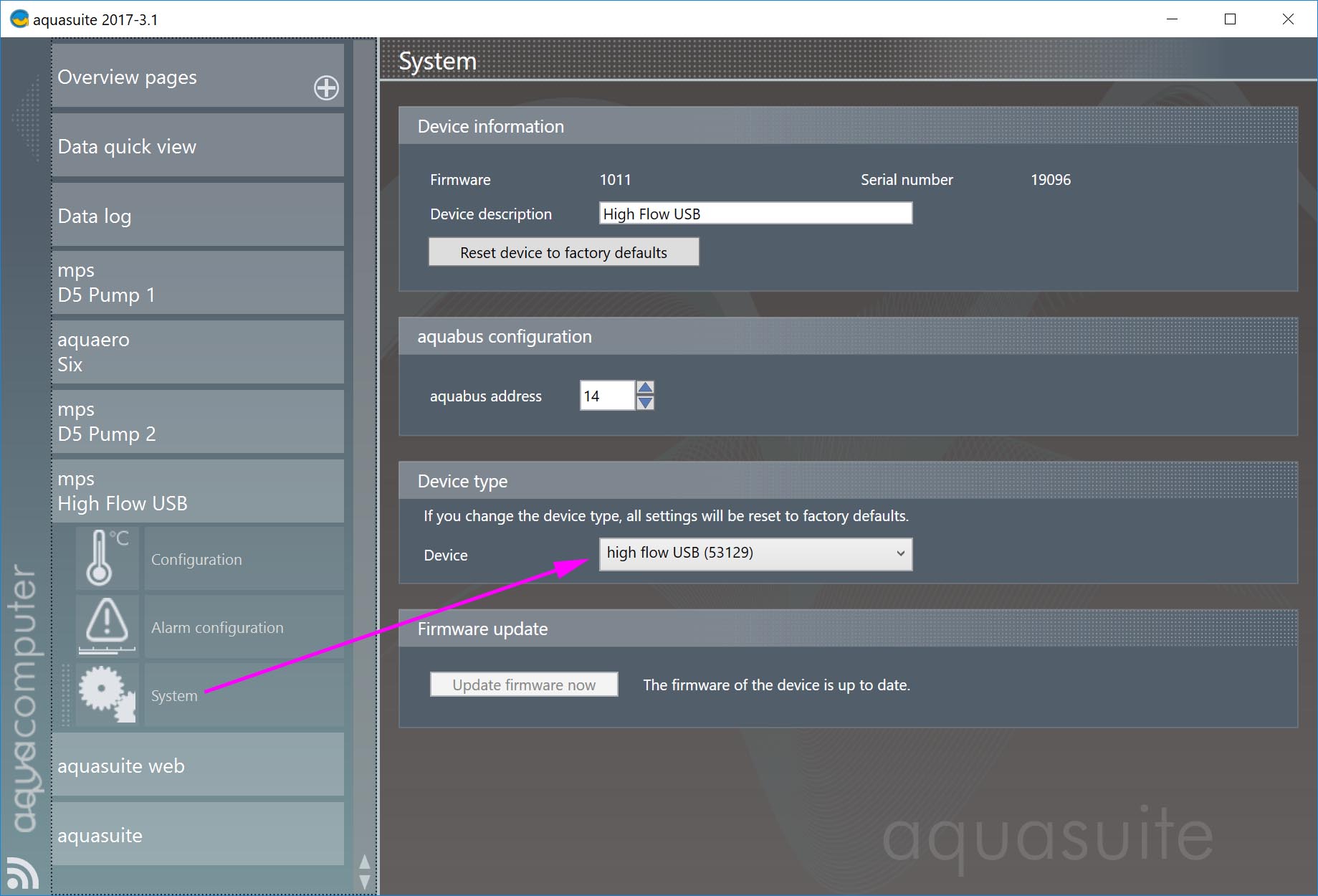

Samstag, 23. Dezember 2017, 21:48
The highflow usb sensor 4 pin aquabus port can be connected to the aquaero aquabus high port by a 4 pin cable, yes.
Since you have only the one MPS device, you do not need to adjust the default bus address.

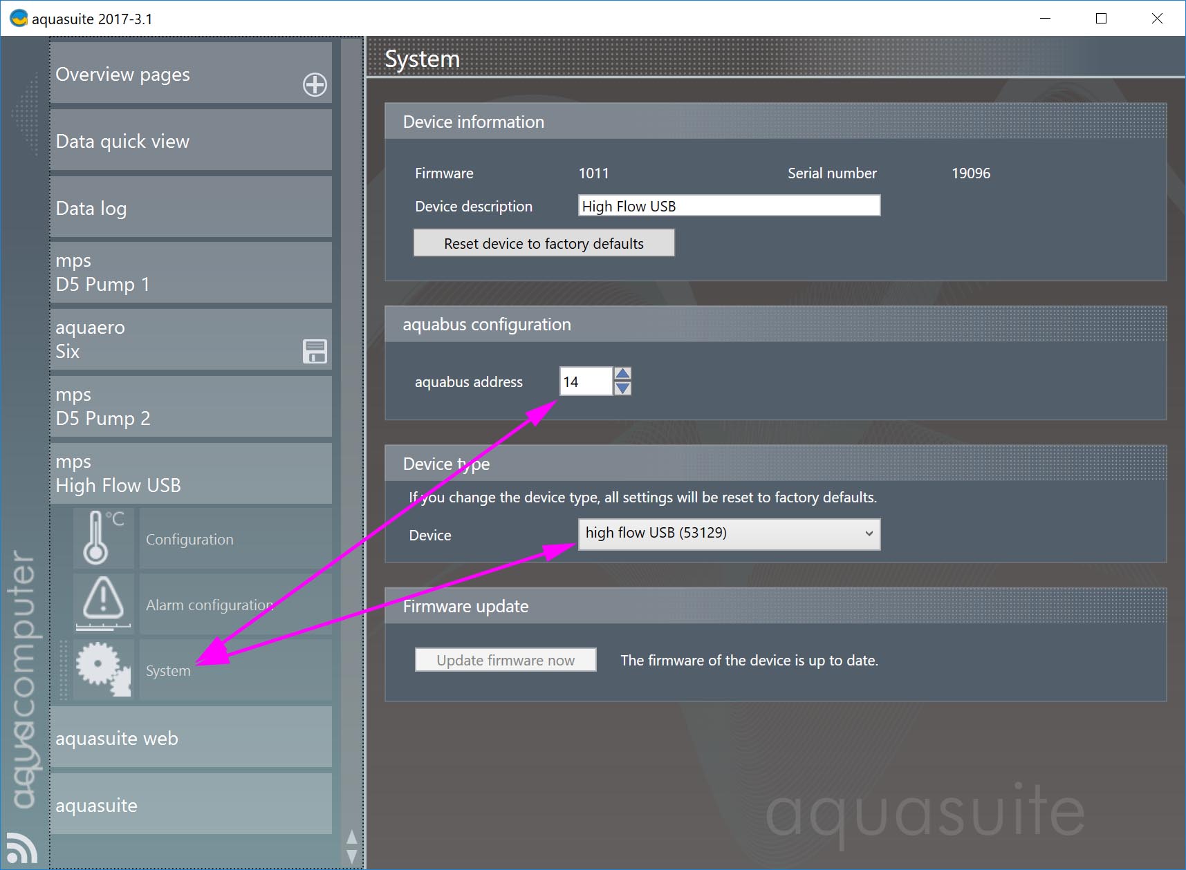

Sonntag, 24. Dezember 2017, 15:29
OK, it looks like the highflow usb flow sensor shows up in aquasuite when connected by USB. system.jpg

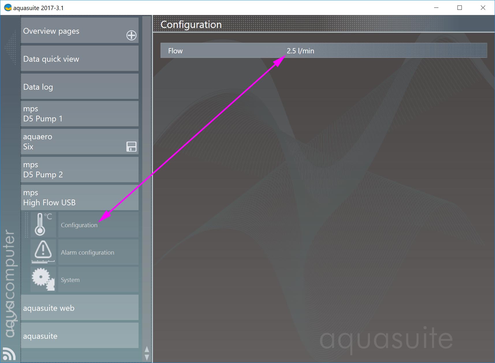

Do you see a flow value in the configuration tab when the highflow usb flow sensor is connected by USB? usbflow.jpg
If so, we need to look at your 4-pin aquabus cable between the flow sensor & the aquaero.

88Gamer88-NLD
Sonntag, 24. Dezember 2017, 15:37
Yes, The sensor shows up when i conneced by USB.
And give a "good" signal +/- 95 L/Hour
