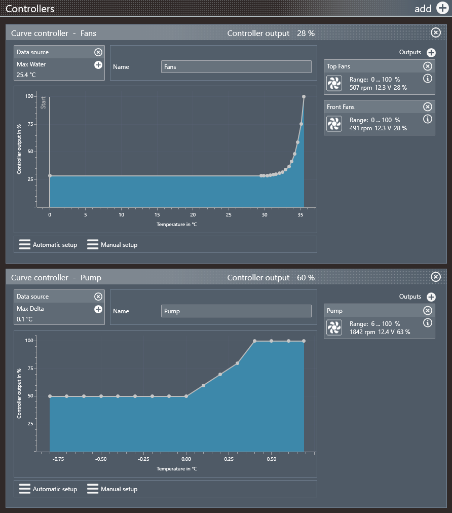

You can see some evidence of it in action with a "curve controller" here:
As can be seen, as the CPU load increases slightly, this causes the CPU delta to increase, resulting in a small increase to the flow.
Here are my curves:
As you can see, everything seems to work OK when I use curve controllers.

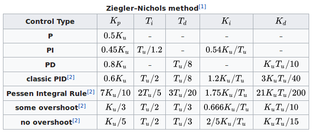

The Ziegler-Nichols method is a heuristic optimization scheme that functions as follows:
1.) Set P, I and D all to zero.
2.) Gradually increase P until the system starts a sustained oscillation.
3.) Note the minimum value of P at which the sustained oscillation occurs as Ku.
4.) Measure the period (in seconds) of the oscillation as Tu
5.) Set P, I and D as follows:
The "Classic PID" values will create overshoot, but ought to stabilize relatively quickly.
The "Pessen Integral Rule" should create faster response at the expense of more overshoot.
The "Some Overshoot" settings will have less overshoot than classic, at the expense of slower response.
The "no overshoot" settings should have no overshoot at all, but will be much slower to respond.
Read more on Wikipedia here.

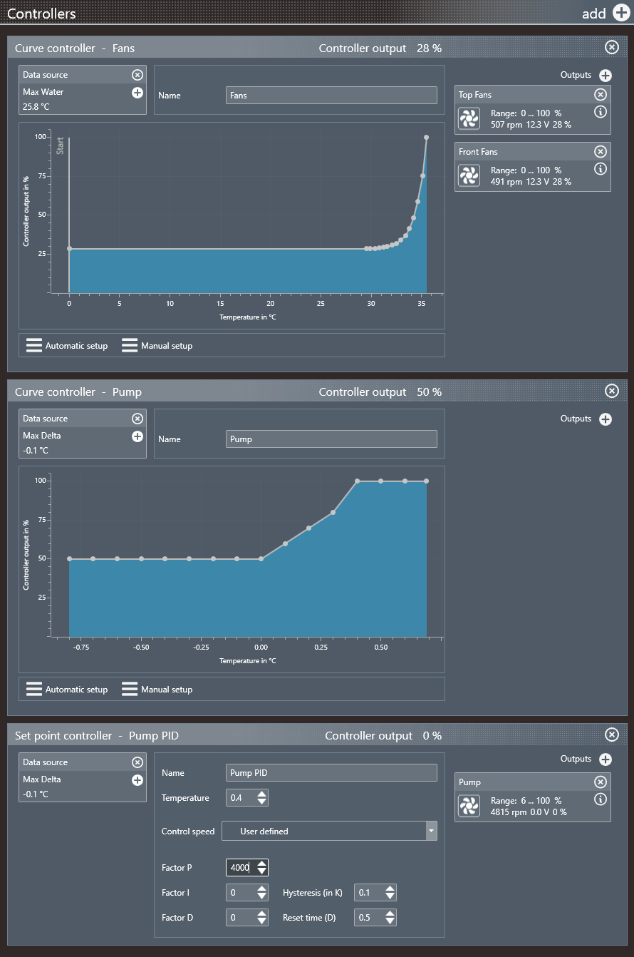

So, I followed the Ziegler-Nichols method, assigned my pump to a Setpoint controller in manual mode, set P, I and D to 0, and start ramping up P.
The problem is, not only do I never get to a point where it oscillates. No matter what I do, the pump goes to 100% PWM duty cycle and stays there. I ahve tried just about everything. It just stays at 100%.
Is the PID Controller fully functional currently or is it broken maybe? Is there anything else I should try?

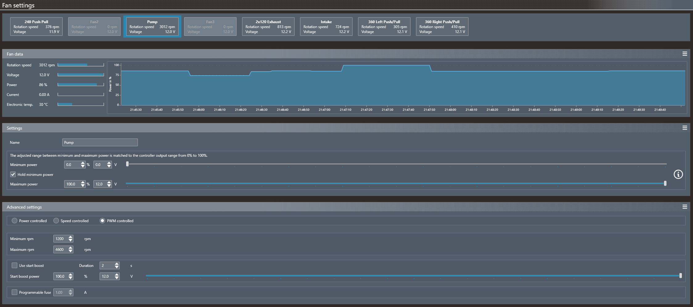

The reason you are experiencing this is because the minimum PWM value for the pump is set to 0%. Usually the pump works in full speed when the PWM is set to 0%.
To counteract this, go to FANS, and set the minimum PWM value for the Pump output to, lets say, 30% and check Keep minimum value (or something). This way the Pump will be at 30% while the PID Controller is at 0%.
Doh, that makes perfect sense. I knew this behavior about the pump, I should have thought of that.
Have you actually gotten this to work? I've never tried to set minimum speeds for the pump, but I have for the fans, and it just does not work. I go in to the fans page, set them to PWM controlled, and it gives me th eoption to se min and max RPM's (not duty cycle percent) but when I set those values it simply ignores them, and goes below the min and above the max anyway. Maybe there is something I am missing.

Regarding the pump, I basically did the same thing (except I have dual D5 G2). I found the most silent speed and checked to see if the flow is between those values. 1GPM at 86% PWM.
My pump resonate differently, but are silent at 86 and 95%. At 95%, though, they increase the water temps by about 1-2C so I stayed at 74%. Also, I found that the D5 pumps perform exponentially better at higher speeds (eg. 86% - 1GPM, 100% - 1.7GPM).

- Pump output (disregard the chart as I was testing to see the flow):

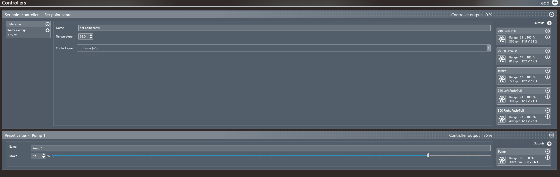

- Controllers:
Basically, the Pump is at a fixed output and the Fans are controlled by the PID.

I have been able to get the minimum speed controls to work now. I think what was throwing me off was that it said "power" and the voltage field changed when I changed the percentage. I didin't think this applied to me since I am all PWM.
