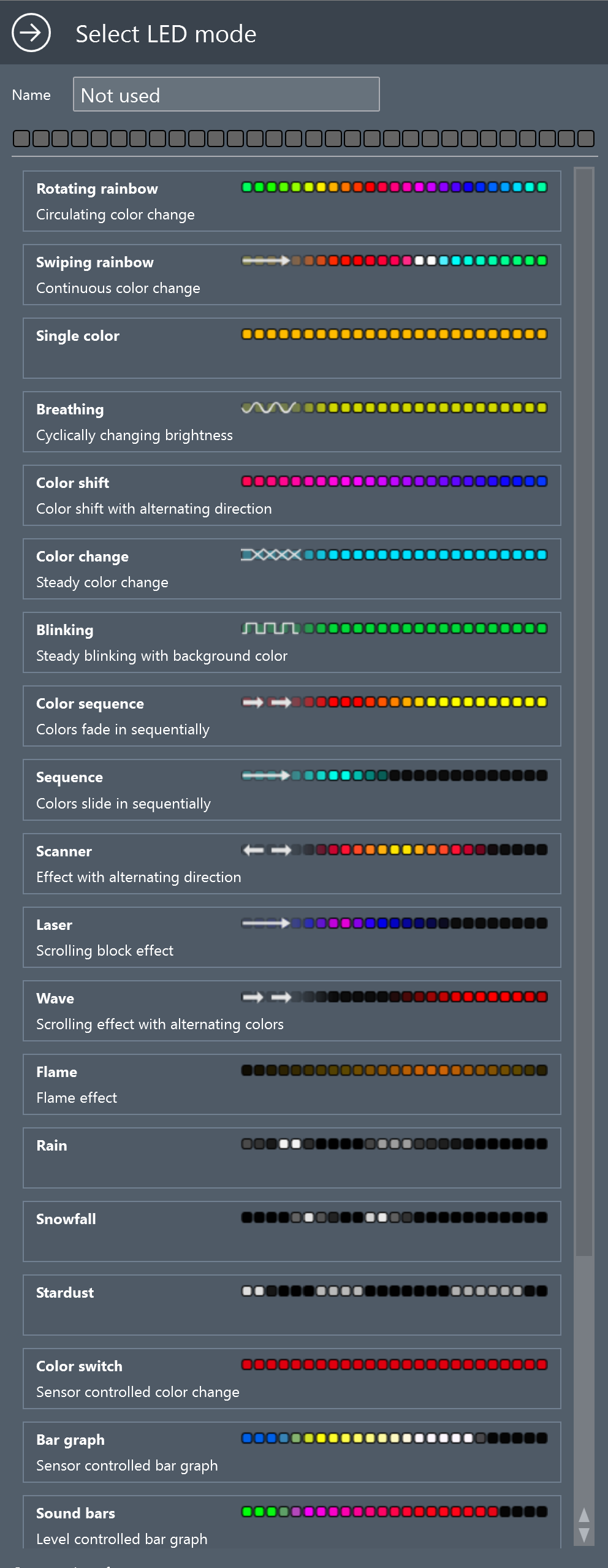

I believe you did purchase the wrong item. You want the farbwerk 360 with individually addressable RGB LEDs to get the effects you are looking for.
Partial list in snip in attachment.

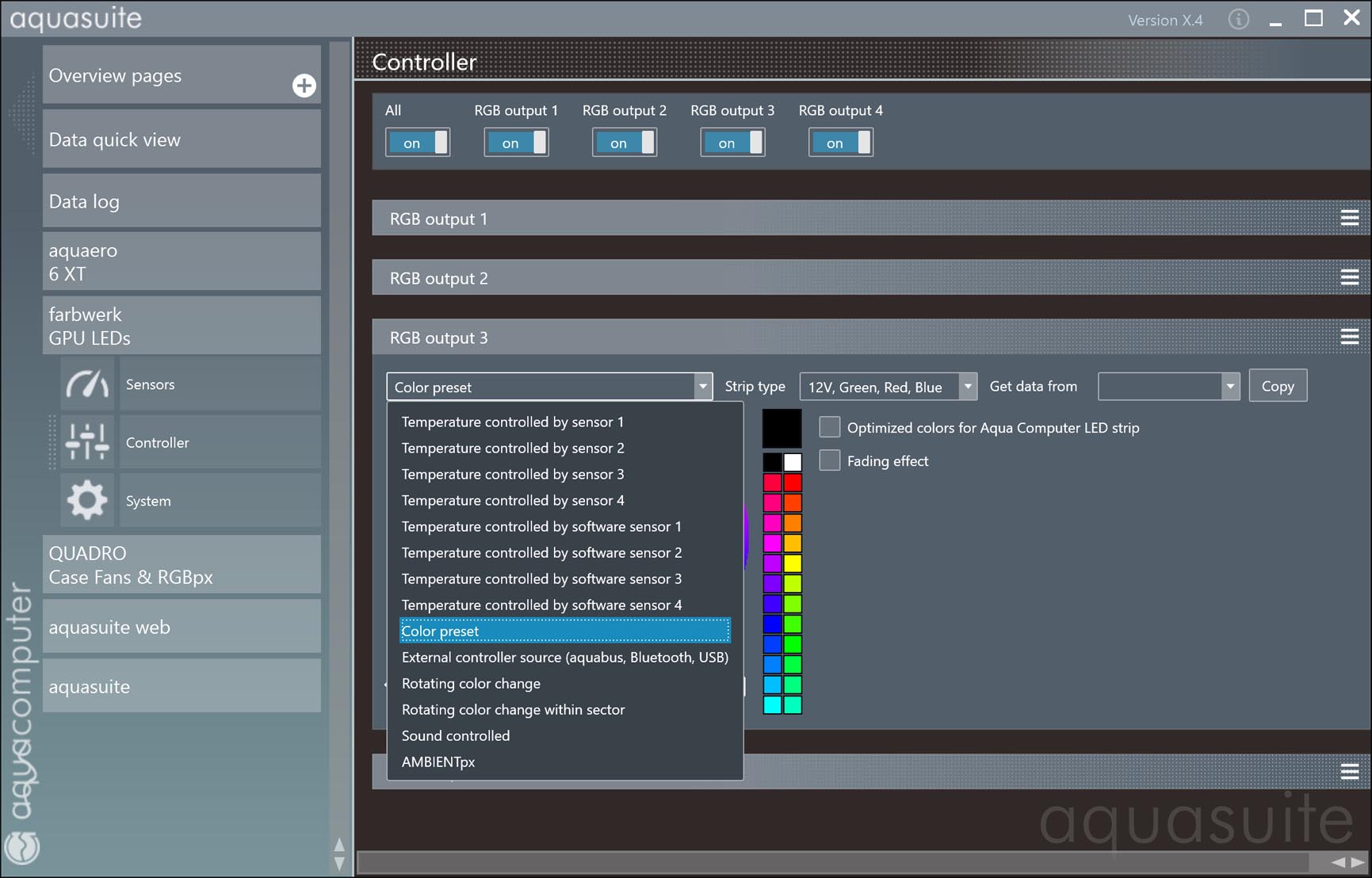

with the farbwerk you can use 12V Strips, with farbwerk 360 (adressable LEDs, RGBpx).
With the farbwerk you can set up all effects. Make Screenshots when somthing is not clear. Breathing is possible. The farbwerk can do much more things as the mainboard headers (Aura ....)
Montag, 29. Juli 2019, 17:59
Is there a way to get more effects on the farbwerk? I only saw a few effects on the drop-down menu on my farbwerk, and breathing was not one.
»InfoSeeker« hat folgende Datei angehängt:
Montag, 29. Juli 2019, 19:37
click to option fading effect and then you can edit your effect.

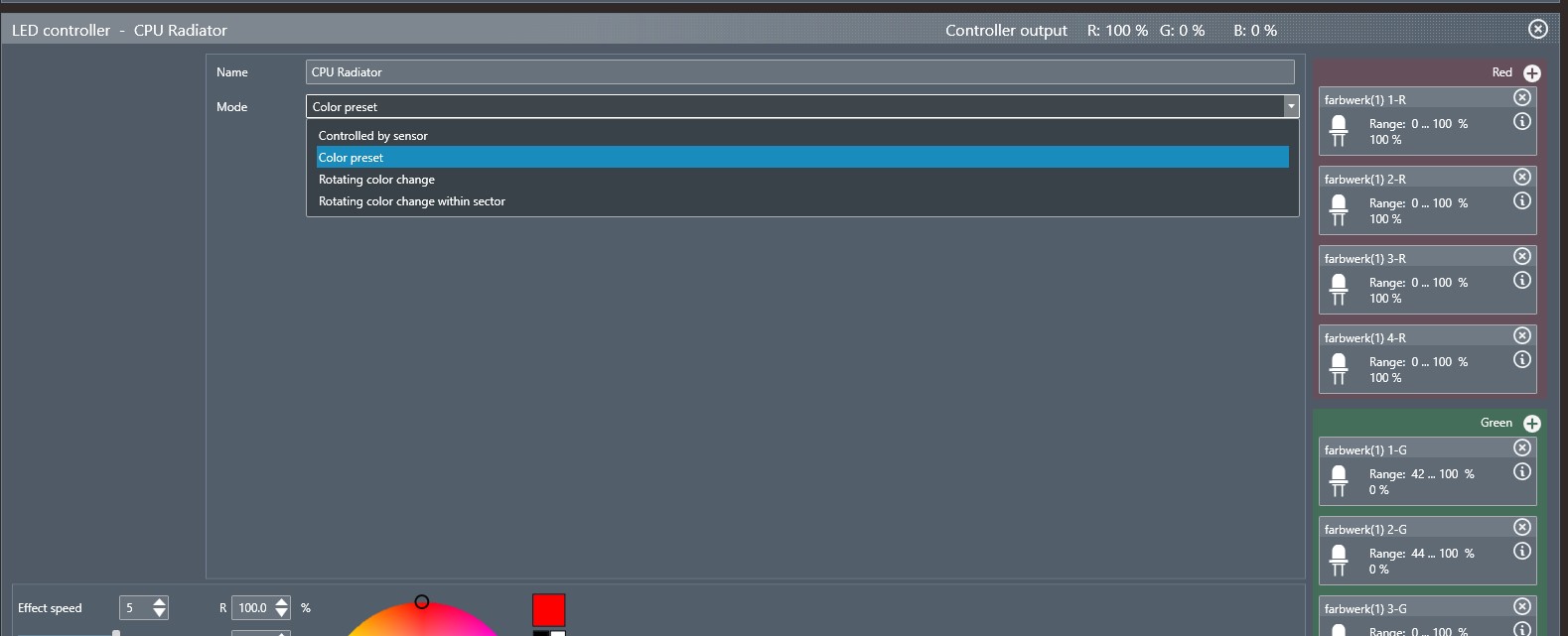

My FabWerk is the 53170 and it is plugged into the Aquabus port of a 6 LT
I am running Aquasuite X4
Then I am missing something, I have 16 140MM 12V RGB fans in my system I have the latest version of AquaSuite I have setup a controller all I get for effect are Controlled by sensor, Color preset, Rotating color change, and Rotating color change within sector.
See attached,
I tried to get a breathing setting rotating color change within sector setting effect speed to 5 color 1 to red and color 2 to black and the same thing with controlled by sensor and I created a dummy software sensor.
I just noticed InfoSeeker Senior Member has a FabWerk selection in his AquaSuite I do not, do I need to have the 53170 Plugged into USB as well as the Aquaero Aquabus port?

Mittwoch, 31. Juli 2019, 07:25
the farbwerk via aquabus is limited to the available effects from the aquaero.
Only when you connect the device via USB, you have the full functionality.
This is the same with all aquabus devices. The aquabus support only a small set of features from a device.
