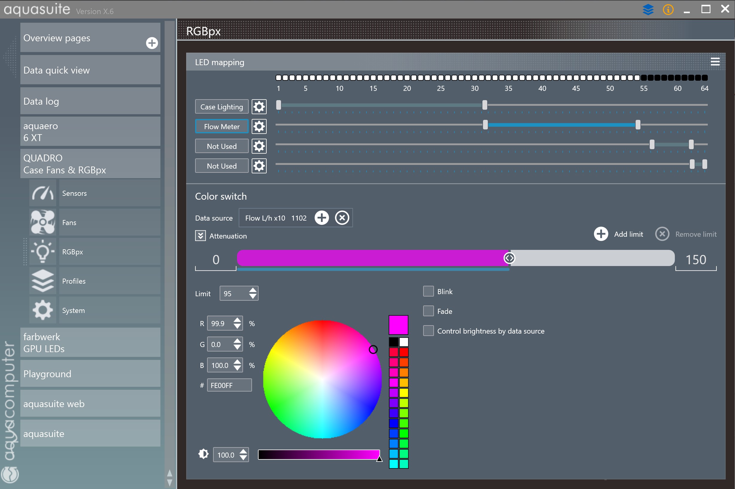

I have followed your recommendations for connection and am having major issues
My Aquaero 6 has disappeared from aquasuite no matter how i connect the usb to either the hubby or mobo directly- could be the cable so have ordered a replacement few to check
the farbwerk 360 does not seem to show any leds for the fans at all- unless I am doing something wrong which is very possible
the only good thing so far is I can control the D5 next speed to keep in nice and quiet but as the AE6 has vanished the fans are running at 100%

the farbwerk bit it looks similar but it doesnt seem to allow me to set or save anything regarding the leds but as the AE6 is still not being seen, I dont think I can set the controllers up anywhere. I am waiting on new internal usb connectors to see if it is that causing the AE6 to not be seen as there is nothing anywhere showing me an error or install issue as far as I can see

I receive the last bit today and I am also fail getting the fan LEDs to light.
Initially I went with just the LED connections and not the fans being powered up, but adding the fans didn't help either.
I am able to control the LED strip that came with the farbwerk 360, but not the Corsairs fans through the splitty4.
Not sure what the issue is, I have the 3 fan's LED connectors inserted into the first 3 fan ports on the splitty4, but nothing using the controller below.
I may try to control the fans with the included controller from Corsair to see what happens.
I am able to control the fan LEDs with the included connections and the Corsair Link software.
