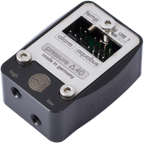

Hi there, I've ordered MPS fill level sensor delta 500, and I was wondering how in the H to connect that in my loop. google didn't help and manual also huh.., forum search wasn't fruitful. Can somebody just tell me what fittings,connectors etc I need to buy and where to put it? Thanks in advance! :(

I had same question, got answer here Is it correct MPS Pressure connection scheme ? G1/4 fittings can be used

G1/4 fittings depends on your tube size i.e. for example 10/13mm. Most water cooling systems use 1/4 either 1/8 again depends what you use. This sensor has supported adapters x2 M3 (distance then 12 mm between HIGH and LOW) or x2 M5 (distance then 24mm). So you will need to buy these adapters to G1/4 or G1/8 fittings which you use in your loop if I am correct

Unless you have a reservoir that is around 5 meters tall, you may want to see if you can exchange the MPS 500 for the 40 or maybe 100.
The MPS 40 is good for up to 400mm, and will give the best results for a water column in that range (400mm tall reservoir, or less).
If you reservoir is over 400mm, then the MPS 100 maybe what you need as it goes to 1 meter high.
Your resolution with the MPS 500 may be very coarse for shorter reservoirs.
Installation is the same for all:
  1. screw this FITTING into the lowest port on your reservoir
  2. screw this FITTING into the "high" Port of the MPS pressure sensor: mps_sensor.jpg
  3. run this TUBE between the two fittings above (1 to 2)
  4. leave the MPS port marked "low" open to atmosphere: mps_sensor.jpg
  5. screw this FITTING into the highest port on your reservoir

Thanks a lot! :) I cant exchange it, but I can buy another one and use this one for that other function. I was wondering, can I install that fitting for the lowest part of the reservoir to the side of the D5 top?
Where does that port lead?
If it has a direct path to the bottom of the reservoir without influence from the pump's rotor, then I would think so.
But if it is an alternate discharge port, then no, because the output pressure of the pump would bias the pressure sensor and yield results not related to the water column's height.

If THIS is the pump, then looking at one of the images, it appears you have 3 inlet ports and one discharge port.
If this is what you have, then you could connect the pressure sensor high side to any of the 3 inlet G1/4 ports on the pump top with good results. If there is a bias from the fluid flowing past those ports into the center of the pump, it should be minimal and constant. I assume the important function of the sensor is to indicate change over time, not absolute accuracy.
