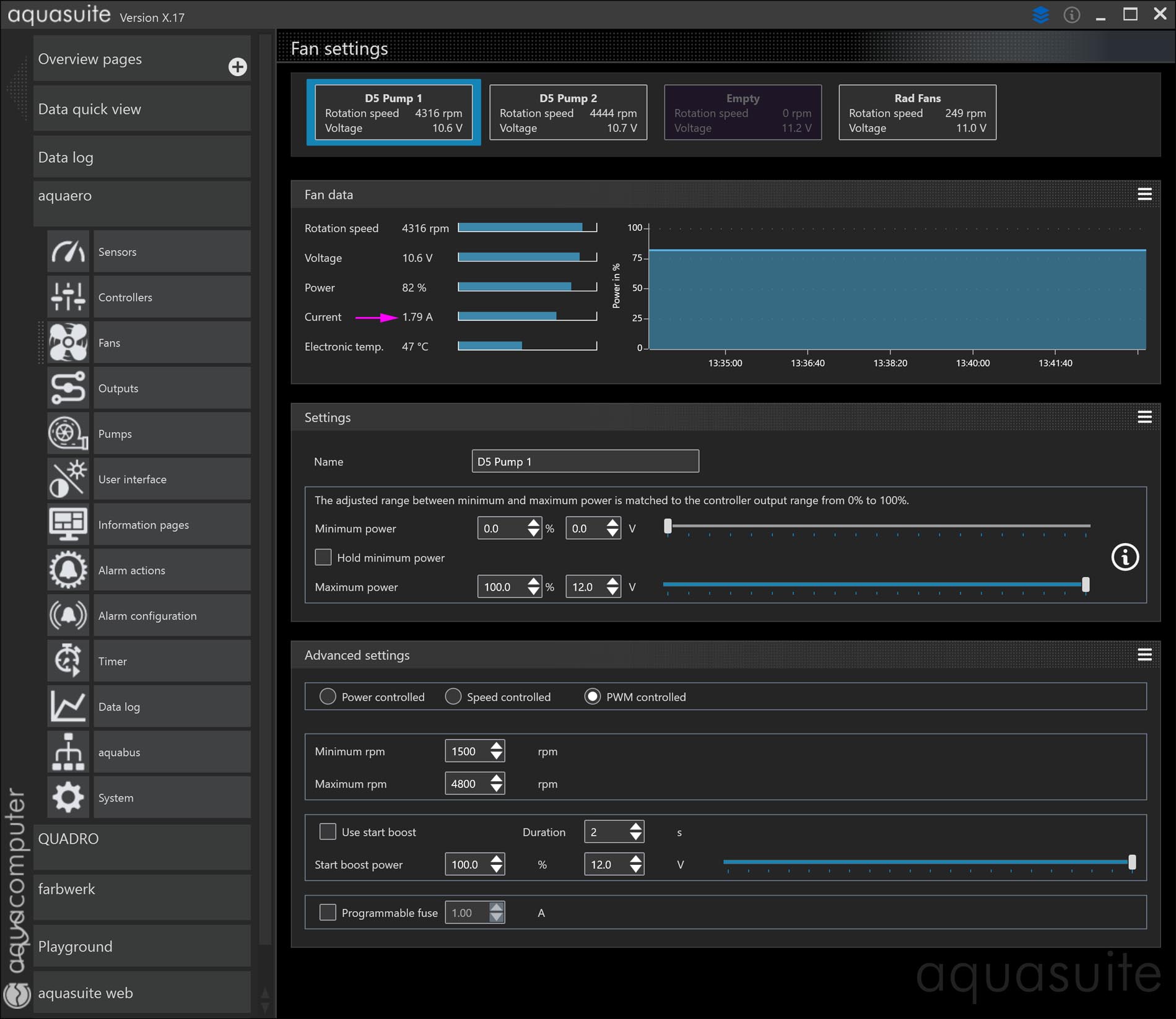

From what I can see and with everyone's input as long as I have Red wire with Red wire & Black wire with Black wire I should be good. :thumbsup:
Mittwoch, 13. Mai 2020, 21:28
I thought about that but didn't want to be liable for damages if possible. lol
Hence the caveat... but the suggestion is not without experience.
I am doing a similar thing on my external radiator, but with PWM pumps (set at 82% with a Preset Value controller).
I have two Aqua Computer D5 PWM pumps and an aquaero 6 XT on the bottom of the external radiator. radfrt.jpg
I decided to place the pumps' power leads on the PWM connectors to minimize cable clutter. radbak.jpg
The pumps are pulling less than 1.8 A. (the 2nd pump is running the same as pump 1) amps.jpg
And the amplifier temps for the fan ports are running about 6 degrees (47 C) above the idle port (#3). temps.jpg
This has been running for about 5 months, so I am hopeful it will keep marching on. :)
