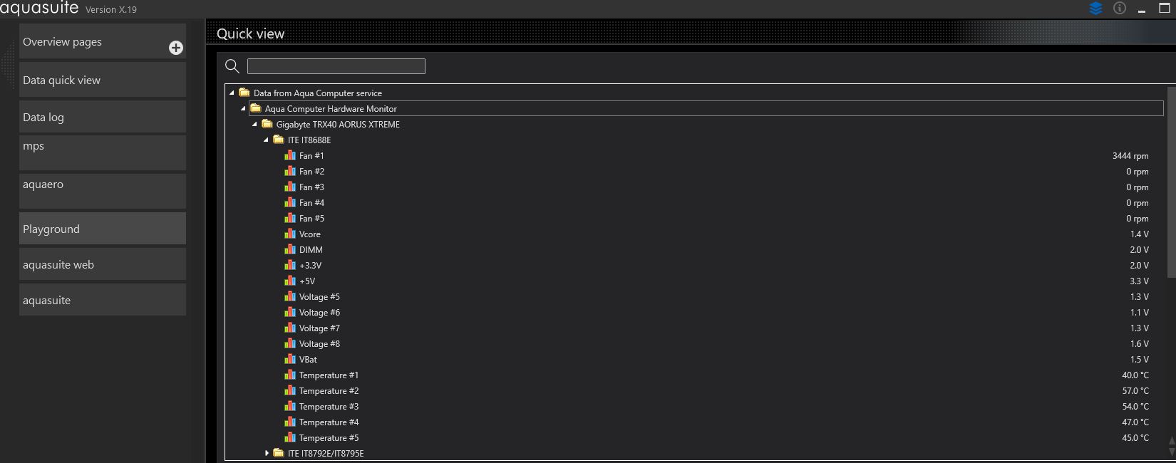

So I found something interesting regarding the sensors.
The attachments in this reply:
Pic1 shows software sensor for CPU which I changed the data source.
Pic2 shows drilling down the Aqua Computer Hardware monitor to the Gigabyte motherboard's ITE IT8688E and seeing just 5 Temperature options.
Pic3 shows Data Quick view drilling down to Aqua Computer Hardware monitor, again the motherboard's ITE IT8688E, but now seeing a big list.
Why do they show a different list to select from?

RE: Sensor Pics
Mittwoch, 27. Mai 2020, 13:45
Pic3, the 'big list', shows only 5 temperature sensors, the additional items are RPM & Volt.
Pic2, for virtual TEMPERATURE selection, displays ONLY the temperature subset (5 items) from the 'big list'

That makes sense, it's been a long time. I do wish the temps were properly labelled. I have to figure out which is which? So setting the VPU, VRM, SYSTEM1, CHIPSET, PCIE is all done manually I take it. It's been a very long time since I fiddled with setting up a new motherboard :D
