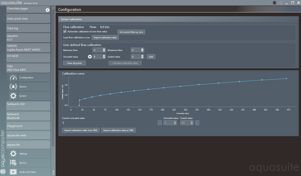

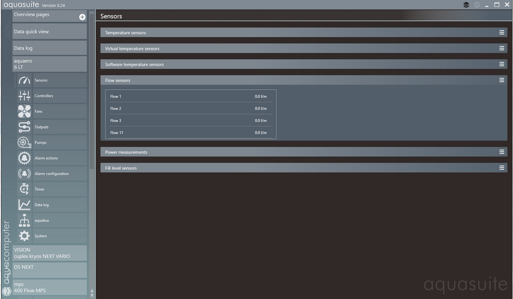

Before the MPS 400 working great at my old setup
But after I switch to a new case the 6 LT did detect the MPS 400 but no reading
so please is there any way I could fix this ?? Please help
»DirtyBear« hat folgende Bilder angehängt:

maybe your flow is too low because of (for exmaple) air in the loop? Your MPS is specified from 80l/h to 400l/h. When your flow is too much below 80l/h it will be the case, that it is showing "nothing"

then for helping, you should describe what you have made for to be sure, that you have enough flow in your build. What are with the temps of your componentes and water? Are they ok and on which level? If they are fine, then it could be, that your MPS is defect.

Another thing to check, when I installed my MPS400 I had a similar problem but mine was caused my a pressure build up within the loop. To fix it I installed THIS to the top of my reservoir.
