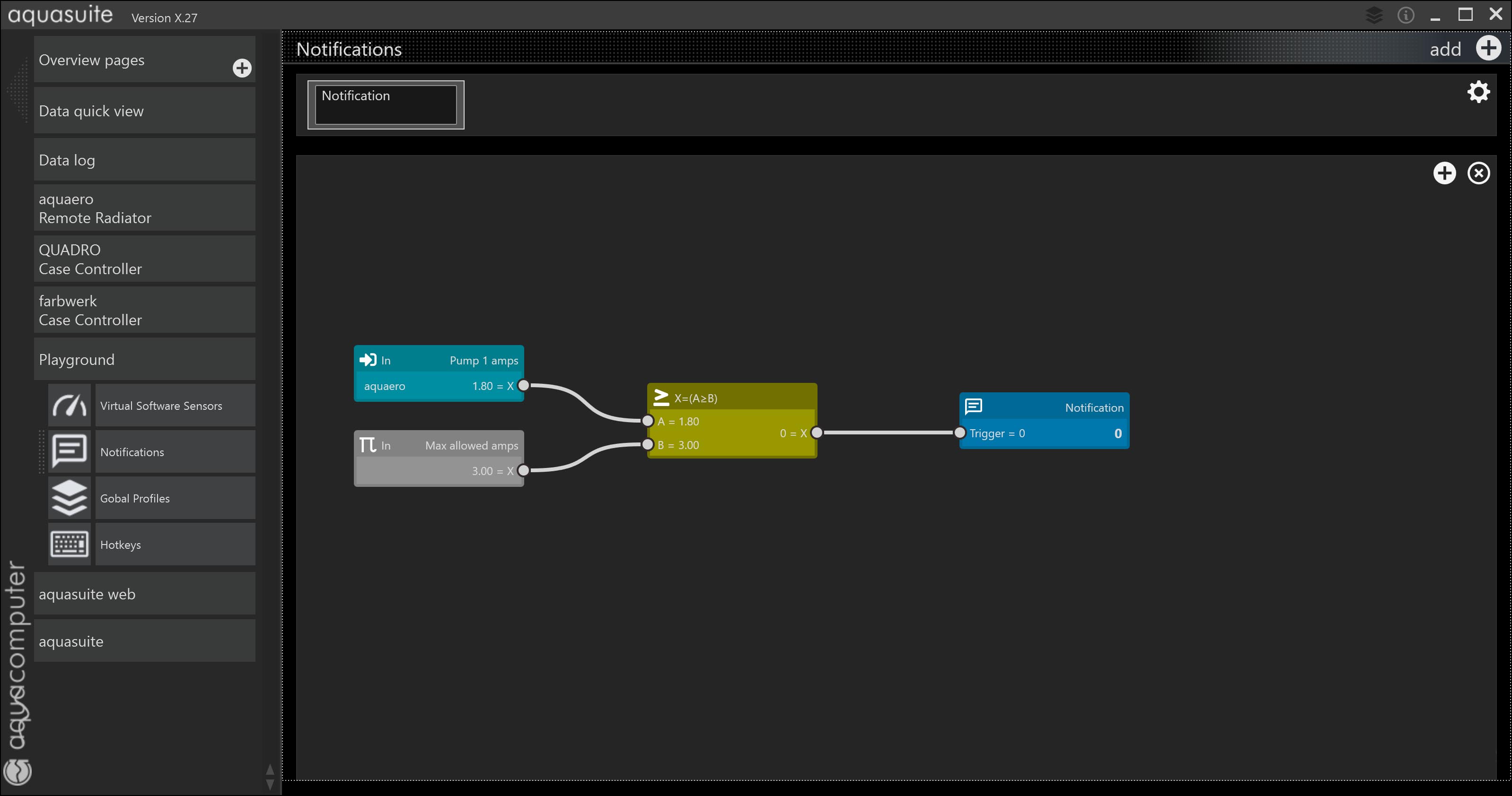

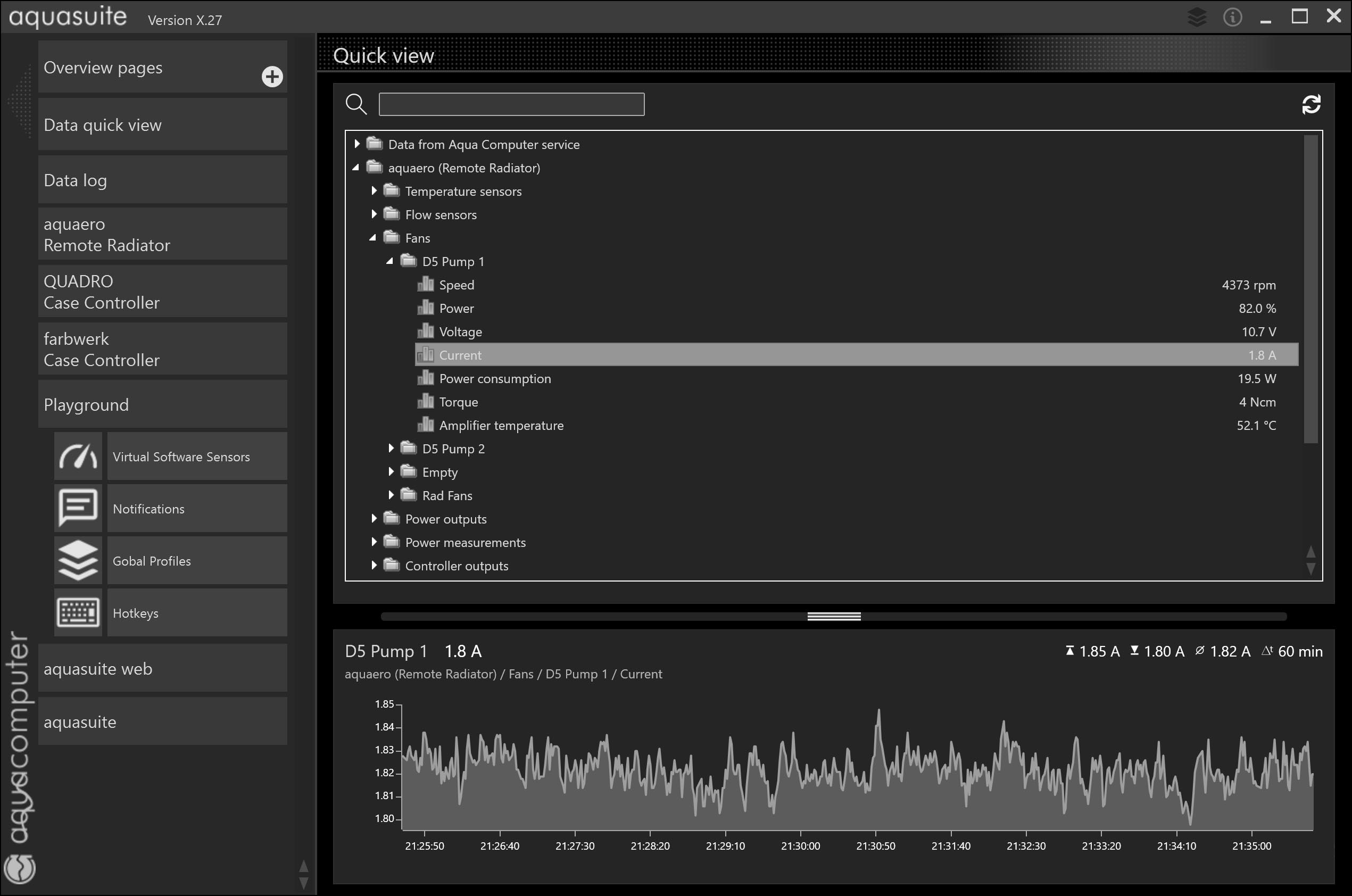

Montag, 12. Oktober 2020, 05:03
Is it possible to add a software sensor and trigger an alarm based off of the pump Amp current draw?
I believe the alarms in the aquaero can only be triggered by fan amp temps or fan rpm.
But you can setup a 'Notification' to trigger Windows Notification service for over-amp condition of the pump. (notification_setup.jpg)
You would use the 'Current' value of the fan port the pump is connected to. (notification_source.jpg)
Then Windows will display a Notification when an over-amp status is experienced. (notification.jpg)
Edit: you stated you had no speed control, so I assume the RPM signal is not connected. If you have an RPM signal going to your fan port 4, you can do an alarm for low RPM.
But you can setup a 'Notification' to trigger Windows Notification service for over-amp condition of the pump. ([attach]7765[/attach])
You would use the 'Current' value of the fan port the pump is connected to. ([attach]7766[/attach])
Then Windows will display a Notification when an over-amp status is experienced. ([attach]7768[/attach])
How do you post pics?
I setup a notification on current but used the less than as I want an alarm when the pump is not running and like less than 1 amp.
You can only get this warning if Aquasuite is running?
Yes, the aquauite must be running for the Notification Service to work with it.
