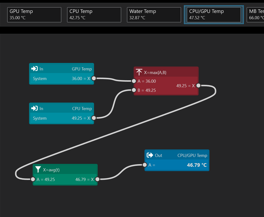

In Playground->Virtual Software Sensors, I have the following, which appears to be doing the right thing with the temp output:

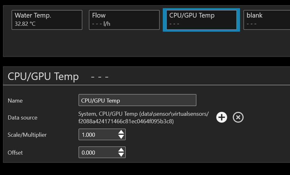

I have a soft sensor configured under D5 NEXT->Sensors, which does *not* appear to be picking up that temp output:

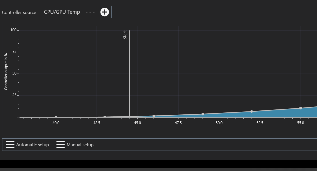

And that in turn keeps the pump curve (D5 NEXT->Pump) from reading temp, and the pump randomly starts running at 100% output:

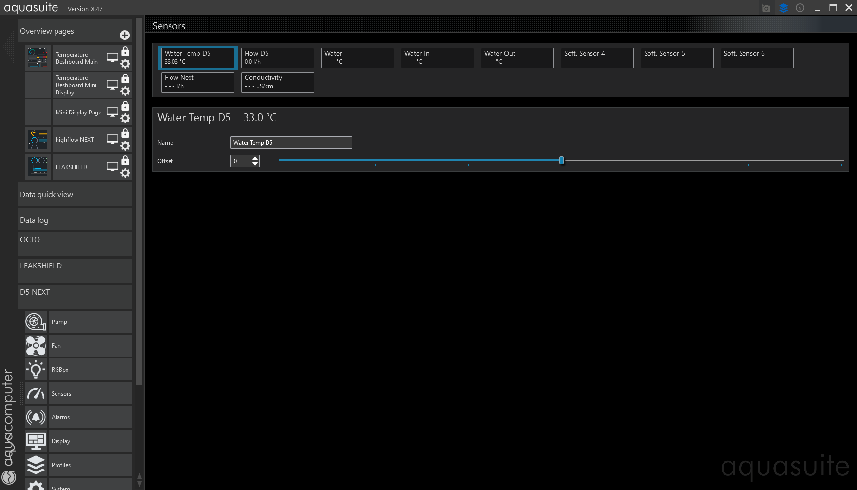

I have same problem with the soft sensors on D5 Next. USB selective suspend settings are disabled by default. Not sure what to do to solve the problem.
»DaLiu« hat folgendes Bild angehängt:
