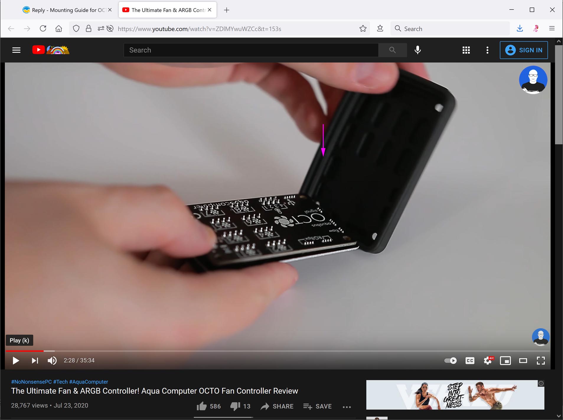

You may want to continue looking for the source of your catastrophic failure, because having the mounting screws make contact with the aluminum cover of the OCTO should NOT be the source.
The aluminum cover is held above the PCB of the OCTO by a ledge on the inside of the rubber casing. (Ledge.jpg)
If properly installed, the cover does not contact any part of the PCB, and it matters not if it is shorted to the case.
And even if laid directly on the PCB with out the rubber mounting, the aluminum cover appears to make contact with the top of chips/resistors before touching any terminal points on the PCB.
