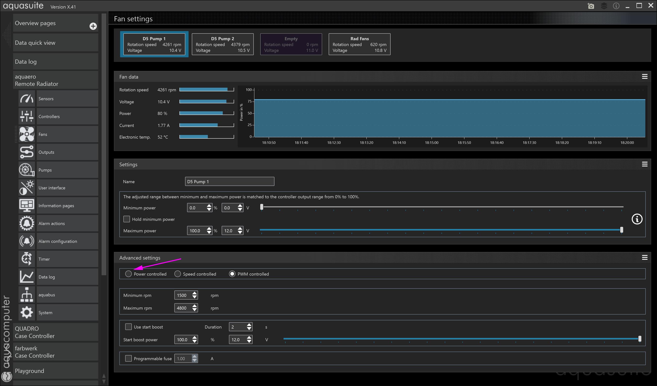

Power/voltage control does work on the aquaero fan ports. Be sure to select 'Power controlled' under the 'Advanced settings' section. (power_control.jpg)
softlion
Donnerstag, 22. Juli 2021, 12:38
Thank you it is working !!!!
So it's something that should definetly be visible on your website: "OCTO and QUADRO can not drive non PWM fans, they will always run at 100%".
I moves some PWM fans from aquaero to OCTO, and moved the big rare case fan from ThermalTake with only 3 pins to the aquaero.
I am now able to control its speed.
Thank you !
