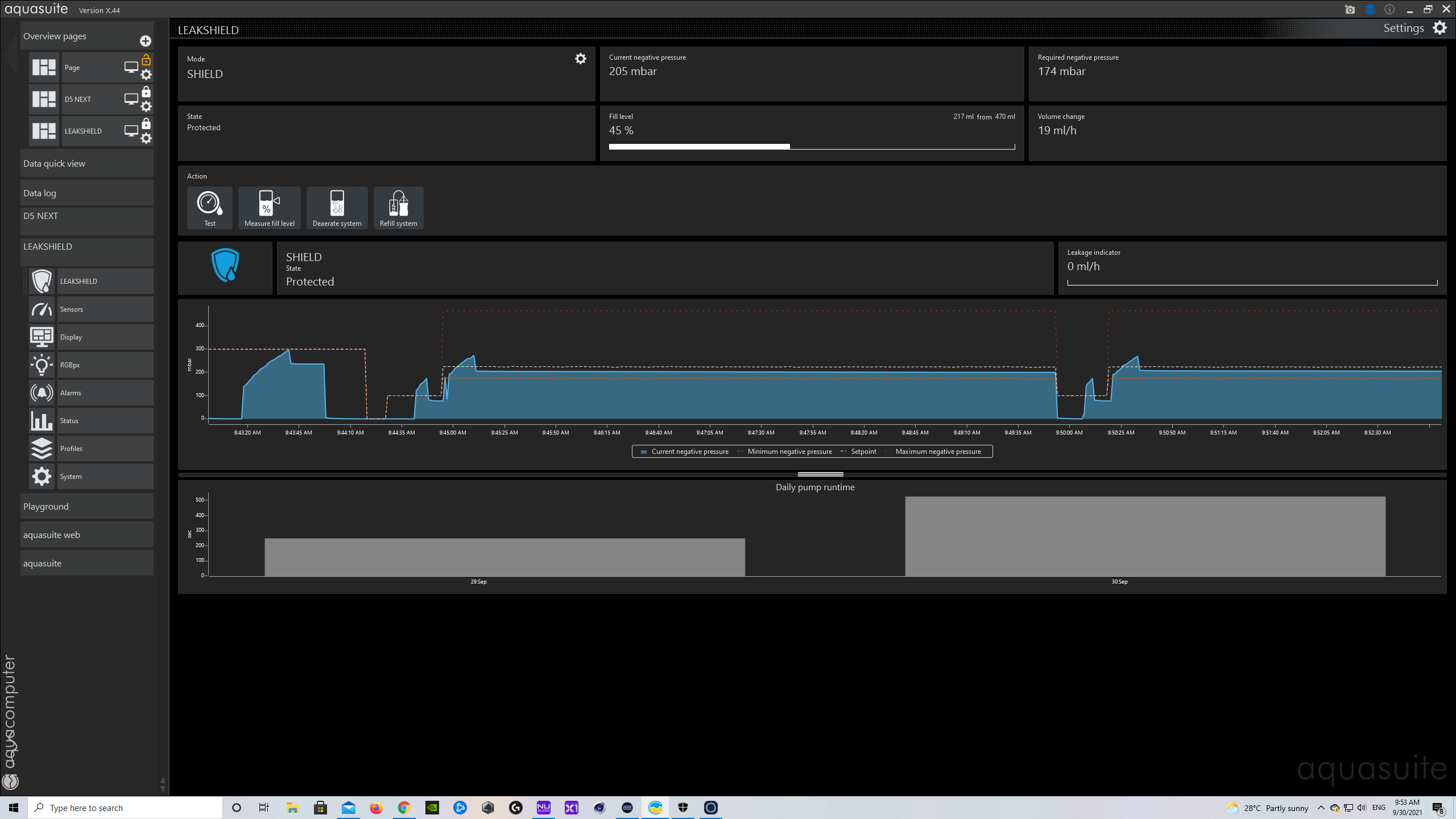

Sorry to hear that. Mine reports 0 leakage over time, but I do see fluctuations in volume depending on load.
https://www.dropbox.com/s/7csdiicu422ycc4/Screenshot%202021-08-09%20062043.jpg?dl=0
What coolant are you using?
The fill function (using the extra PCI-slot fillport and hose) has never worked for me while the loop is filled (for topping off), never tried it on an empty system.
Overall I am very happy with it.

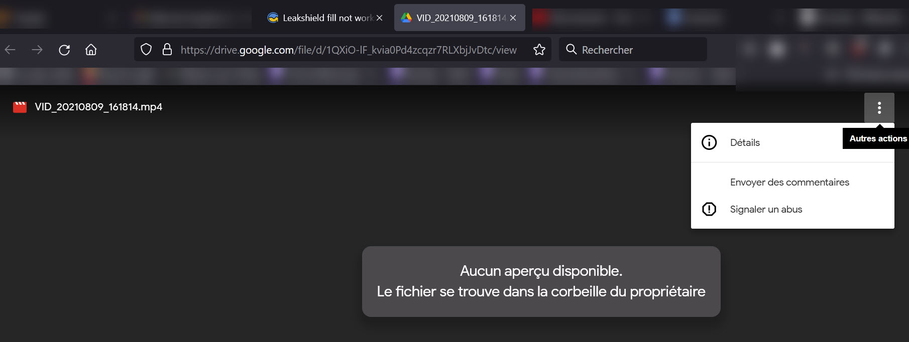

Yes I'm going to put the regular dual port fill top back on and fill the loop so I can boot the PC Ive been trying to do all of 5his from standby which isnt working to well. Another question I have when I put it in test mode how long does that last and will I be able to see the results of said test mode from standby ""mode? Currently when I put it in test mode the pressure just keeps going up and down is it supposed to do that or should it stay at a certain pressure in test mode? It doesn't give me any leak results in standby mode though which has me really confused? Is there a leak isn't there? I'll try and get it running today and then put the leakshield on it and see what that does. For this video I removed the fill port valve and capped it with a g1/8 plug.
https://drive.google.com/file/d/1QXiO-lF…ew?usp=drivesdk

your drive file is not available to us; it says the file is in the trash bin
we actually need all the details, starting by pictures/schemas

Not having a Leakshield I cannot make a comment on it, but I just wanted to say the link to the video provided by @pneuma works for me.

that's odd!

Same here
