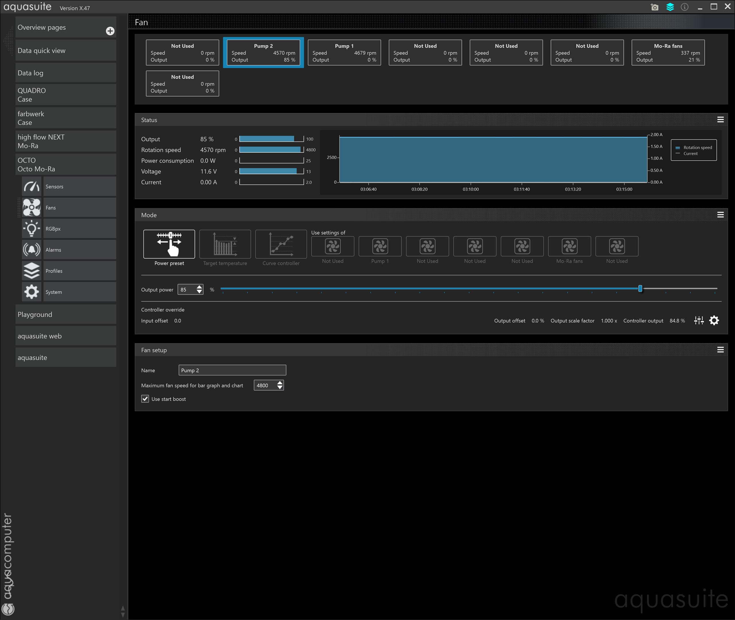

Using 3 PWM ports on an OCTO (#2=pump, #3=pump, #7=fans)

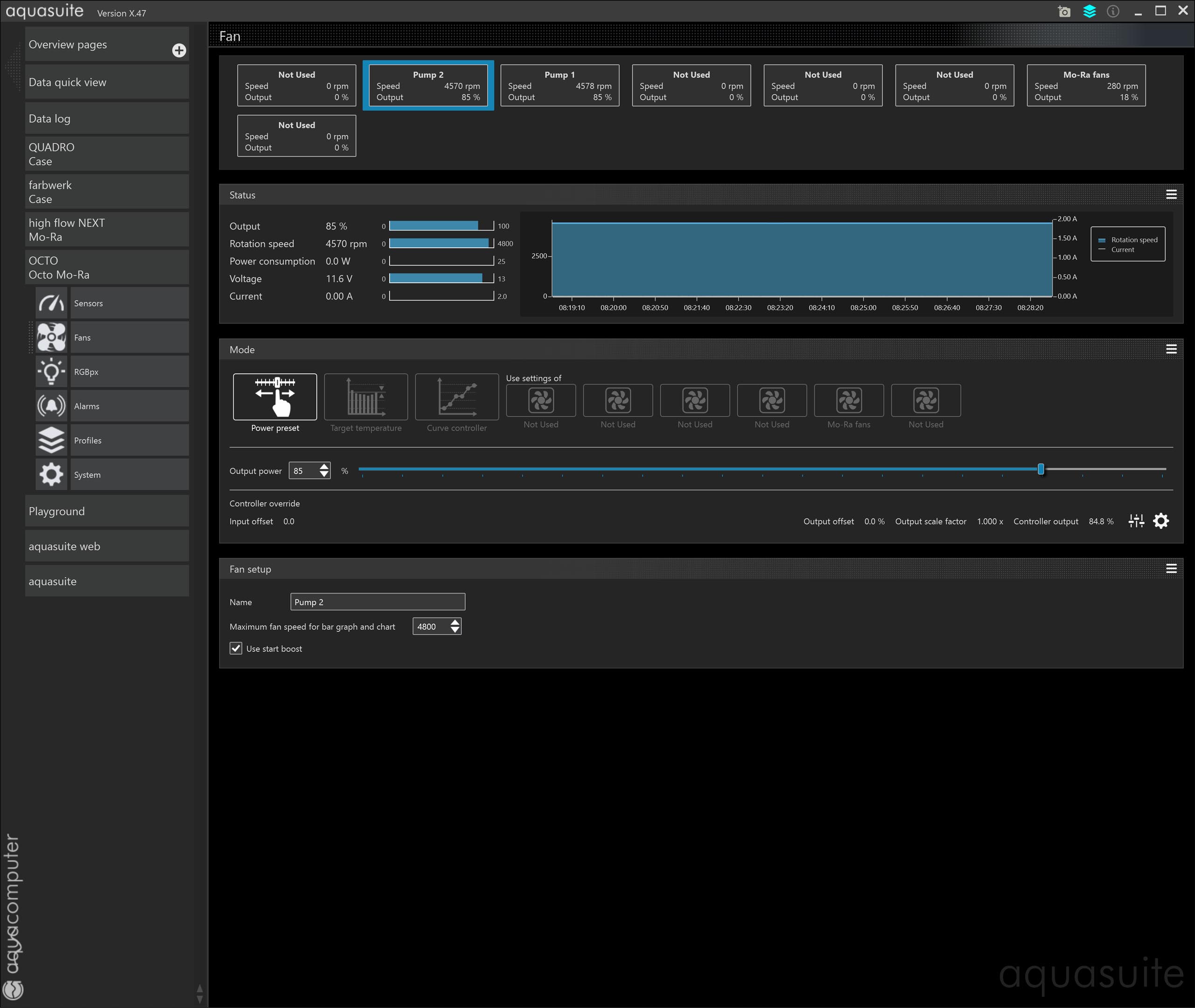

  • set PWM port 2 (pump 1) to Power preset @ 85% {port2_set.jpg}

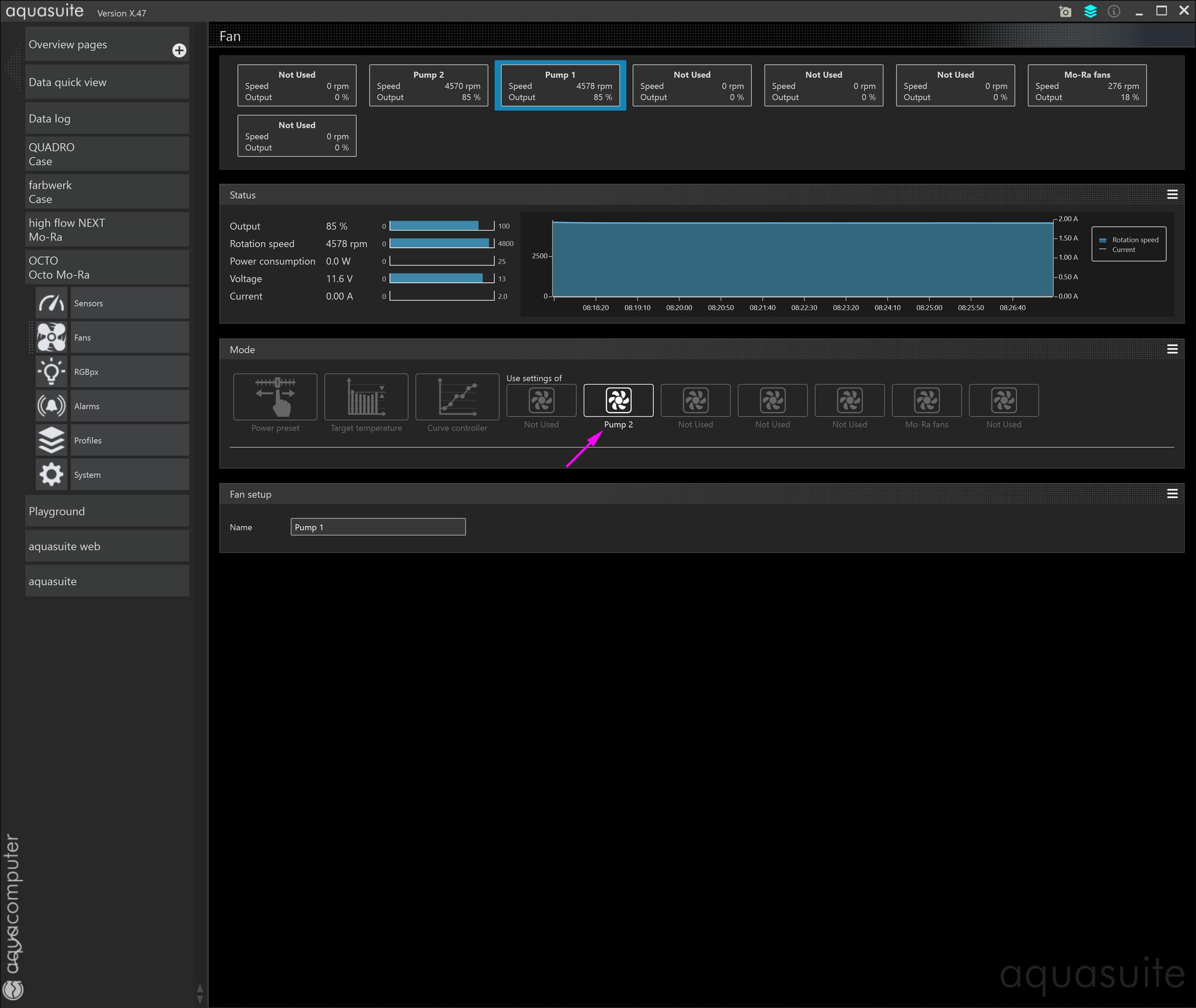

  • set PWM port 3 (pump 2) to mimic PWM port 2 (pump 1) {port3_set.jpg}
  • set PWM port 7 to a curve controller {port7_set.jpg}
  • execute a cold start
  • after cold start PWM port 2 has no issue {port2_restart.jpg}

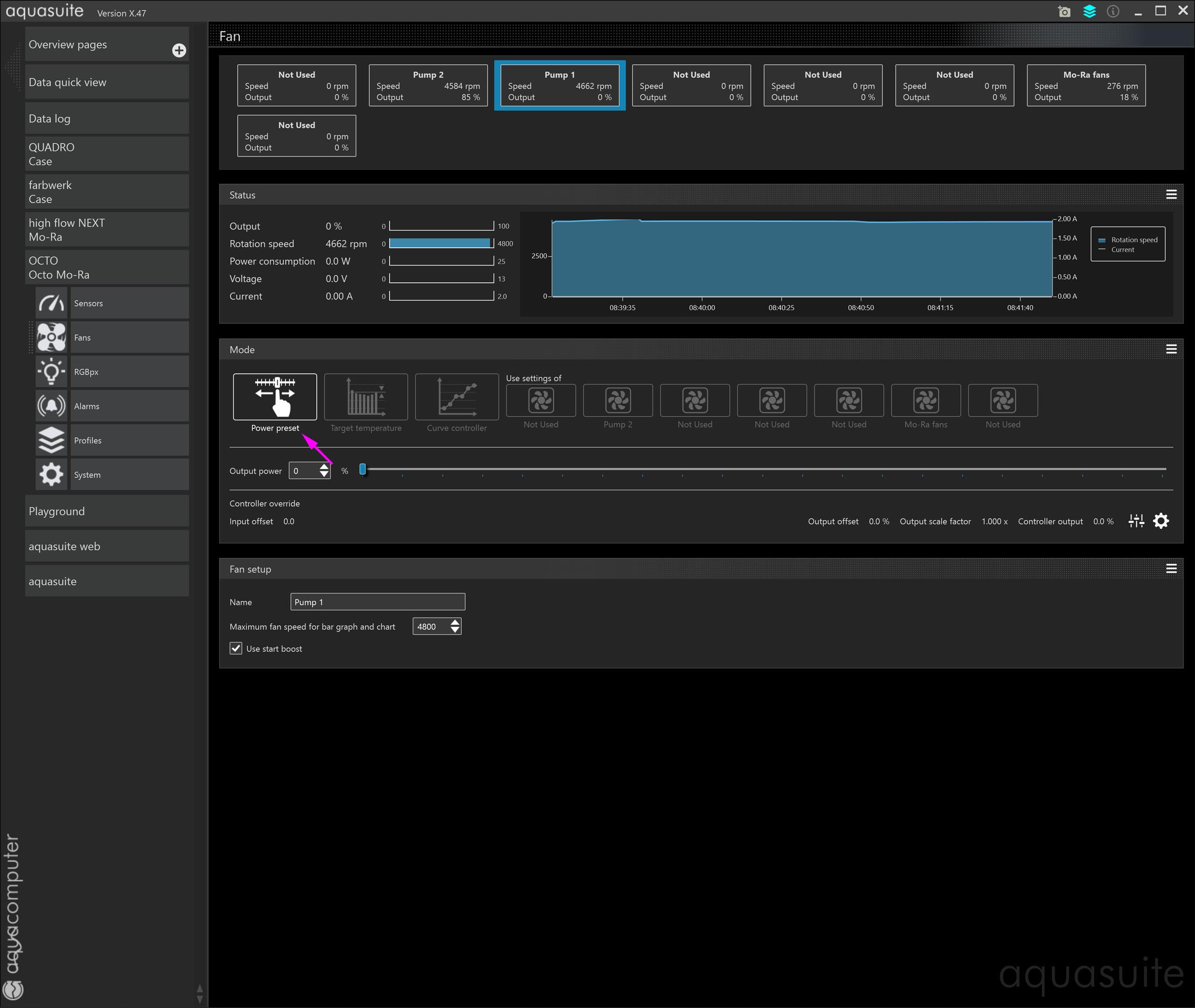

  • after cold start PWM port 3 sets itself to Power preset at 0% {port3_restart.jpg}
  • after cold start PWM port 7 sets minimum temperature to 1 (from 2), the curve looks similar {port7_restart.jpg}

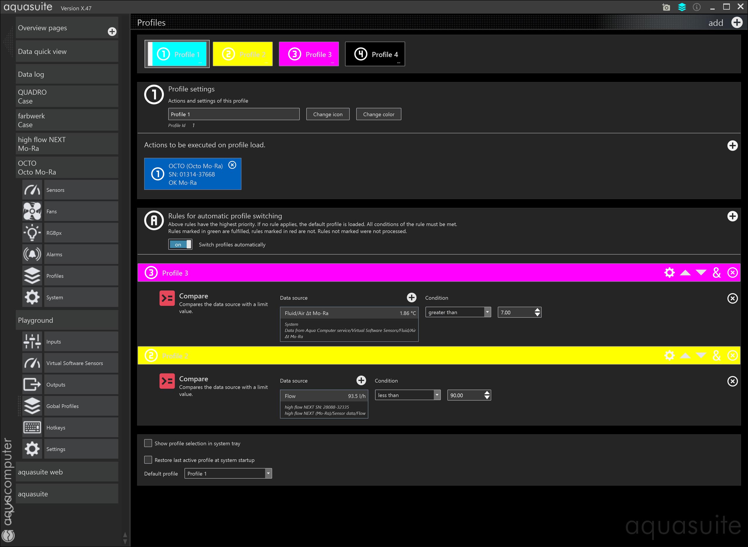

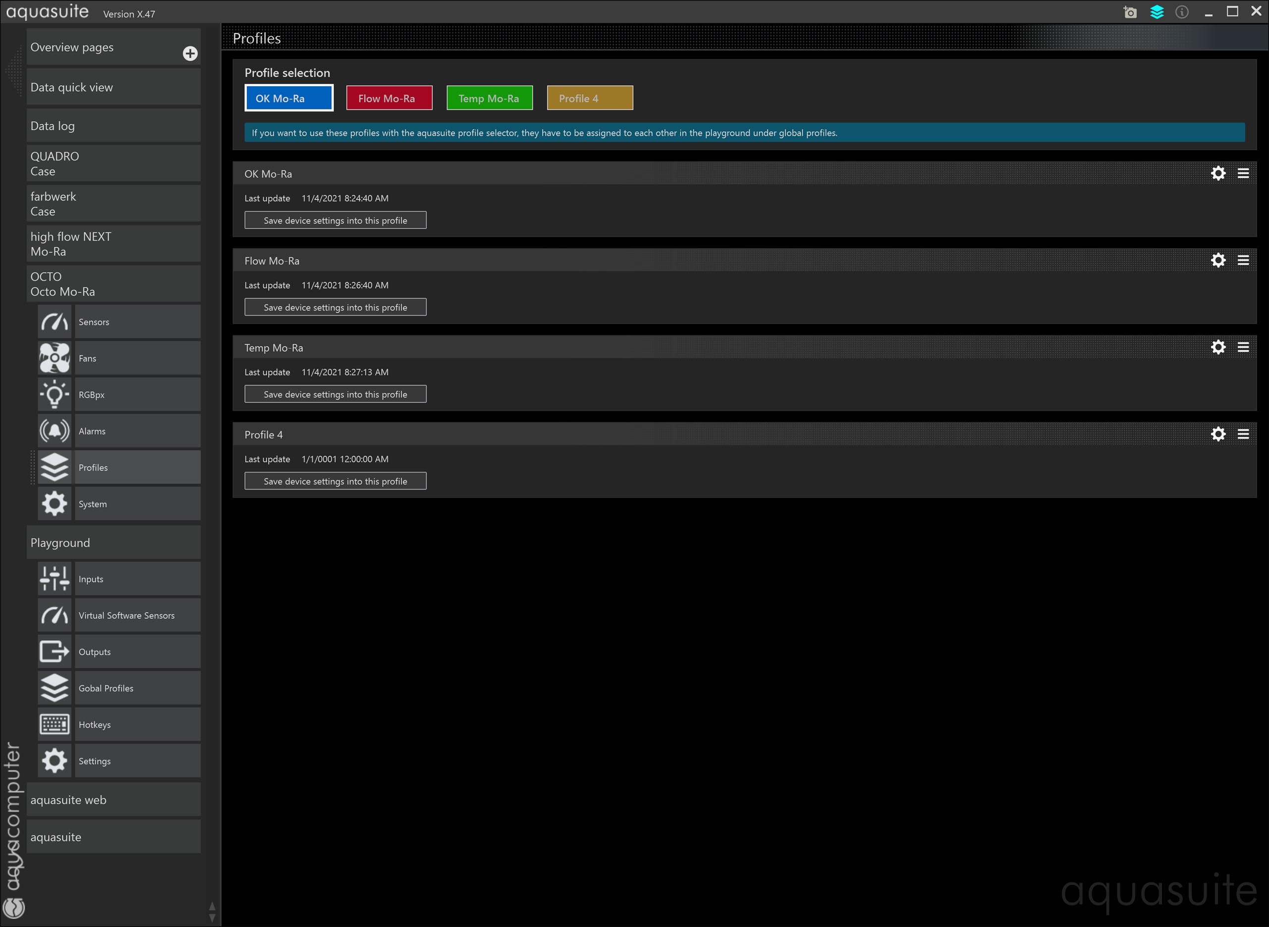

I have 3 local profiles on the OCTO, with the only difference being aRGB control.
  • normal: breathing color 1
  • low flow: blinking color 2
  • high Δt: blinking color 3
  • local profiles: {lp.jpg}
  • global profiles: {gp.jpg}
  • Initially I did have a Power preset on Pump 1, and 1° for the low temp on the fans
