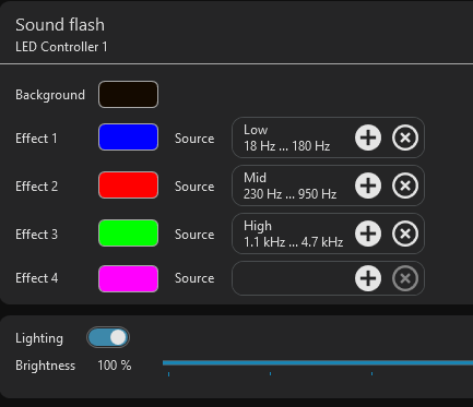

Rainbow RGBpx stopped working after ~30 minutes.
D5 Next pump has 4 profiles set as follow:
  1. Sound Flash (4 lights patterns with blackout)
  2. Sound Flash (without L + R audio source)
  3. Rainbow
  4. Lights off.
When I listen to music, both Sound Flash profiles flashes according to music played. This last throughout the day yesterday. Nothing unusual there. When I selected profile 3, all LEDs have rainbow patterns. Went to take lunch and came back, all LEDs off. Switched back to profile 1 and 2 but only lights that are linked to highflow NEXT works. D5 Next RGBpx still off.
Has anyone observed such behavior in their setup?
