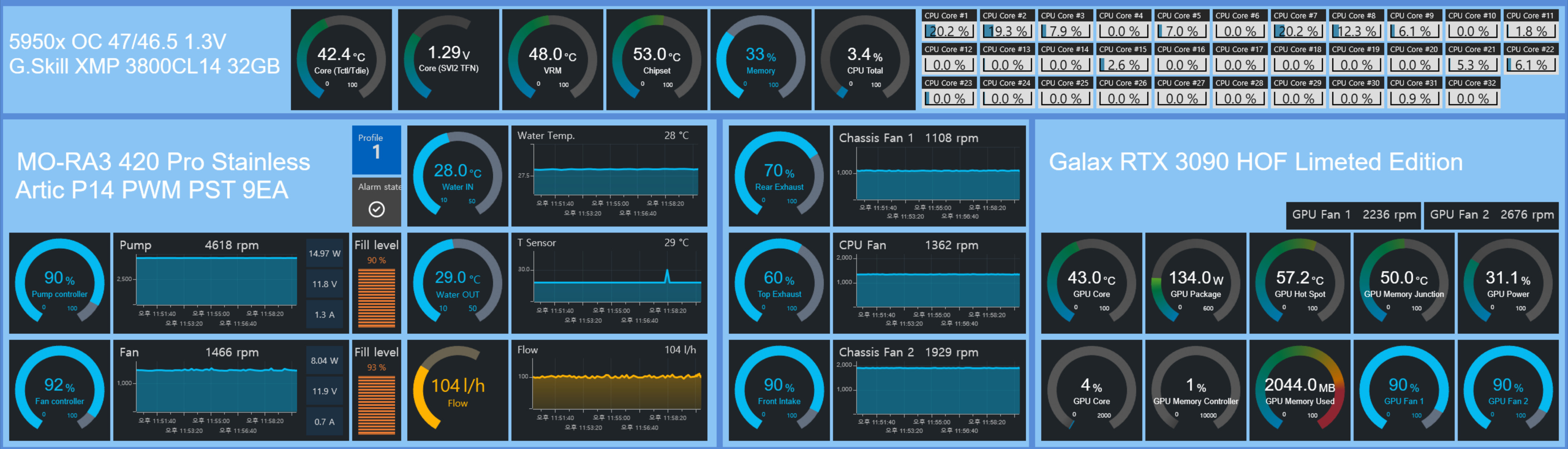

While dual moniotrs are used, I need a 3rd small monitor having 3840X1100 resolution for the purpose of only monitoring sensors. I like HWiNFO64 program as a monitoring tool but try to use another tool, Aquasuite program. Although I am not expert at XML language, with the help of googling, I managed to make a layout for sensor-display panel, based on tools and function of Aquasuite. Here is the screenshot,

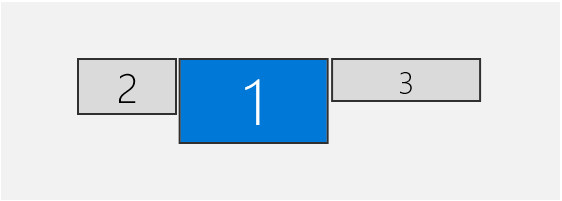

In Windows 10, triple monitors are recognized perfectly and located by this configuration
monitors_windows.jpg,

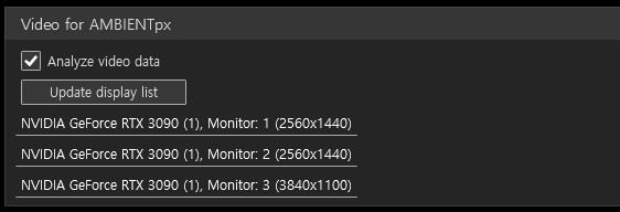

where monitor 2 is QHD, monitor 1 UHD, and monitor 3 a panel for sensor-displays of resolution 3840X1100. But a mystery happen in Aquasuite, which realize the triple monitors as
So, I set up a coordinate for the window of the sensor-display layout at (2560+2560,0), neither (2560+3840+1,0) nor (2560+2560+1,0). Maybe, the grid option will affect the +1 offset to be ignored. This is fine. More than worse, Aquasuite actually realized the vertical resolution of the 3rd monitor as 720p, not 1100p ! Aquasuite told me that the 3rd monitor has a resolution 3840X1100 but, in reality, I can use only 720p. That is quite odd. How can I resolve this problem?
2. How can I optimize my layout?
Maybe, I may include too many sensor displays in the layout, which cause my system to slow down while the GPU only consumes just 160W. For example, while sensor-monitoring on, Youtube or Neflix have instaneous stoppings occasionaly and this cannot be happend when I played AAA games consuming over 400W. With only a Youtube window, GPU consume 130~150W. That is huge. Anyway, I can endure this point. The problem is that there exist mismatches reported by Aquasuite, HWiNFO64, and HOF AI Suite. The mismatched sensors are values of GPU core usage, GPU Memory Controller, GPU Memory Used, etc. About the sensors of the graphic card, the two program, HWiNFO and HOF AI Suite report the same values, although the additional monitoring panel for HOF Limeted Edition show the breaking graphs. But the values reported by Aquasuite are different. According to Aquasuite, my GPU is almost working of 1995MHz GPU clock and 9751 MHz Memory clock, etc. For reference, I do not overclock my graphics card, which, as a default, has maximum clocks 1860 MHz and 9751 MHz of GPU and GPU Memory, respectively. How can I fix this situation?

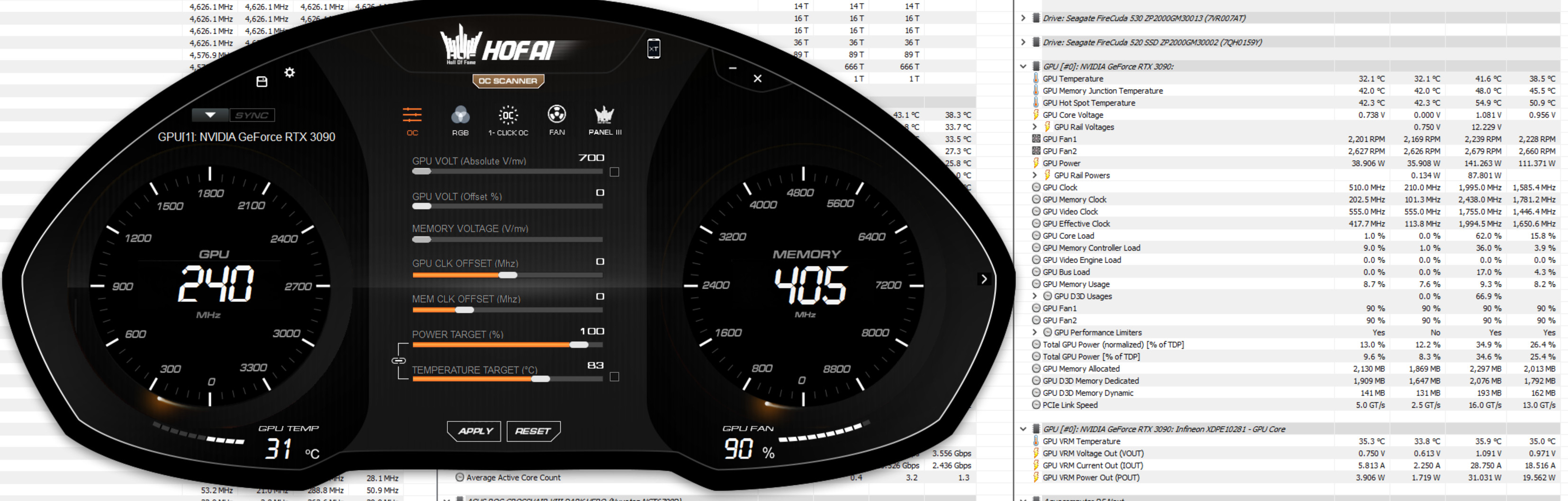

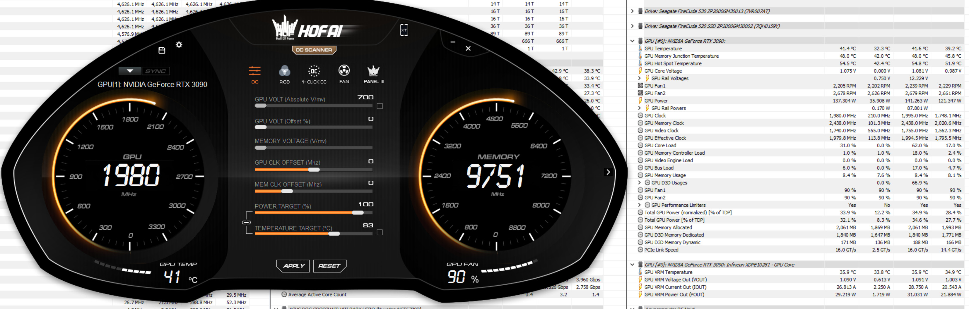

For comparison, I attach another screenshots of HWiNFO64 and HOF Ai Suite, reporting the states of turning on and off on-sensor-display panel by Aquasuite respectively (Of course, the sensor panel shows different values for GPU relevant.)

Regarding your first question, I think your first monitor is an LG 32GP850 which is 2560x1440 (QHD) (aspect ratio 1.78:1), which is what Aquasuite (AQS) shows. Your post says it is 2560x1280. I think your second monitor is an LG 32UN650 which is 3840x2160 (4K UHD) (aspect ratio 1.78:1). Your posts says it is 3840x2560. AQS shows that monitor 2 is 2560x1440 (same as monitor 1). In this case, it does appear that AQS got it wrong for some reason. I would check what resolution it is actually running at. Maybe Windows is running it at the 2560x1440. If you can't get it to do 3840x2160, make sure you have the right drivers loaded for it.. Your 3rd monitor appears to show up OK in AQS as 3840x1100.
Assuming your first monitor is 2560x1440 and your 2nd monitor is 3840x2160, then the upper left hand pixel of the 3rd monitor should be at (2560+3840, 1). I am not 100% sure if the "Y" coordinate should be 0 or 1. If you put that coordinate in for the upper left most item in your Overview page layout, it should appear on the 3rd monitor in the upper left hand corner. Then you have to calculate the coordinates for each and every item in your Overview page based on that starting offset. It should work, but I don't know why your second monitor is listed in AQS as 2560x1440. If it really is running at 2560x1440 then the upper left hand pixel of the 3rd monitor should be at (2560+2560, 1 (or 0)).

Regarding your second question, I don't know why AQS would report different values for GPU and GPU Memory clocks. I would go with what HWINFO and the HOF AI Suite report. Accurate reporting of GPU stats can be affected by the drivers. Also NVidia has been known to have reporting bugs. The author of HWINFO keeps up with the latest hardware, drivers, bugs, etc. and is constantly releasing updated versions. I would also trust a monitoring utility offered by the GPU manufacturer over what AQS reports. Finally, I think that Aquacomputer has disabled monitoring of some NVidia stats because of a known NVidia bug. They (Aquacomputer) were getting complaints about something that was not their fault or in their control, so they just disabled it until NVidia gets around to fixing it. There are posts about this on this forum. EXAMPLE
AQS has direct monitoring but I don't use it. I just run HWINFO and use Shared Memory Support to import everything into AQS.I don't see any reason to have AQS also polling the same sensors. This just increases CPU load and the chances of having a polling collision. I know that HWINFO uses the proper global mutexes to queue polling requests. Some other programs (like Corsair icue) do not synchronize their sensor polling, which results in collisions, which can result in bad data and even system crashes. I think that AQS does use the proper methods to synchronize their polling requests but I am not 100% sure that they do this in all cases. I just leave all of the AQS direct sensor polling deactivated so I don't need to worry about it.

Secondly, I checked resolutions of the three monitors accoding to your advice. I check the resolutions by using the site of calculating screen size and identifying again both Windows and NVIDIA setting pages. The result is that AQS report the wrong resolution.
May different connections of monitors to VGA ouput ports cause any problems? I think that it be rarely occurred at the present modern era. However, QHD and UHD are linked via DP and the small monitor via HDMI. Sometimes, the fast way to decide where a booting screen appear between monitors is to just use the leftmost DP port.

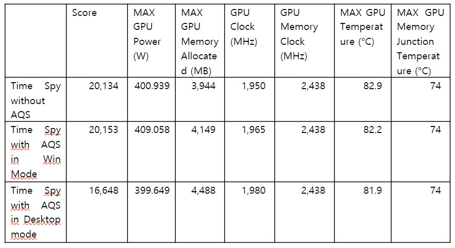

Actually, I considered this method as an alternative, although there were a few unexpected things. Thanks Remayz for reminding me again to use AQS in Windows mode. At first, it is tedious for me to re-medy the existing layout to fit AQS in Windows mode on the small panel, but not difficult. The real problem, especially for me, is hidden behind. However, I'd like to check again how much AQS in the various modes impact the graphic performance of my computer. Usual usages like opening many web-browsers, watching Youtube or Neflix, etc looks fine, while AQS in Windows mode is running on my little panel. Nextly, I ran Diablo II Resurrected (D2R) and moitored sensors about graphic card by using HWiNFO, HOF AI Suite, and AQS. Qualitive observations seem to indicate that I may run games wilth AQS in Desktop mode. I did not measure FPS intentionally.

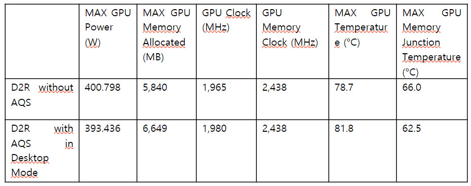

Now I ran Time Spy of 3DMark and also observed several things qualitively.
Up to this point, AQS running in Windows mode operates quite well, compared to HWiNFO. But there is a serious problem from the viewpoint of me. My graphic card has an additional LCD panel, which correspond to one of the discriminations to the other line-ups of Galax RTX 3090. The LCD panel shows the information from HOF AI Suite program via USB. During obsevation, the sensor panel showed insane fluctuations about GPU status. For example, my memory clock seemed to forget to go lower than 9,751 MHz.
  • HOF AI Suite + HWiNFO => No problem
  • HOF AI Suite + HWiNFO + AQS => HOF panel behaves madly.
  • HWiNFO+AQS => Not perfect but I can endure.
  • HOF AI Suite + AQS => Just imagine..
The real problem is that I can not give up the HOF sensor panel. So I will use AQS when D5 Next pump is needed to setting-up and decide to buy another portable monitor to use HWiNFO usually and dual monitor for my old laptop outside. That is my story.
Thank you very much for interesting posts. Those are good to me.
ps) I am sorry for not uploading the images of monitoring result because of the file size.
ps) I failed to create tables by only characters so uploaded screen shots.
