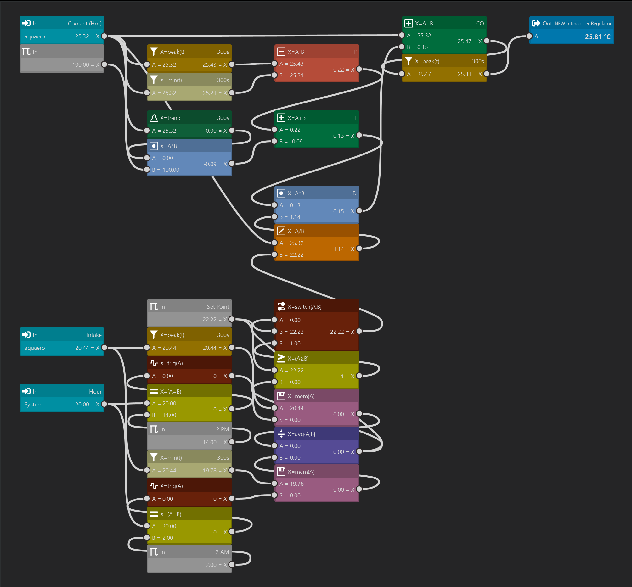

I give you the Intercooler Regulator (radiator fans) version of the Thermal Regulator.
It's said that man cannot live on bread alone, and neither does flow. Flow demands cooling. Cooling requires control. Control brings order from chaos. You demand the most from your system, so why shouldn't it get what it needs to do your bidding?
This powerful expansion requires your system to know how hot the loop is at the hottest point. Don't have a temperature probe at the end of your components? Jury rig a sensor to the intake side of your hottest rad with electrical tape if you must, just make it sensitive enough (+2.1K works well) to get close. Add 2C to your cold side if you must, but the goal is to get that data. It's important. Your system is important. It's all about the data.
It takes that hot liquid temperature and over the past five minutes, captures the coldest and hottest it's been. It finds the delta and multiplies it against the current hot point. Using the logarithmic function between the filtered current and highest points to estimate where the thermals are going to go next. Yet, like Salt Bae, another adds the delta between your intake to the coolant to the lowest temp for a dash of realism. It adds more for when your system is outside your comfort zone. More on that in a moment... That's where you need to know the ambient temperature of your room. Preferably, you want a thermal sensor at one of your intakes for the best reading. Case internal is useless, you need to know what the temperature is where your case is. The floor may be cooler or hotter, or your something blocks flow from your air conditioner. Maybe a big honking fan in your hot room isn't circulating air well where your case is.
Using that intake, use the set-point in Celsius to define your personal (you, not your computer) comfortable temperature in the room. Do you like it at 72F? Do you like it at 69F? Is 74F your highest tolerance before it's too hot? What you set your thermostat to for your comfort should be this number. It should not change after this point. If it must change, add another set point and average their output or somehow come up with an automatic switch to determine the desired point between summer and winter. That part isn't the goal here. The goal is control.
Getting the delta of the intake temperature with this set point, it's added to the now filtered estimate of how cold your coolant can get given the power of your rad(s) and your present load. Using this data as a switch controller, when the ambient room temperature is outside your comfort zone, it adds a fudge factor to boost the fans a bit more than normal. When the temperature is at or below your comfort zone, it uses the lower value to avoid overdriving the fans for no reason. And for 5 minutes, it holds that peak, rounded to the nearest tenth of a C to provide your fan controller(s) a picture of where your rig expects the coolant temperature to go.
Combined, these two regulators will balance and compliment each other. No longer do you need to worry about having to decide between fan or pump noise. You no longer need to decide between high fans or high pump, or both, or neither. Your system will find the optimal combination between pump and fan speeds to realistically cool your system based on your room and it's location within it. The feedback from the thermal and fan regulators independently determine whether your system needs more turbulent flow or maximum power to lower those temps during the most frenzied of loads. Not so jumpy, but "fluxxy" enough to surprise you with well managed coolant temps to help mitigate thermal throttling at best for you "must be silent" folks to let your system soar through the digital expanse.

Download the Virtual Sensor XML files to import into Aquasuite X.57: Thermal and Intercooler Regulators.zip
Updated 10/2022 -- Intercooler Regulator: Redesigned to remove averaging for quicker response, and applied automatic room temperature averaging.

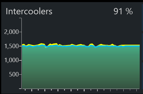

The Intercooler Regulator sensor has 2C lower liquid temperatures at low to normal use and takes a little longer to saturate under high load. Under high load, the Delta-T is on par but liquid temps rise a little quicker. Again, indicating that the Intercooler Regulator is a "nice to have" but not necessary when used with the Thermal Regulator (on pump). The test used the same configuration I already had on two separate profiles - One running both my sensors, the other running Delta-T on fans and my sensor for pump. Also noted that the Intercooler Regulator cooled the liquid faster than the Delta-T, which lowered the fans as the temp lowered, which slowed the cooling of the liquid over time. The Intercooler Regulator stayed at the higher fan speed for 5 minutes before moving downward, which sped up the cool down.
<-- The hills and valleys = Delta-T Sensor. The smooth tail-end is after switching to the Intercooler Regulator.
--> P.S. Both Regulator do not add delays to increase speeds. They do delay turning speeds down from higher speeds to ensure the need has subsided not simply gone down for the moment. They react instantly to increased temperatures.

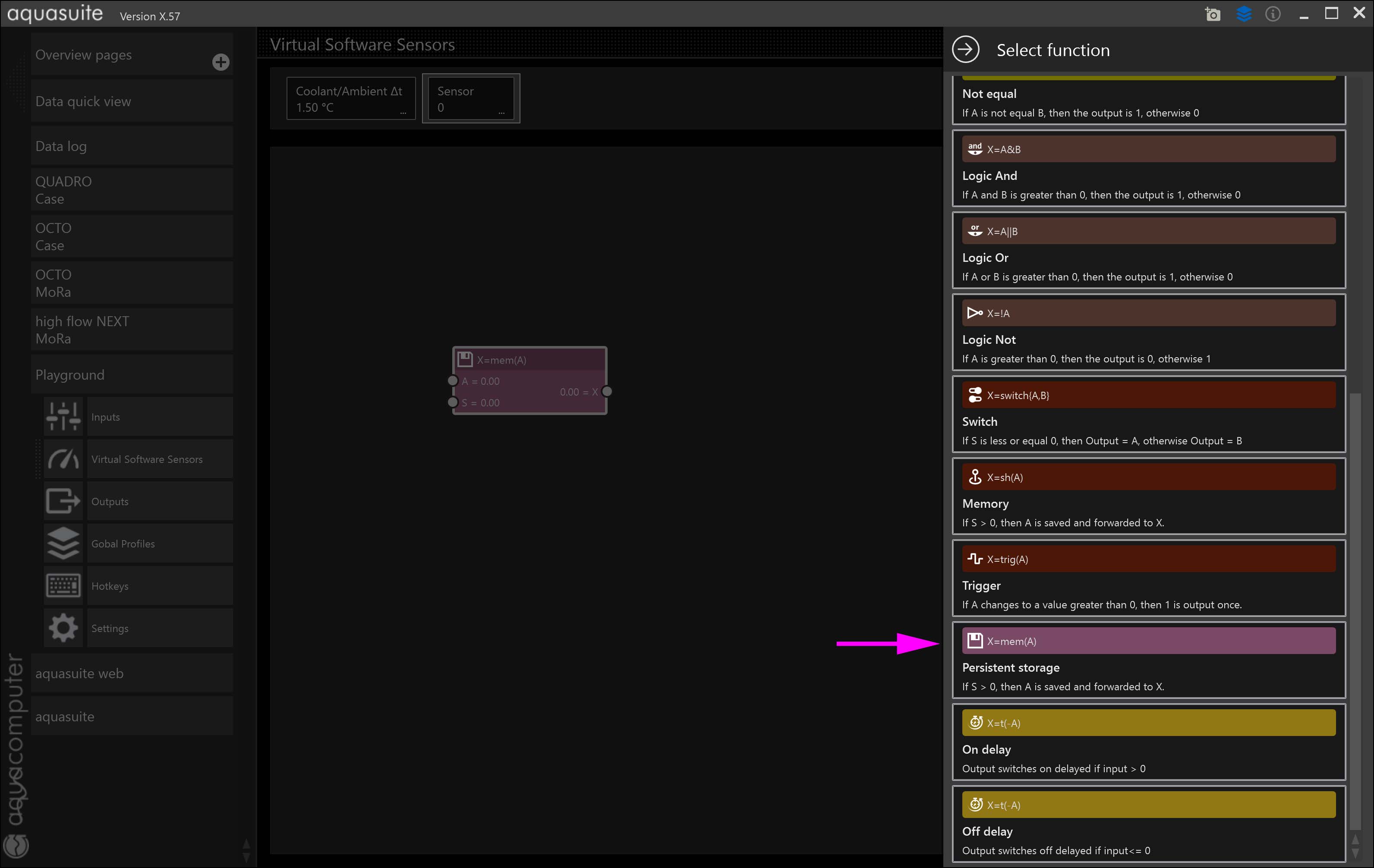

You may want to look at using the Logical Function X=mem(A), I believe it persists through a restart (x_mem_a.jpg)
Teknophage
Logical function mem(A)
Dienstag, 20. September 2022, 04:32
Thanks for the advice, InfoSeeker. I'll test that out.

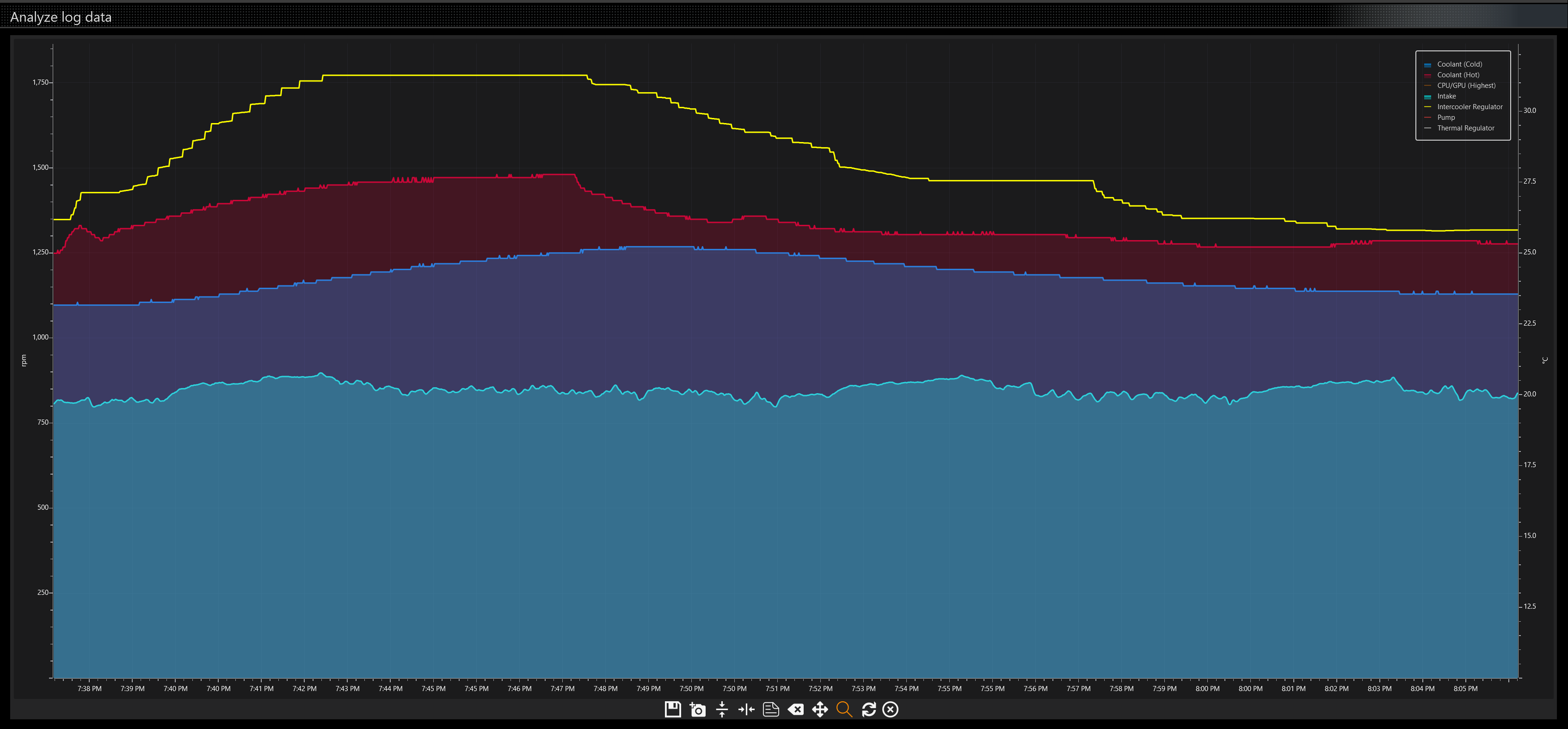

Well from the test i just ran it is extremely inefficient, i am sorry ^^'
It's also very jumpy, which came as a surprise.
I didn't tweak the sensor besides remapping the aquaero sensors to the same ones on the Octo and attributed it to my top radiator to see some fan speed changes.
When i started loading the loop, it reacted way fast, before the water had a chance to warm up, which is basically noisy for no cooling benefit (a bit like controlling a water loop from CPU temp instead of water temp) depending on the fan curve you set. (mine is fairly gentle).
It then stops rising and flatlines while the water warms up, then starts to pick up the rise and increases to match the delta T curve. So in the end it will arrive at the same point but in huge steps instead of giving a slow steady increase, which is way more noticeable in terms of noise, and not efficient in terms of cooling since it doesn't follow the radiator efficiency increase.
On the graphs, i've overlaid the intercooler with a red line on top of the delta T graph.
the spike in top rad speed was when setting the fan curve, disregard that :)
Now, when i opened my window, it was actually funny lol
The temp fell below my comfort temp setting and of course it slowed down the fans instead of cooling down the water. Silly me.
My mistake but i still fail to see what this setting is useful for, besides impeding cooling when the rads are more efficient.
And after the delta T has stabilized, the intercooler takes over 5 minutes to start responding and accelerate the fans. If i had set all my fans to that sensor, as soon as the room would have cooled, the water temp would have shot up when the fan speed drops.
When stopping the load (thanks Teams meeting for keeping the GPU boosted), the delta T cuve slows down the fans slowly, but the intercooler keeps my top rad at speed until i only hear that one.
When the sensor finally reacts, it's again pretty steep and noticeable
For all intents and purposes, it basically acts as an unstable cooling dampener, which may actually be noisier depending on how steep your fan curve is.
Adjusting the averaging times will create the same curve but more compressed in the time axis (more noticeable fan jumps).
It kind of confirms to me that the sensor really is tailored to your loop. With all the radiators (and water volume) you have, you already have some massive hysteresis and overkill cooling capacity for the load, so you may not see that very erratic behavior, or you see it but not at the same scale.
The delta between ambient and water temp being a direct reading of the radiator efficiency, i really don't see why one would not follow that curve since this is what gives you the most efficient fan curves in terms of cooling.
Edit : no offense! i may have come out a bit rough :p maybe my trial can serve as an example of how your sensor works on a smaller loop. that exacerbates the sensor responses and may show things you couldn't see on your particular loop.
Dieser Beitrag wurde bereits 1 mal editiert, zuletzt von »Remayz« (20. September 2022, 14:43)

@Teknophage, I just saw your fan curve when using delta T as control variable.
If it is that jumpy you have some sensor problems. Look at the curve i get, it's completely smooth, and i only use a 10 second averaging on both water and ambient temps to filter out noise in the reading in the decimals.
If your temp reading are unstable, there may be something off with the sensor itself or where the ambient one is installed

Teknophage
@Remayz - The Intercooler Regulator has been redesigned, thanks to your information.
Montag, 3. Oktober 2022, 03:57
I'm thankful for the information you supplied. I was able to identify a better approach. Using the X=trend as you recommended, I came up with a better formula that better fits expected behavior. What cptninc is describing as a built-in PID is really just the controller itself. While simple, yes, it does not have a self-corrective feedback loop. They have more in common with a household thermostat than an electromechanical PID device. They can't estimate how much corrective action to implement based upon a weighted additive.
The new design resolves a few noted issues: Chiefly the lag you experienced. By using the trend as recommended, it provides gain to the average between high and low over the past five minutes. To answer the question about set points, the set point is the average between the high and the low over five minutes. That explains the initial jump you saw, but because there was no gain function, it held there until sufficient heat had registered. That was a problem that escaped me.
The differential between average ambient temperature and the present temperature of the hot is better accounted for and multiplied against the integral. This is as close to the Ziegler-Nichols method of the PID formula as possible, while eliminating a hard set point. You'll note that the ambient temperatures are now auto-averaged. There's still a place called "Set Point" which is intended for setting one's comfortable room temperature. This one is set by default to 72F. Anything lower than this is taken to use as the set point. Anything lower is the average of the room's daily day/night high/low cycle. I put that in there really as an override if the room gets too hot.
Aside from these changes, I've removed the rounder. Give this one a try: Thermal and Intercooler Regulators.zip
As mentioned, the whole idea to bring this out to others is to help others and gather input to improve it.

Remayz
Montag, 3. Oktober 2022, 10:51
What is that blue "Intake" sensor? fan speed or temperature?
It looks unstable AF. I still feel if your sensors were stable you wouldn't even need to bother with overcomplicated sensors to try to find a useful signal out of that noise ^^'
If it's a fan speed.. same deal, teh readouts on my octo are dead stable.
Temp sensors see variations only at the second decimal, and still, on water it's like -+0.01°C . This is what i am smoothing with that 10sec averaging.
