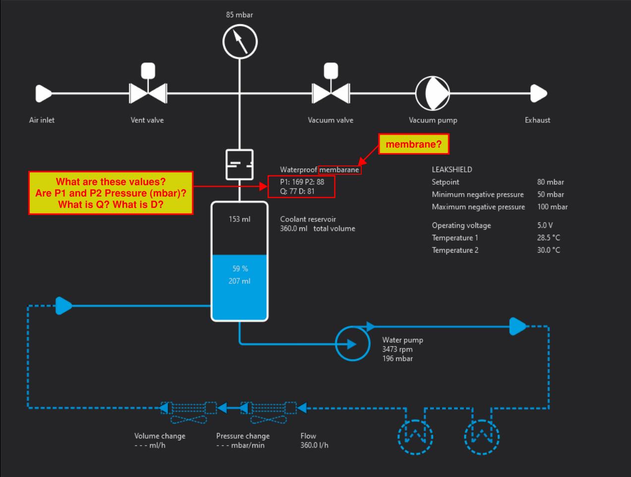

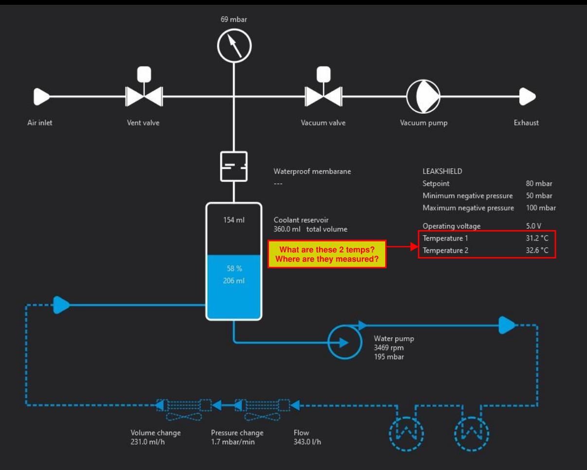

My Leakshield Status page includes 2 temperatures. I could not find any mention of them in the manual. Does anyone know where these temps are measured? Also, what do the values P1, P2, Q, and D mean?

This are internal Temperatures from the device, this temperatures are used for compensate temperature drift.
Mittwoch, 5. Oktober 2022, 02:36
Thank you for your response, but could you be a little more specific? Since these temperature values are displayed, it seems to me that they should be documented. Where are the temperatures measured and what influence do the values have on the operation of the LKS? You said they are used to compensate for temperature drift. Can you explain this in more detail?
Also, under where it says "Waterproof membrane" there are values for P1, P2, Q, and D. In my screen shot above, these items do not appear. The LKS was in Monitor mode when the screen shot was taken. Values for P1, P2, Q, and D appear if I do a Measure Fill or go from Release mode to Monitor mode (which does a Measure Fill). If I go from Monitor mode to Release mode, the numbers do not change. If I go from Release mode to Monitor mode, P2 changes a little but the rest do not change. If I go to Shield mode, they all change. If I go from Shield mode to Monitor mode or Monitor mode to Release mode, they do not change. They do change in De-aerate mode, but they seem to only change once then they stay the same for the rest of the De-Aeration cycle.
I am guessing that P1 and P2 are pressure high and low limit values in mbar. Is this correct, and if yes, pressure values where? Why do they change for some mode changes that affect pressure but not other mode changes that affect pressure? What is Q? What is D? Since these values are displayed in LKS status, they must have some meaning. If their meaning is not meant for the user to interpret, why are they displayed?
Finally, is the word "Membrane" spelled "membarane" on purpose? I thought maybe this is the German spelling but Google says German for Membrane is Membran. Is this just an oops? I am not trying to be "nit picky". I just want to understand what the information displayed in the LKS Status diagram means. Thank you in advance for any additional details.

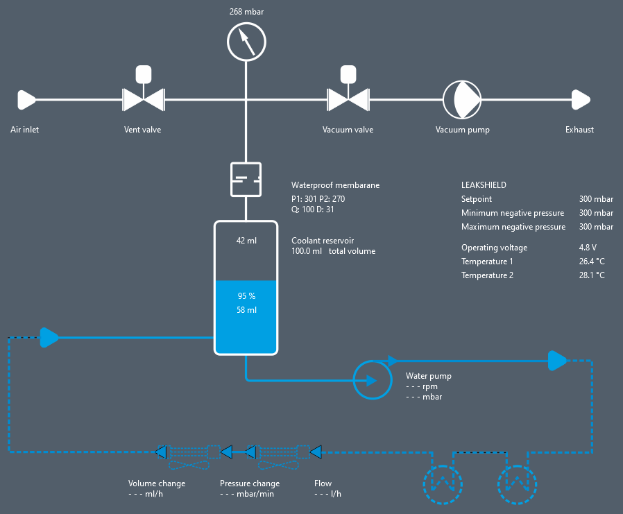

Q seems to vary depending on the mode I select
Sonntag, 9. Oktober 2022, 03:10

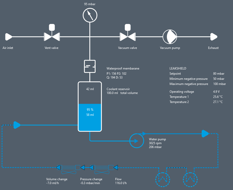

D adds up as the difference, on Monitor-Q194 D is 53 when the difference is 54 as the numbers are rounded and when I checked the actual numbers 53 is correct.
Q seems to vary depending on the mode I select, so there must be more to it than a simple indication of how much the system leaks.
I too would also like to know where the two temperatures are measured,
»red-ray« hat folgende Bilder angehängt:

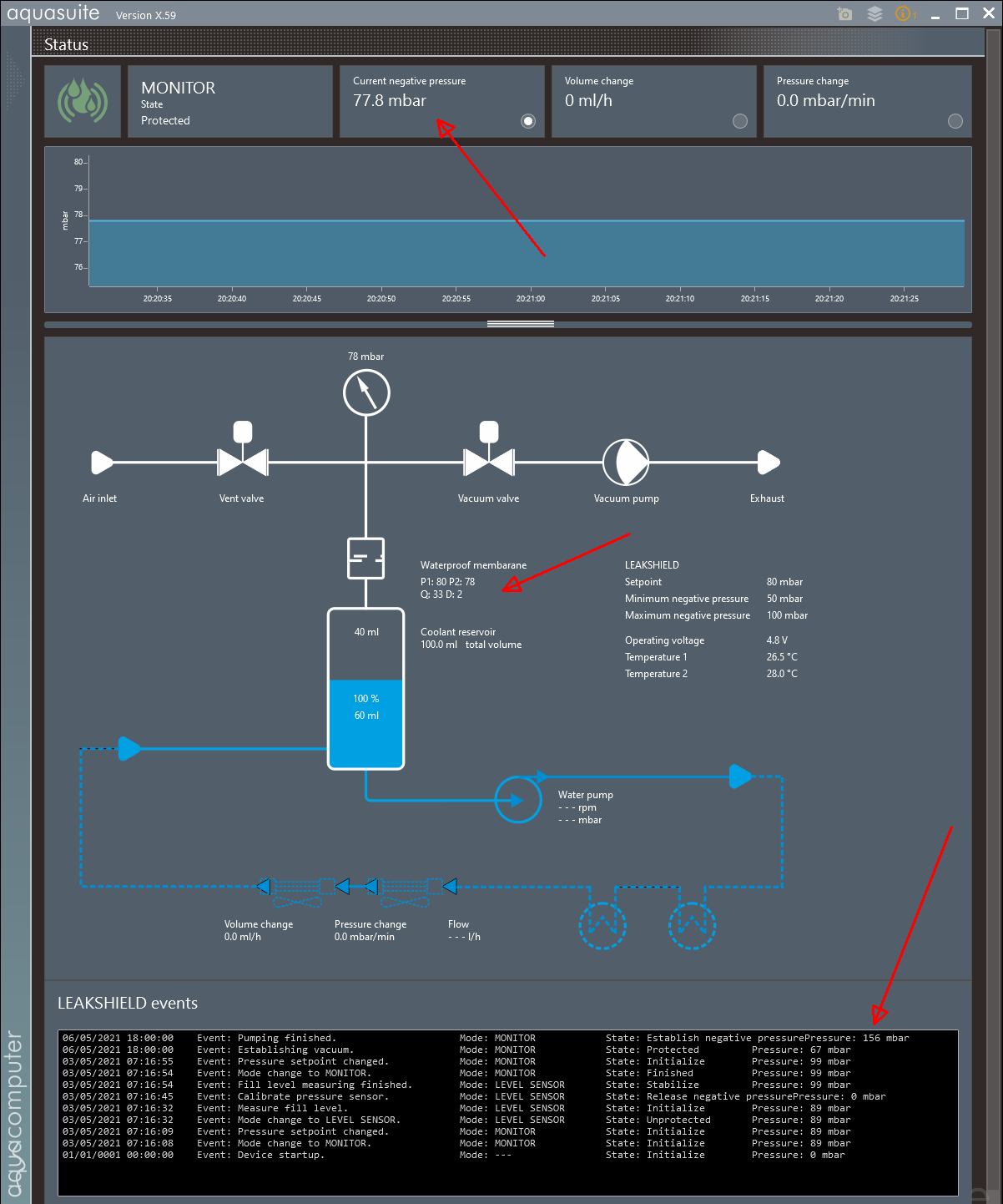

I have noticed that after about 3 days my LKS does Establish vacuum and after it has done this I noted:
  1. The event log reports a pressure of 156 ⅿ㍴, why so high?
  2. The reported pressure is 77.8 mbar, why so low (it's lower than the Setpoint!) and why isn't it 156 ⅿ㍴?
  3. The membrane values changed to P1: 80 P2: 78 Q: 33 D: 2, why did these values change and why are they so different to the values after doing a Measure Level?

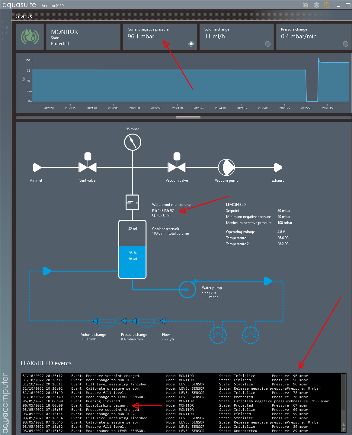

After doing the Measure Level the values I see are very different, why? They are:
  1. Event log 96 ⅿ㍴
  2. Reported pressure 96.1 ⅿ㍴
  3. The membrane values were back to P1: 148 P2: 97 Q: 185 D: 51
I suspect it would be much easier to understand why the values are so different if what they represent was fully documented.
