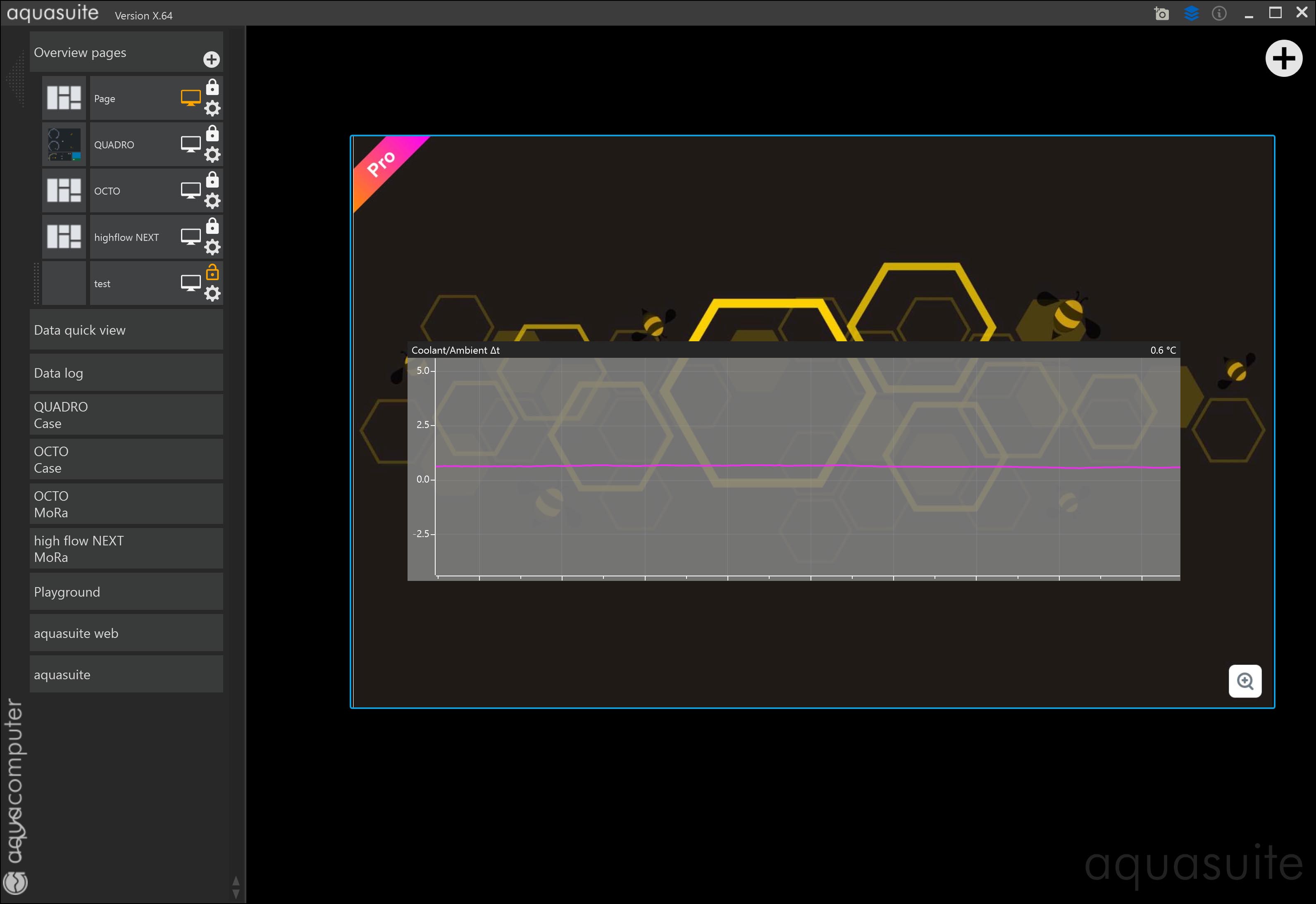

I don't speak xaml... but I can order a beer and ask where is the bathroom
Is this along the lines of what you want to do? (hexy.jpg)

Is this along the lines of what you want to do? ([attach]9987[/attach])
Well ... yes but not as crudely as that :). At least you illustrated that I can put something as a background but I am guessing(!) not an interactive background. I would classify this as a baby step forward. Thanks for the start :D
Freitag, 13. Januar 2023, 17:19
Indeed, concept only.
I believe if you make three identical display pages, each with a different background color, you will be able to switch between them using global profiles triggered by the parameter you want to control it

Thanks guys. This got me started. Going to trail gimping up a background and then dropping stuff on it. This is very much a work in progress.

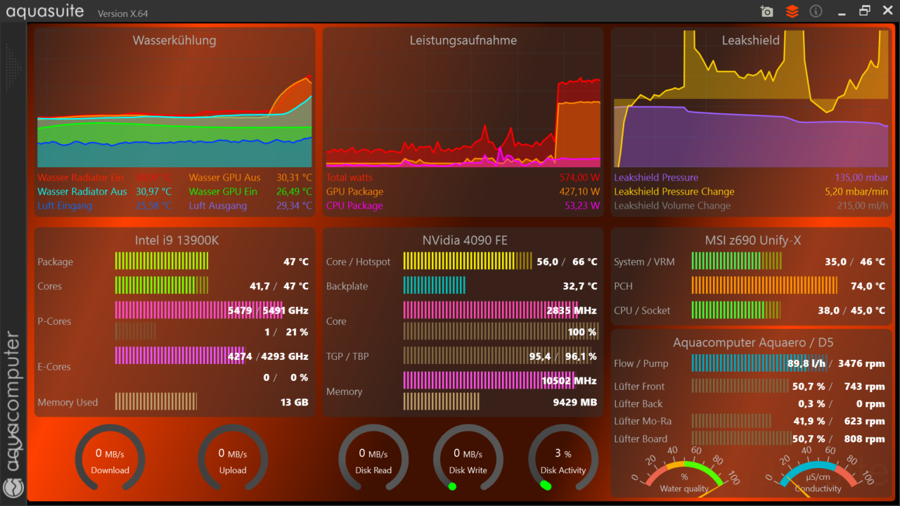

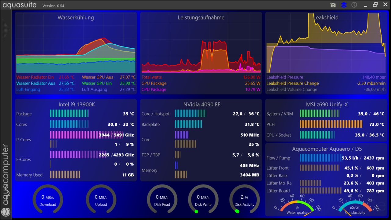

+ WAY more flexible rendering engine. With the XAML you can do about anything, but you really have to get inside of it. For example, I wanted to have a custom background based on the AS profile that's currently active, showing a color grading. I was able to get this to work in about an hour with XAML.

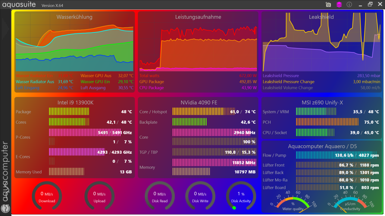

Here's my panel I've created. It's packed with information, just the way I like it. The three background colors correspond with my three global AS profiles which switch based on the water temperature (blue: idle, red: load, rainbow: extreme load):
