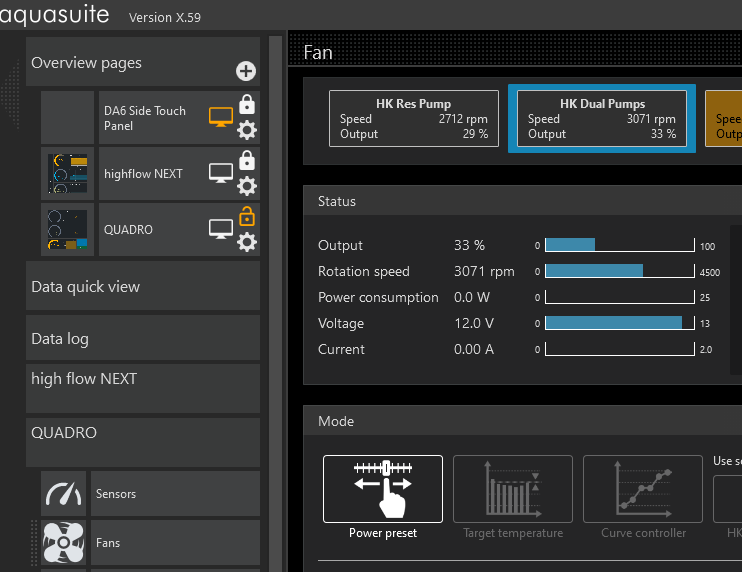

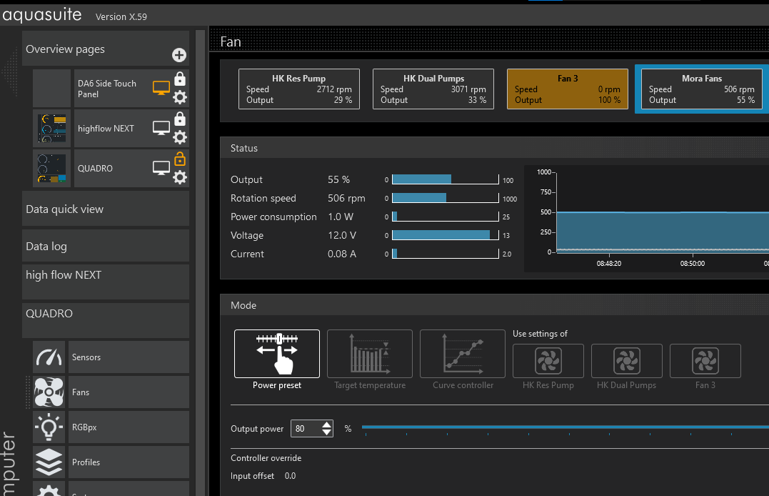

The Quadro is reporting the current draw/power OK for the fans (here 0.1A/1W in screenshot) but does not report current/power for either of the headers with pumps.
Any way to solve this?

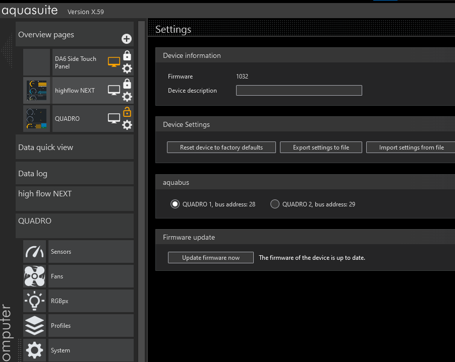

Quadro firmware is 1032, "up to date.."

the pumps are powered by molex or SATA. the quadro does not provide power to them so it can't read any power draw on the PWM ports.
L0wPull
Donnerstag, 19. Januar 2023, 09:07
Ah thanks, that makes sense of course. Silly question, on reflection, oops :)))
